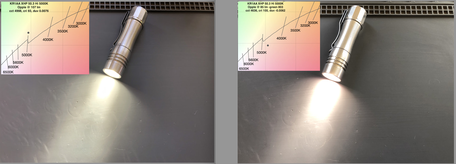

Recently started experimenting with an XHP50.3 Hi 5000K LED that started out at Opple 3 DUV 0.0076, which I perceived as slightly greener than I would prefer, even for use in daytime.. (pictured on left):
On right, I added a strong minus green Zircon 802 that reduces output 25%, but moved the Tint down to duv -0.0062, which to my eyes has almost no noticeable rosy tint (when Im not comparing it to something with greener tint)..
Im quite happy with it at that level, despite the lumen penalty.
it helps to hear your thoughts about low duv at different cct as Im debating 5000K but dont want it to be overly rosy
I have a 4200K NTG whose rosyness I barely notice, and find it pleasant, but hearing your comments, I may find similar rosyness at NTG 5000K closer to excessive.

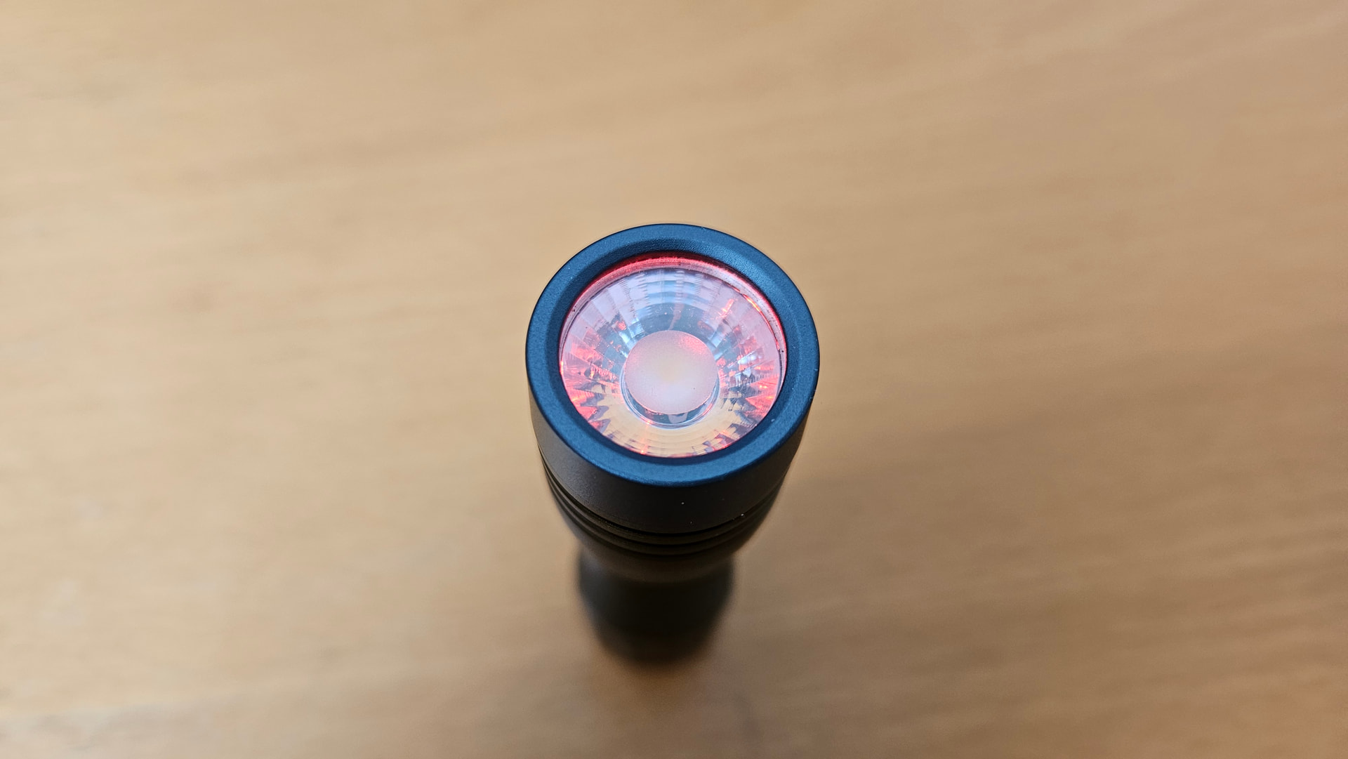

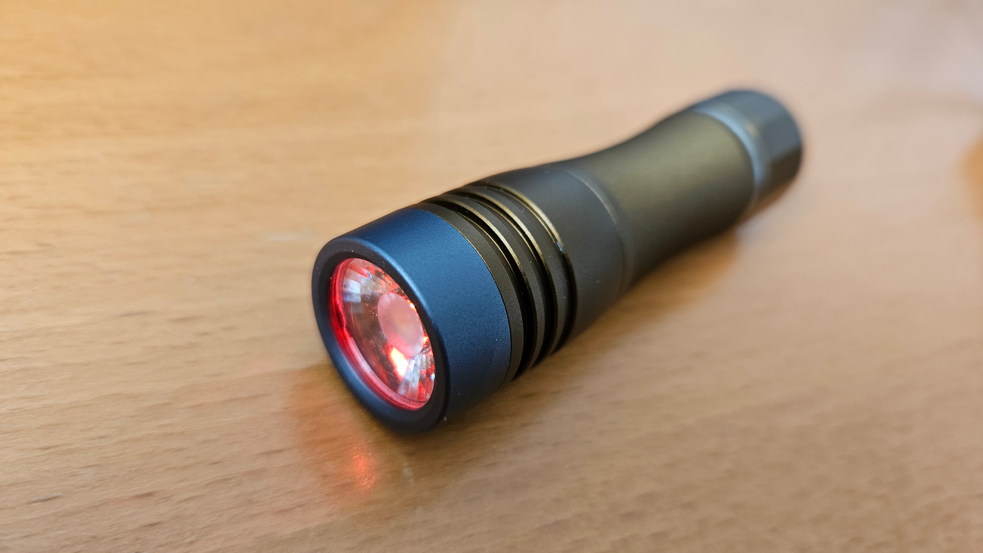

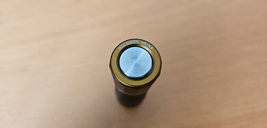

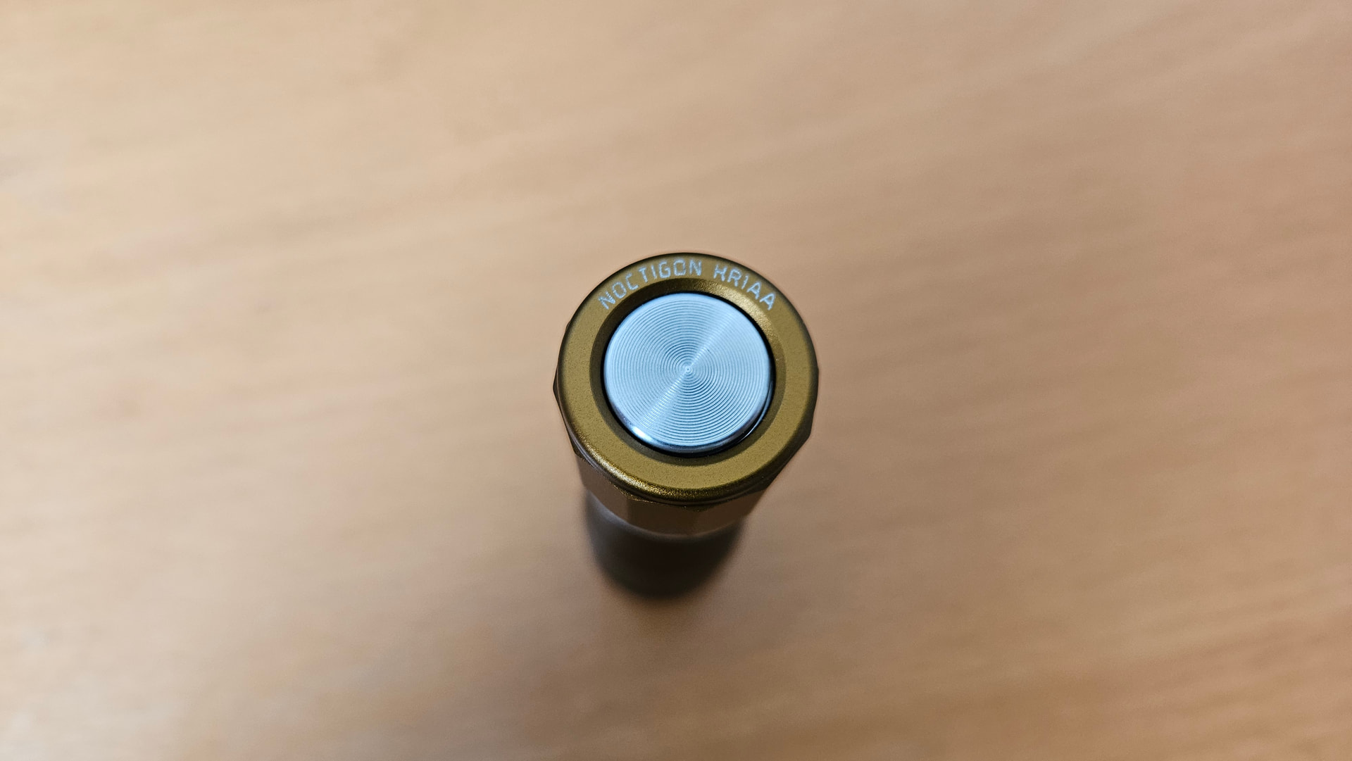

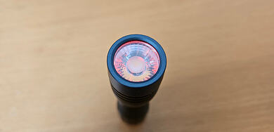

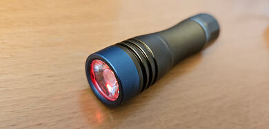

I got my KR1AA today (NTG50 5000k)
I had concern about the rosiness, however for my eyes it is perfect.
I love it already that creamy pearly white with a very nice beam transition between hotspot and spill.
Can’t wait to take it out for a walk tonight.
I order this custom color so it is like a burning cigar with grey bezel and red aux led.

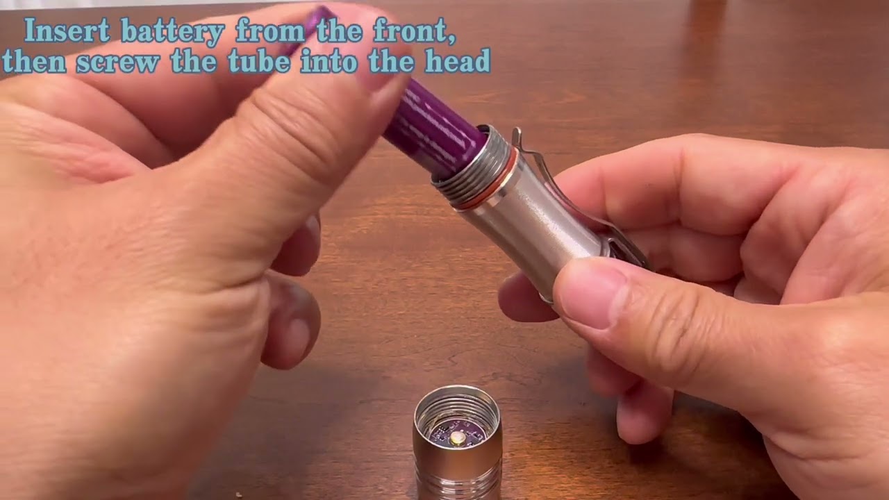

Polished Silver version head is not glued, please refer to the operation here
11 Thanks
Am I correct in understanding that the silver version’s head is not glued for one sole purpose—to tighten the back cover and secure the clamp, or are there any other design differences from the color models? Thank you!
