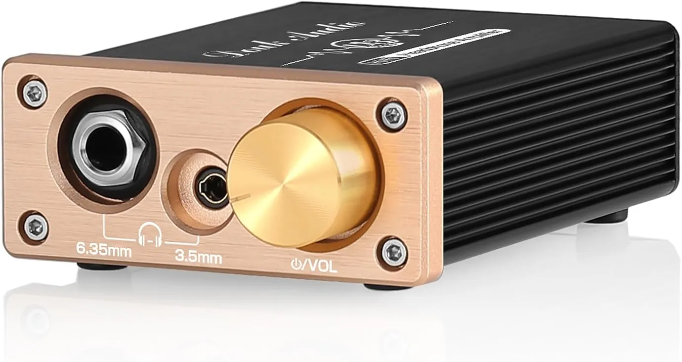

I have a headphone amplifier that’s pretty good most of the time, but when I watch media with loud scenes, the audio gets seriously distorted.
I need a more powerful amplifier (that doesn’t distort the audio), but the input needs to be either 3.5mm or RCA cables, so most (or all) DAC/amplifier combos will not work for my situation.
I ordered a Douk Audio U3 PRO.
https://www.amazon.com/dp/B0DBQC9KJY
This headphone amplifier is kinda pricey at $50-$55, but if it solves my problem, I think it’ll be worth the money. :musical_note:
There are adapters available to convert from 2.5/3.5/4.4/6 mm plugs to the required 3.5mm that you need (that go both ways). I use them all of the time.
There are also converters from any of the jack sizes to RCA. SO you will have more choices than if you limit them to just the3.5/RCA input types.
That being said, there are some very positive reviews on that Douk Audio U3 PRO unit. If the specifications are accurate it should have way more power than you need to drive headphones to ear splitting levels without distortion. If you still get distortion with this one, you need to look at the output of whatever you are driving it with.
You can overdrive the input causing distortion and it is not being caused by the amplifier, but the source.
Or the source can be at a high enough level that it distorts on peaks. Either way, turning down the source may be helpful.
It might be interesting to see what would happen if you turned down the output of your source to see what happened with some of the amps you already have.
