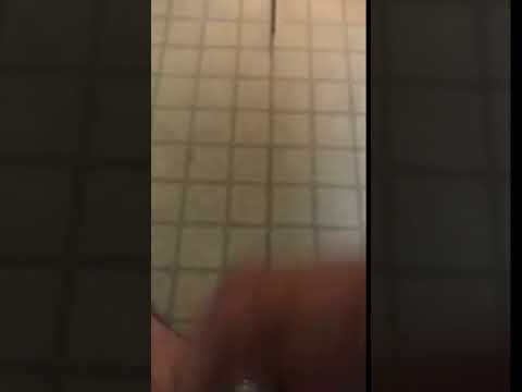

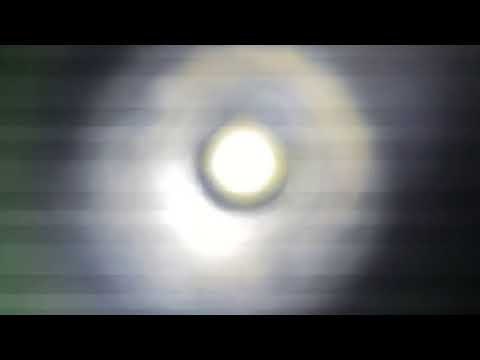

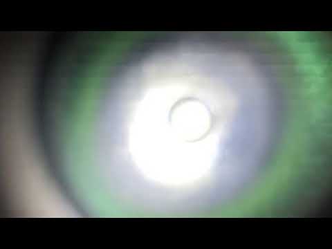

Novatac flickers, low battery, full battery, primary battery
Novatac flicker, visible with naked eye, and also on camera, on lowest mode, when 16340 battery goes below 3.6v
Novatac flicker on lowest mode, when 16340 battery is fully charged.
Not visible to naked eye, (unless waving the light), yes visible on camera, both still shot and video.
Novatac flicker on lowest mode, Visible to naked eye when waving, with full 16340 battery. Can be captured on Video and Still shot, with some difficulty.
this photo is one of the video frames:
Note this is Constant Current Flicker, not PWM.
