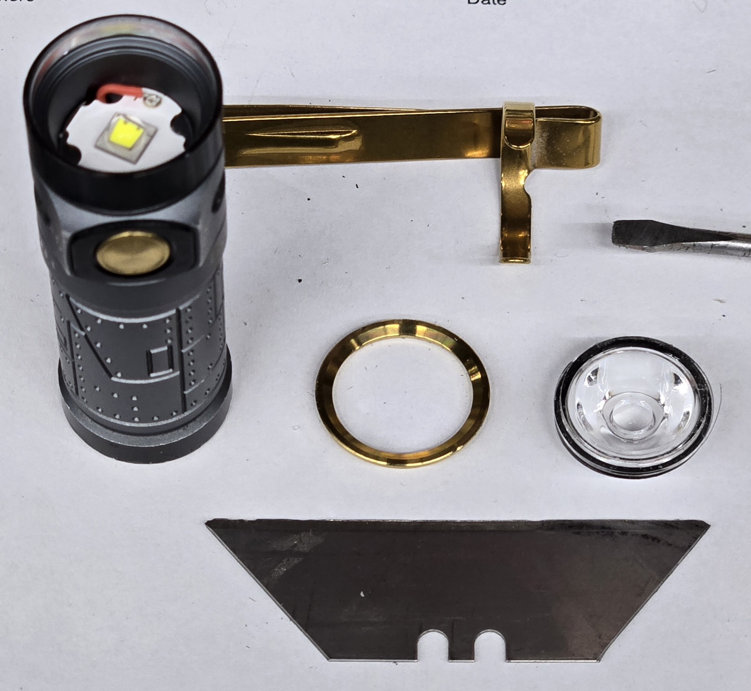

I clamped the utility blade in my vise, and rested the seam of the bezel on it, and tapped it with a small rubber mallet while rotating the head of the flashlight. Within about 2 minutes I had the bezel off.

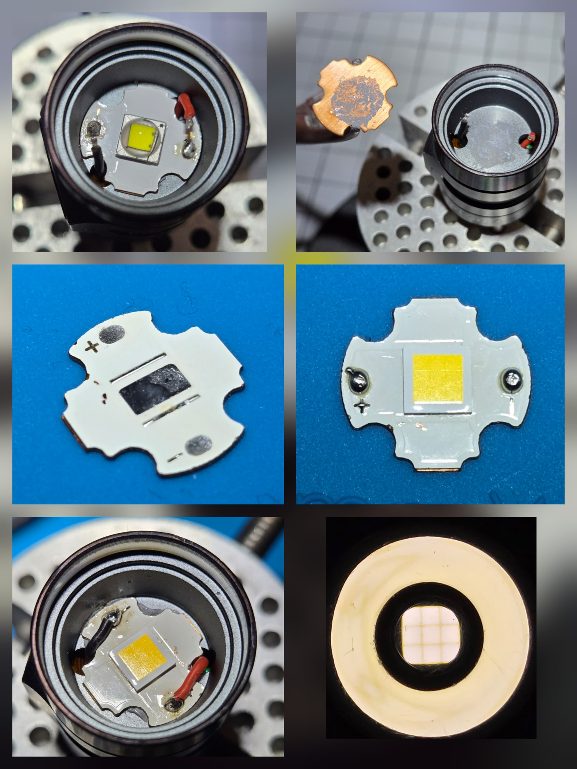

There was virtually zero thermal paste on the copper mcpcb.
Flowed the old emitter off and the new one on.
Added some Noctura NT-H1 thermal paste and buttoned it back up.
Altogether, I had about 40 minutes into the swap.
I’m happy with the way it came out.

So instead of placing the flashlight in the vise, you put the blade in the vise instead. I never thought of it before.
Thanks!
You know it’s funny. I hadn’t thought of putting the blade into the vise either. But I read it somewhere while researching doing this particular swap.
When I did my sofirn a couple days ago, it took forever while holding the blade in hand.
I will definitely be doing blade in vice from now on.

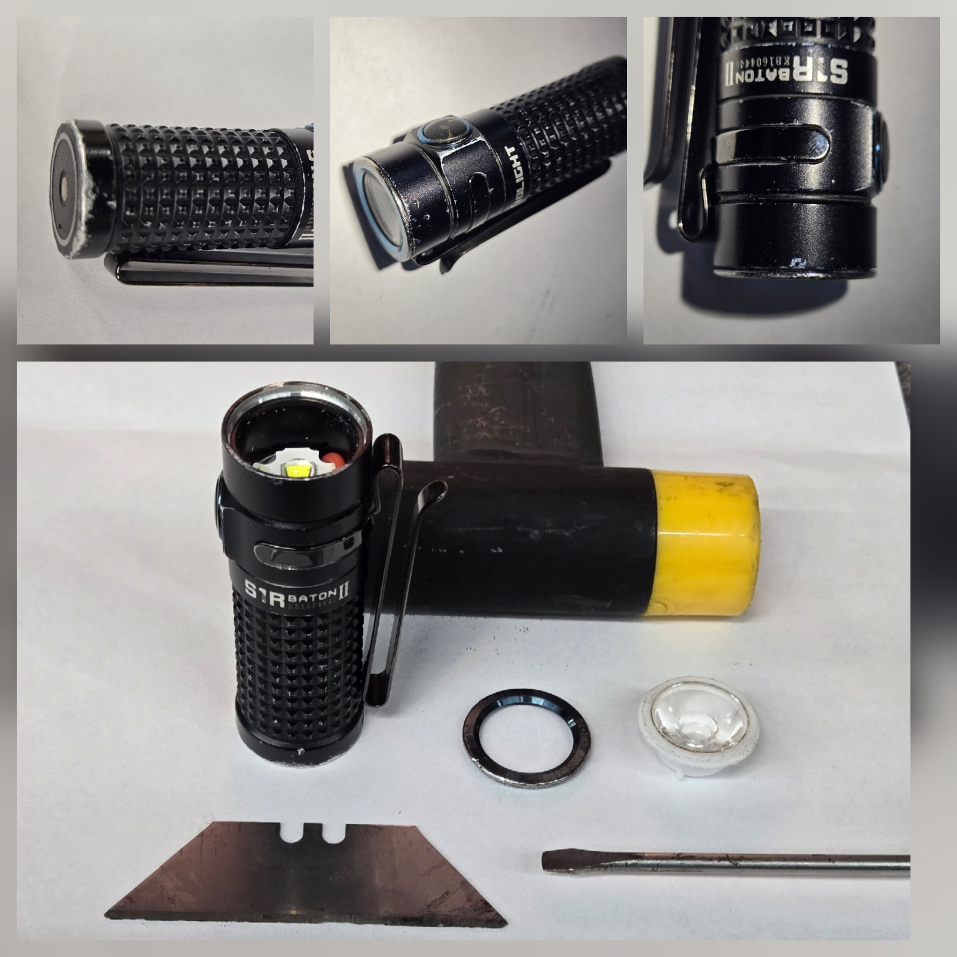

Since I can’t leave well enough alone, I decided to take apart my very old/worn S1R Baton II.
I carried/used/dropped it every single day for many years straight. It has never failed.
I’ve dropped it so many times, I’ve had to file the tail end a couple times so it would make contact with the charger.
Now to decide which emitter to put into it.
