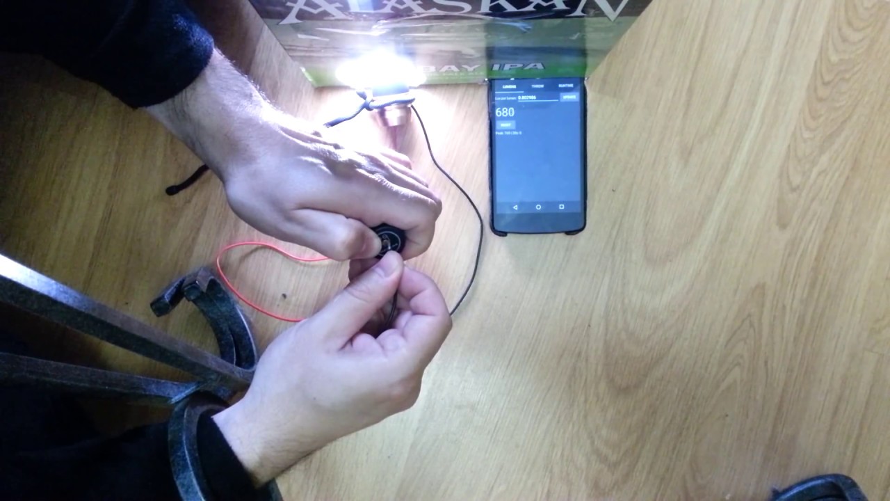

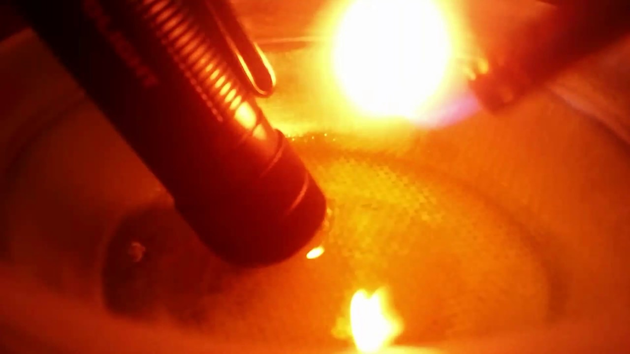

Also, electrolyzes salt water to hydrogen and oxygen:
Edit: and powers an Astrolux S41, making over 700 lumens:

After mhanlen’s video review, I pointed out the potential hazards, and he posted a short video demonstrating shorting the tailcap with no ill effects. At that point, I posted on reddit requesting a sample to evaluate. Illumn provided one.
I didn’t buy, or request review samples of the previous models because I knew that I would rate them as unacceptable for requiring a proprietary battery. They didn’t seem dangerous enough to merit requesting a sample just to evaluate whether they were dangerous. The H2R did. I’m eventually going to short it with a more substantial conductor on video, but I have a bit more testing to do before I do anything that might damage it, as I’m writing a full review. Spoiler: I’d rather have a Wizard Pro.

The charging contacts on the outside of the tailcap are connected directly to the battery - there’s no switching to enable them when the charger is connected and disable them at other times, or even a diode to prevent current from flowing out through the contacts. It’s especially dangerous with the battery that comes with the H2R because there’s either no over-current protection, or over-current protection that allows a very large amount of current before it trips.
