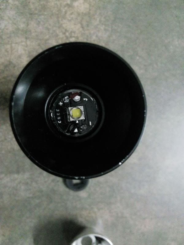

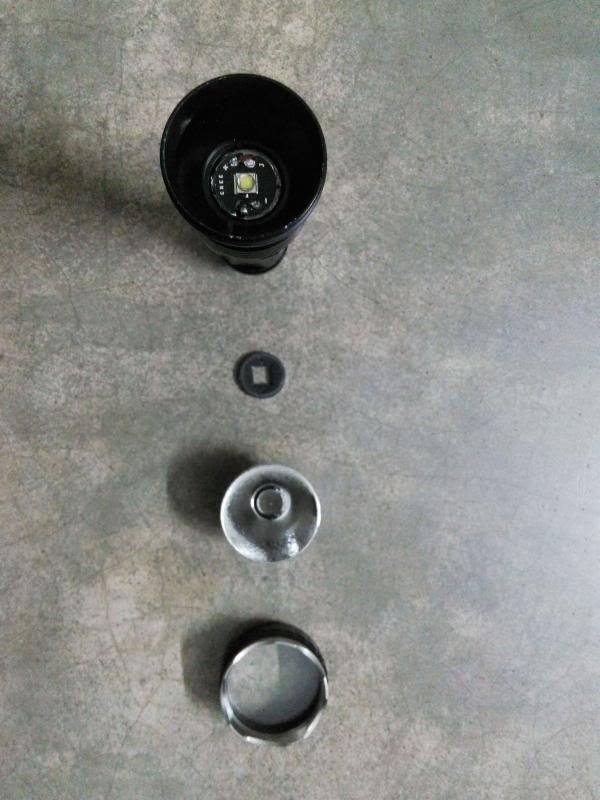

The head appears seamless, but with a large crecent wrench and twisting the head, it finally came loose. I took out the reflector and exposed the led.
Two small holes in it, I used my tool for that kind of thing and twisted slightly.
BIG MISTAKE. Broke one of the Led leads. It had nothing but white paste for heat transfer underneath while not being screwed on or anything. The paste and the reflector being pressed against it is what keeps it in place.
NOW, the wires feed through a hole into another segment of the head which must come off somehow. I see how, but have to honestly figure it out.

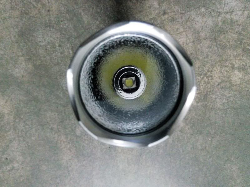

Follow this 5 easy steps
1. unscrew the ss bezel
2. remove the reflector
3. remove the black plastic with a pointed tweezer
4. de-solder the sst-50 led
5. solder a xm-l u2 led ( put some thermal paste )
