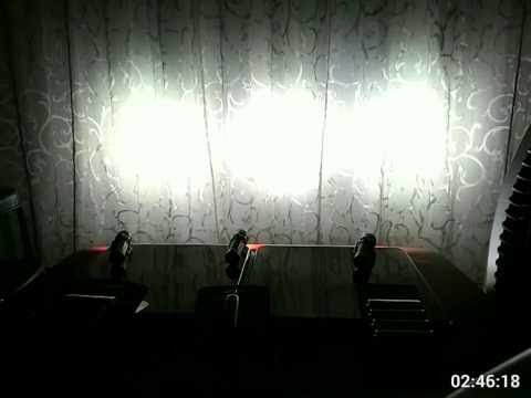

remember the Olight Lithium Iron Disulfide (LiFeS2) Primary battery that we put away for safe keeping? well, I just have to know if they are as good as our beloved Energizer Ultimate Lithium. So I went back to the Olight distributor and bought another 2 units of S1A to perform the following test.
This is my test setup.
from left, Energizer Ultimate Lithium, Olight Primary Lithium, IKEA Ladda 2450 NiMH LSD
The following video were captured using LapseIt Pro on a Asus Zenphone 5 with locked exposure. Again, it might be a good idea to turn down your speaker volume…
note the running number on the lower right corner is not the runtime, but the timestamp of the recording. and yes, we flashaholics need no sleep, that’s how we qualify to be one in the first place.
following are the recorded events, in order:
Olight Primary Lithium: 1.807V
Energizer Ultimate Lithium: 1.801V
IKEA Ladda 2450 NiMH LSD: 1.399V
Test starts at 01:26am03:00am (1 hour 34 minutes), NiMH starts to dim and flicker<br />03:04am (1 hour 38 minutes), Olight Primary Lithium starts to dim03:25am (1 hour 59 minutes), Energizer Ultimate Lithium starts to dim<br />03:57am (2 hour 31 minutes), Energizer Ultimate Lithium dimmed further, dimmer than Olight Primary Lithium
@04:01am (2 hour 35 minutes), Olight Lithium flashes once and turn off, follow by Energizer Ultimate Lithium half a minute later
