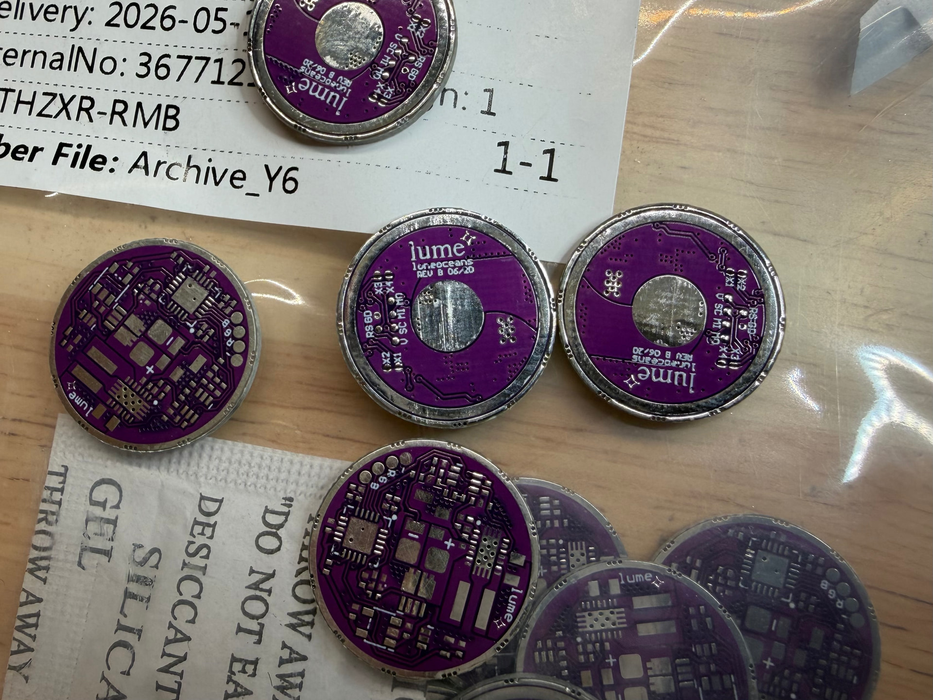

Lume1 for FW3A is an open buck-boost + FET, based on TPS63020:
Just got some boards from JLCPCB
Edit:
I hope don’t mess to much with the soldering
Hm it has the Open Hardware Logo!
BOM and Gerber is online but for some reason no schematics?!
And only for the Fet driver version?
