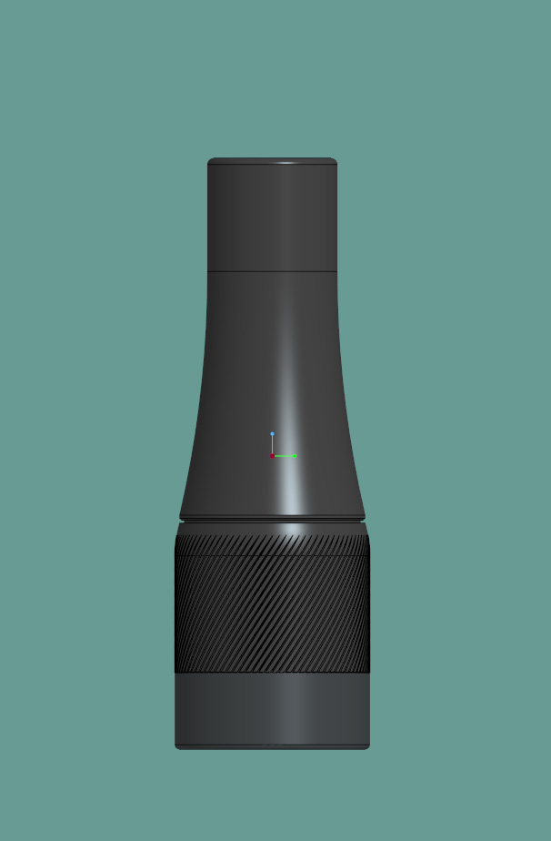

How about making appropriate modifications to the battery tube based on the T5 flashlight.

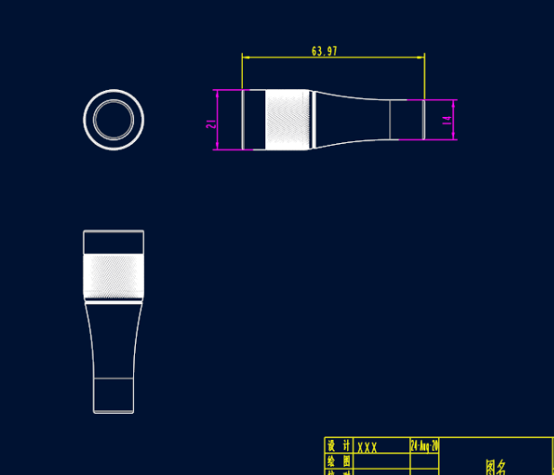

The head of this flashlight may look a little too big for an AAA flashlight
T5 head diameter 21mm,
That’s too large. Smaller AAA is preferable. The typical head diameter in my AAA collection is between 12.05mm - 17mm. A larger head on an AA T5 would be very interesting though.

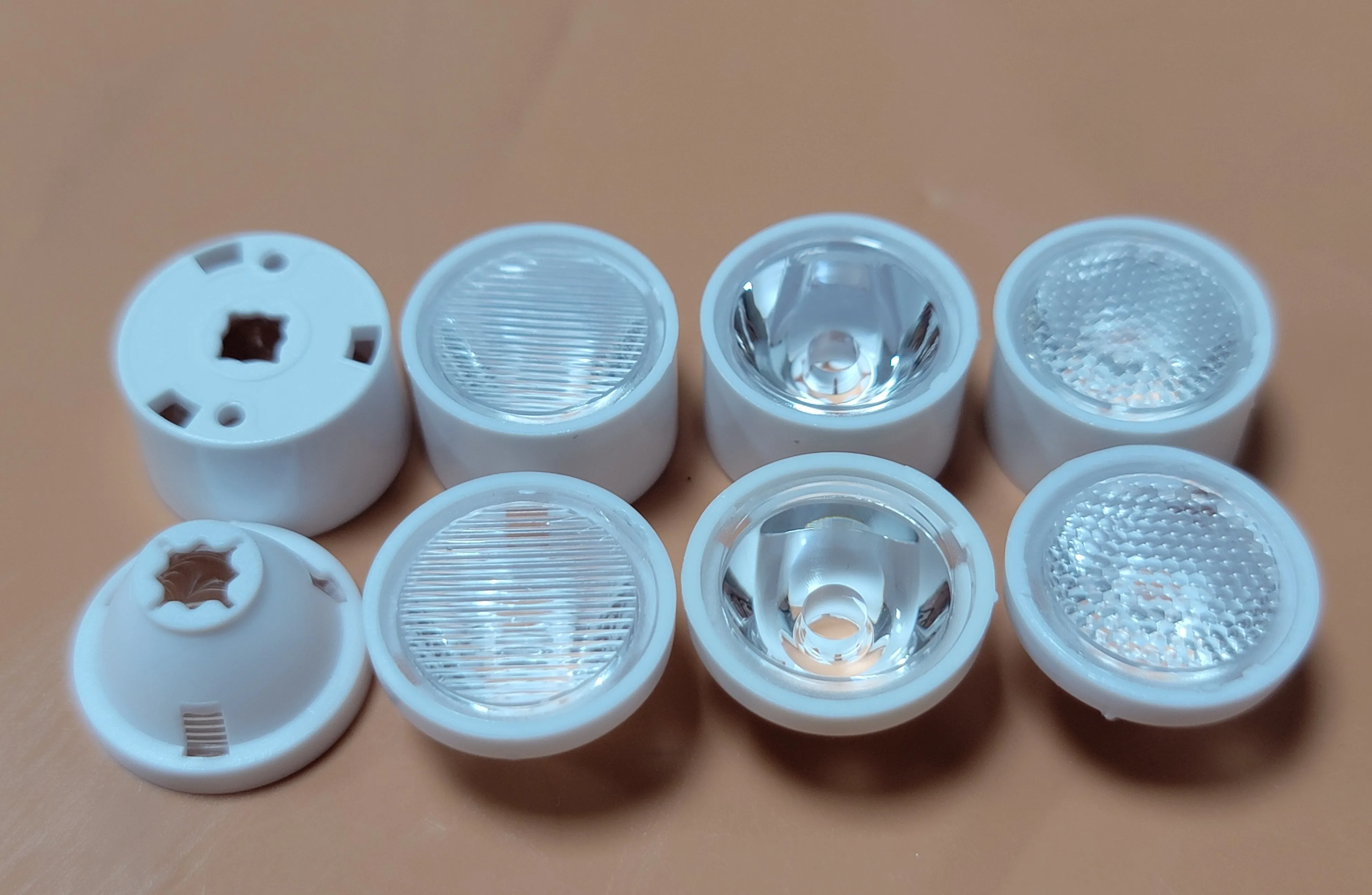

These might work in a larger AAA light. Same sized lens is used by Lumintop in their EDC15 (18mm thick 14500 light), but mit might be possible to squeeze them into a 17mm head.
Alternatively, a small 14500 twisty light with the looks of the T3/T5 but thinner (18mm like EDC15) would be fun, too.
EDC15 next to a 18350 S2+, I am not the biggest fan about the shape of the light, but the size is awesome for a 14500, and those Yajiamei TIRs are awesome for their small size.

I like the looks, but the 21mm head is a bit wide for a AAA for my taste.
If the light is a mule, then there is no advantage in making the head wider than the body, but maybe the problem is that the driver is too big. With a smaller driver and no reflector/optic, perhaps the head of the light can be made very narrow, perhaps as narrow as the battery tube.
