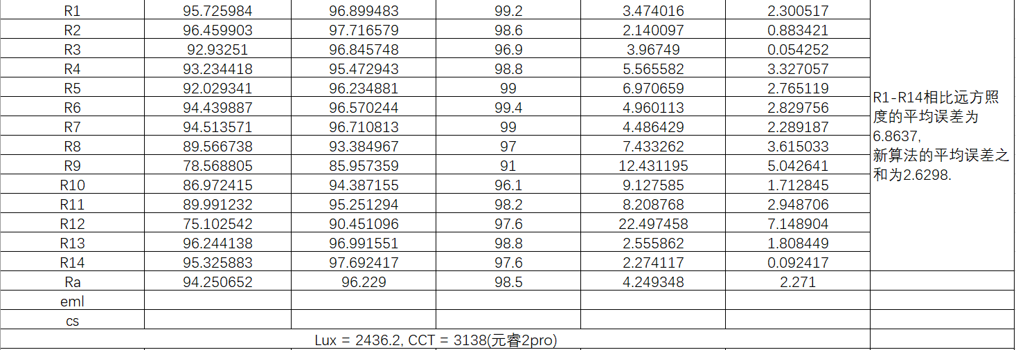

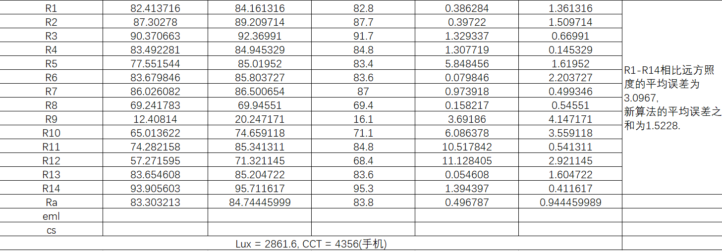

did some simple testing just now, new algorithm and calibration method seems promising, but I still use desk lamp for testing here.

app team has their schedule, they will incorporate it in July 30th version.
I pretty much want to share calibration method and algorithm with you guys(I am actually a software guy, I knew nothing about light metrics before, I learned recently by myself, hence I need you guys to help me), but I need to consult with my leader to make him consent.
thank you for helping to create communication between the Users, and the Designers ![]()
From my User perspective, I use the Opple 3 as a reference and compare it to the Opple 4… It would be good if they produced similar results, from any given light being tested.
Even better would be to use a more expensive meter as a reference for example a Sekonic, and try to get the Opple 4 to produce similar results for the things it registers, CRI Ra, Tint Duv, CRI R9.
I would also be really good if the CIE spectrum chart on Opple 4 would work. Right now it is just a static image that does not update with new light sources. It does work in the Opple 3.
I’ve given app team your CIE spectrum chart feedback. They will fix it.
This has to be done for all CCTs, all Ra / tints and other types of lighting as well. This is important to avoid any deviations if a light source with other CCTs or tint is measured.
I think it will be important to test all sorts of lights ranging from incandescents to high and low CCT/CRI leds, as well as fluorescents and HIDs (not very common but still exist).
I would volunteer to help out with development as I’ve got a pretty comprehensive light collection, but sadly I don’t have access to a Sekonic or similar meter.
It’d take a lot of effort. I personally want to expand support of more light sources and different CCTs, all Ra/tints. I even want to incorporate measurement of daylight. but resources and support is inadequate here.
