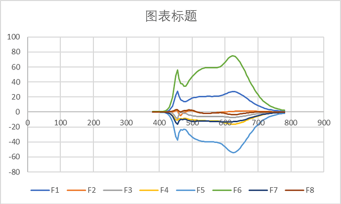

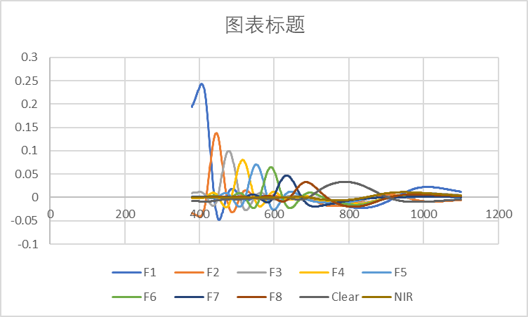

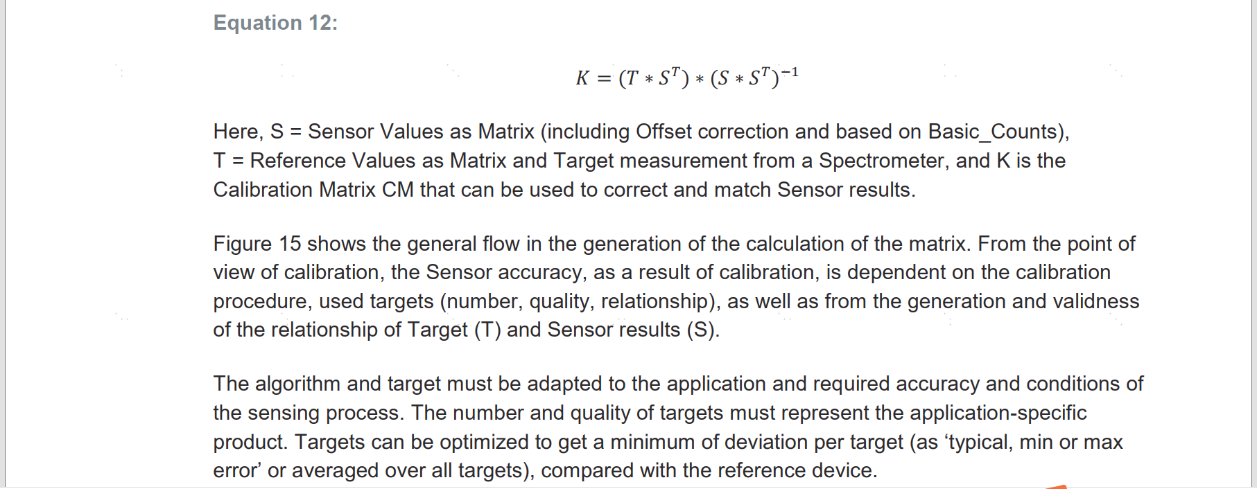

plus, I want to open source it. I tried, I talked with my supervisor/leader, he said it’s a company level thing, and considering we’ve signed some NDA documents with third parties, it’s really out of my capacity. I personally think the revenue is generated by selling the real object(LM4), no need to hide the details, but it’s own my personal view on this problem. by the way, ams osram also didn’t disclose their algorithm, the algorithm they specified in the documentation as below is outdated(ams osram Shanghai staff told me in front of me), and you can verify it by yourself, it didn’t generalize at all.

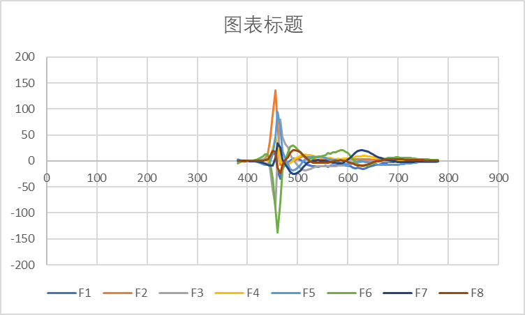

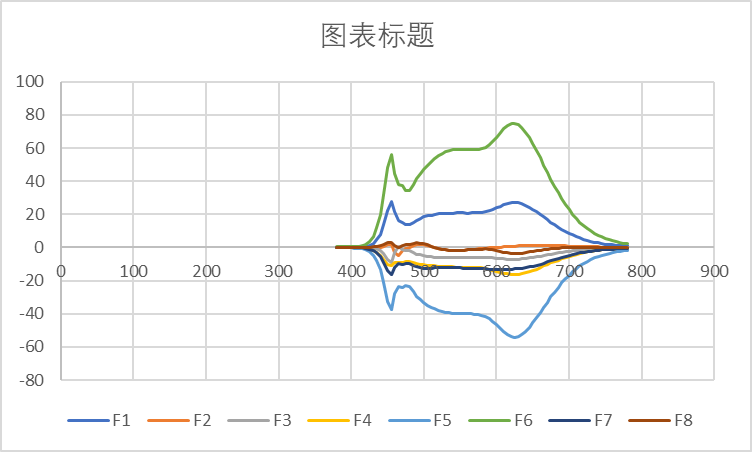

if you follow the algorithm, you will generate result as below(I will draw a graph, actually it’s a matrix):
not like the graph as below which I think it demonstrates some sense of beauty:
