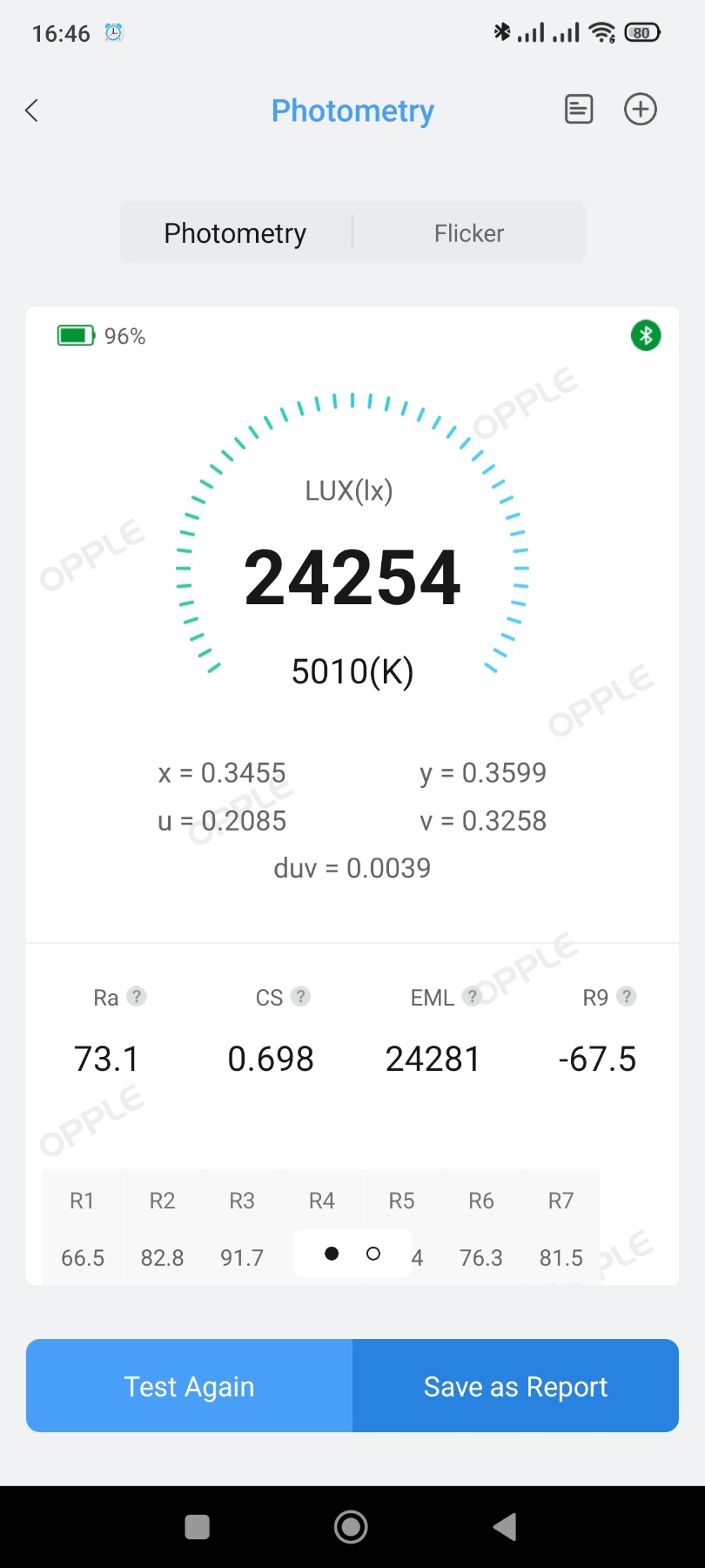

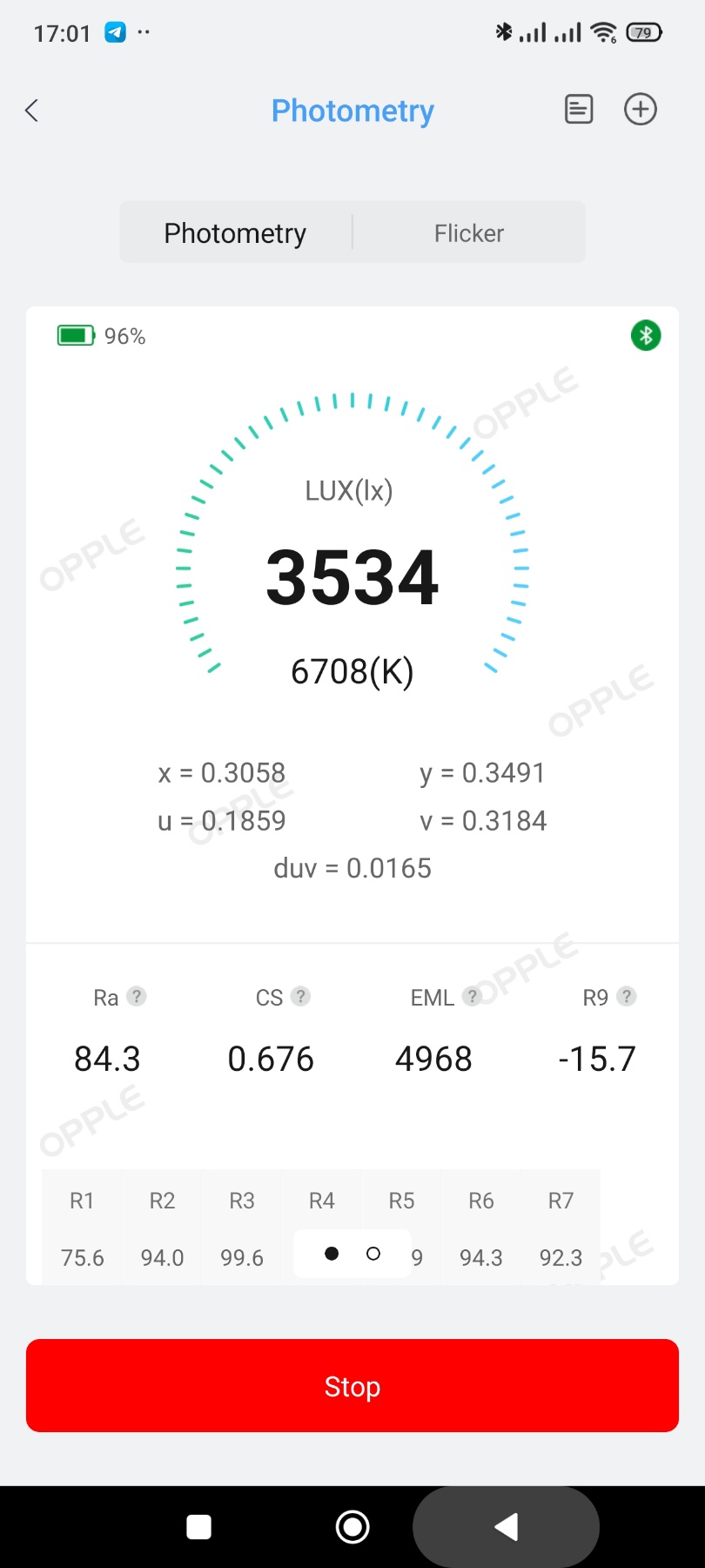

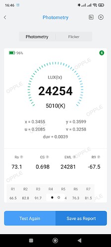

Does anybody knows what happened with Android application v3.8.4, it shows either negative value for R9 or all values (Ra, CS,EML,R9) are not measured at all (seems because too big negative R9 value) while LED measurements (i do measurements LED bulbs)?
some issues with sunlight as well, while the measurements outdoor ok, then i put device in front of window i get this:
it’s completely unreliable now. Do you know is it possible to rollback some how app version?

why not use windows app as a temporary replacement?
I think current Android/iOS results are not reliable.
Do you mind Steve to send me the link for the last windows version? The mobile app is more convininent but if windows will provide better result, then will be no other choice. Thanks
I uploaded previously, this version’s graph maybe wrongly positioned but the results are reliable.

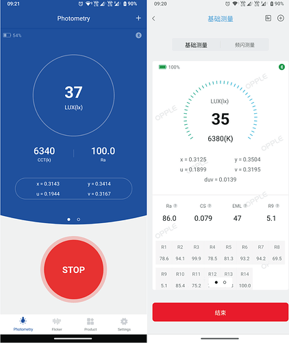

I have a problem with my Opple Light Master 4. It does not measure CRI when light is brighter than about 200 lux. I cannot measure direct sunlight CRI or other things. Does anyone have the same issue, or know how to fi it?
don’t use android/iOS apps, use windows program as a temporary alternative.

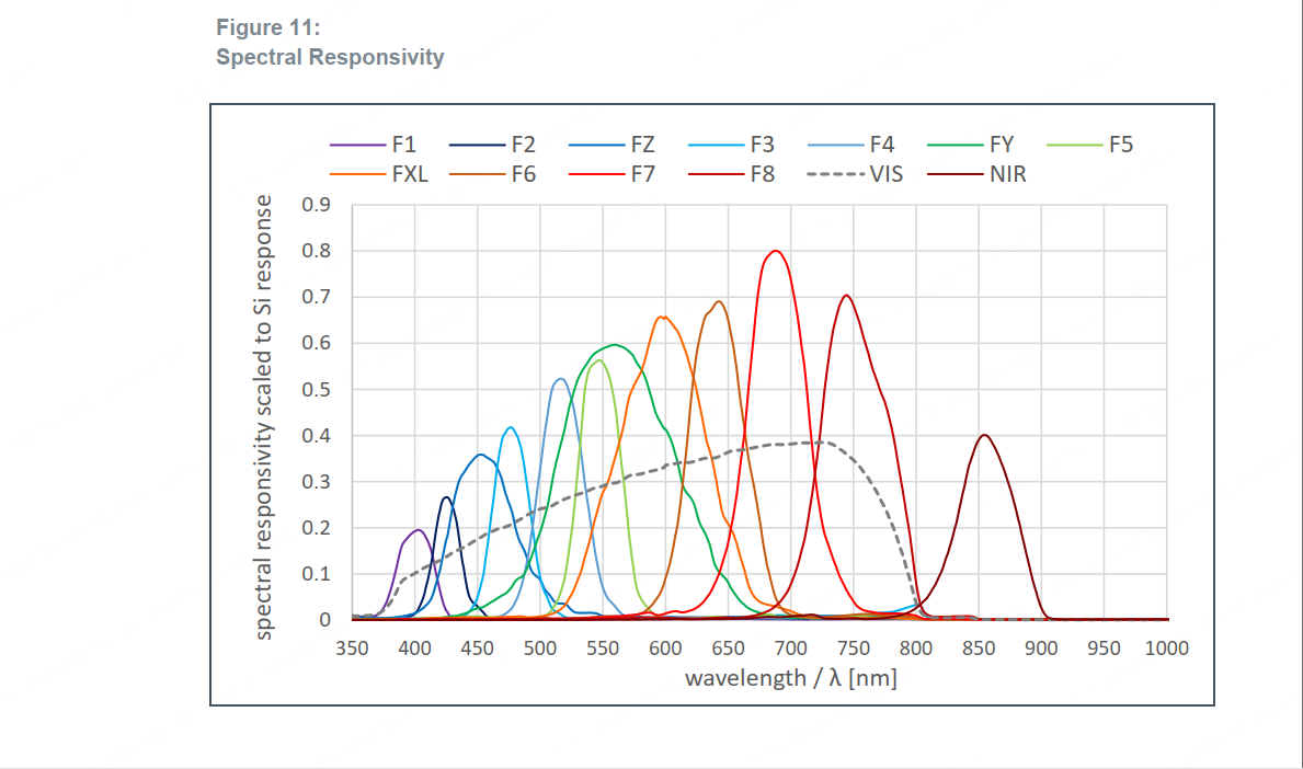

  • the AS7341 - while not great, it did an OK job for what it is. I found out, for example, fireflies sent me a 70CRI E21A NOV-Mu instead of CRI9080. It was useful enough to get that all resolved. Is it accurate / precise? No, it can’t really be given it’s nature, but the LM3 app showed it can be useful in some cases. I am very close to getting the data read into a new Android app like ceiling bounce but much more expanded. You don’t need LM3 / LM4, just a $15 board from adafruit
  • i have been in commmunication with adafruit to update the above mentioned AS7341 breakout to AS7343, but have nothing more to share at the moment. While better than the AS7341, this device is also limited, so we should not have great expectations.

as7343 not necessarily brings better results for metrics like CRI. seems it embedded XYZ calibration result inside their chip or the chip just outputs XYZ directly(no matrix operation).
