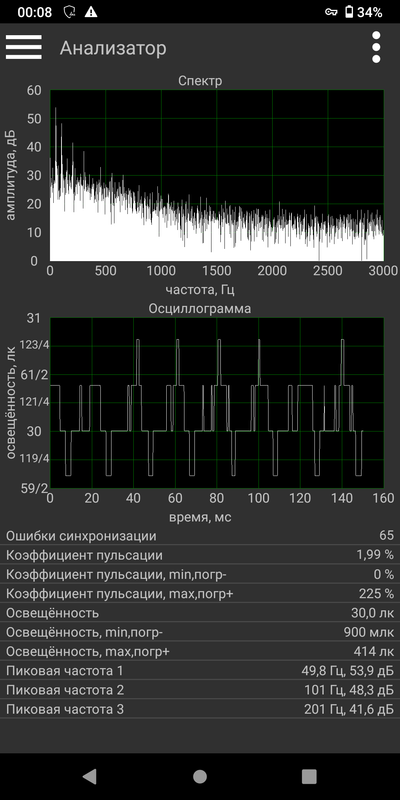

I reinstalled old version Intel driver from 2015, now I get this reported by radex, no more 20/30hz nonsense.
There is still some temporal dithering confirmed with high speed camera.

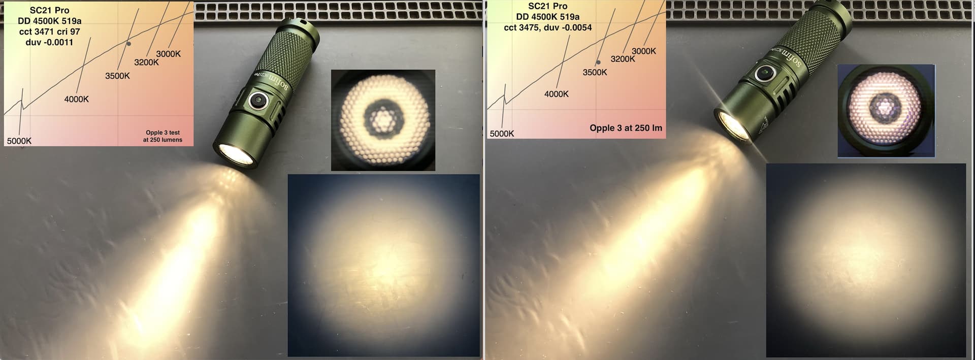

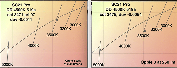

For example, here are two DeDomed 4500K 519a. The came from the same batch, bin, and reel, infact they were side by side in the tape. Both LEDs measured on the same LM3, at the same Lumens:
There is a difference of -0.0043, between the two LED samples. Irrespective of the actual calibration error of the LM3.
Individual LED variation can be pretty significant, totally independent from whether the LM3 is actually calibrated to the same zero as a more accurate meter. There are also variations in DUV at different Lumen levels
Point being, accuracy expectations can be unrealistic, when comparing tests of different individual LED samples…
There is so much variation between individual LEDs, that even with totally accurate meters, any DUV test I report from an LED of mine, is guaranteed to be different than an LED of yours.
Despite all those sources of variation, an LM3 or LM4 can be a handy tool for comparing our own LEDs to each other.

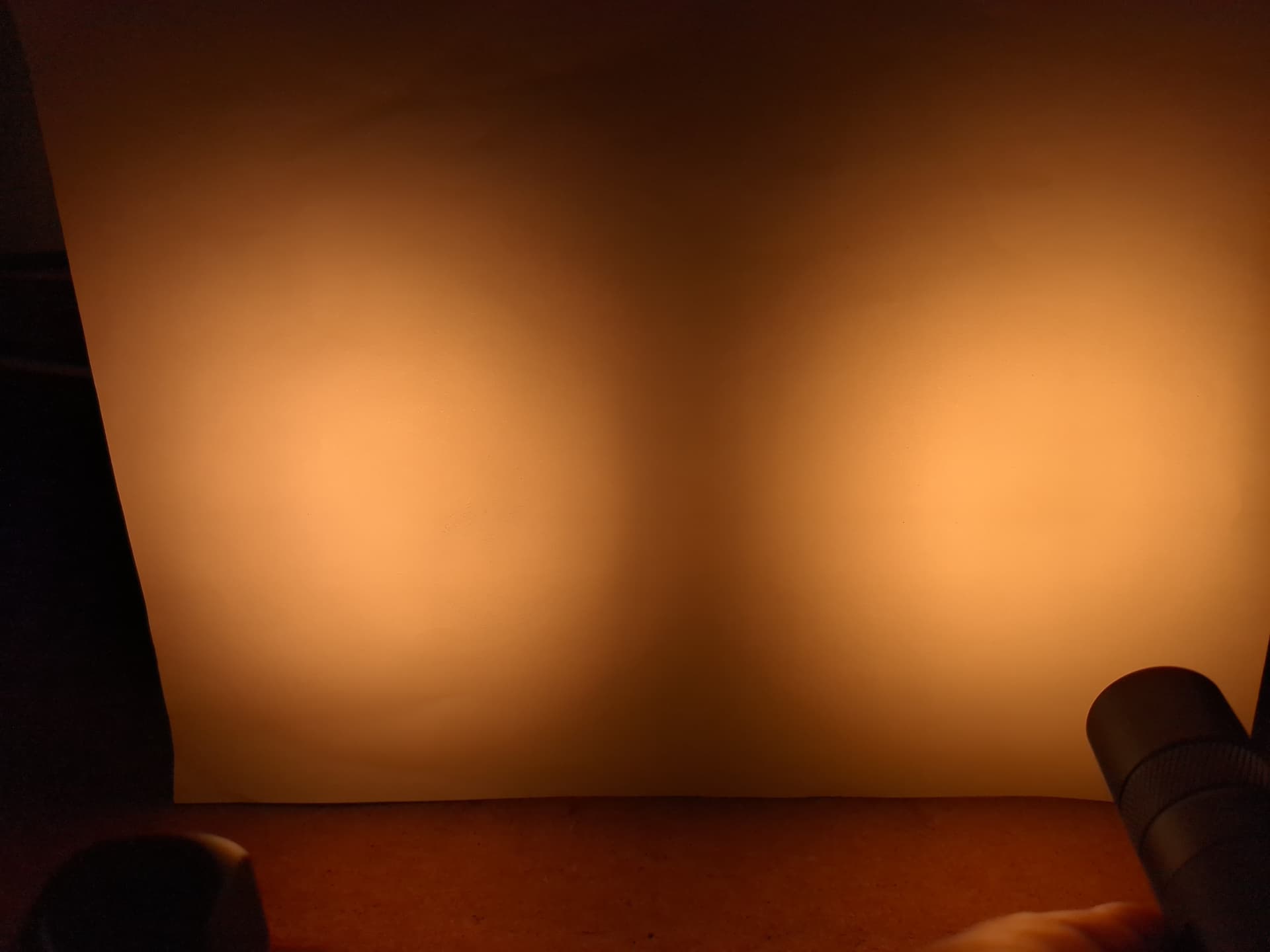

Phone camera cant see difference too. WB daylight. By the look 3500K kind off brighter… Both leds from Simon. Dont know that to blame now. Opple ,Simon or Nichia . :slightly_smiling_face:
Look pretty similar, so the Opple might be right…
Waiting for post from Simon with another 3pcs Nichia 3500K. Will compare it latter.
Naahh, compared with house ligts bulp recognized as 3000K. Nichia 3500K looks a little bit colder. I quess Opple sucks and phone too.
Hmm… phone picture is not good for evaluating any single LED, but does show difference between 2 LEDs very well as long as the 2 LEDs are in the same picture (so they have identical wb settings). I think your Opple might be working. Best of luck.

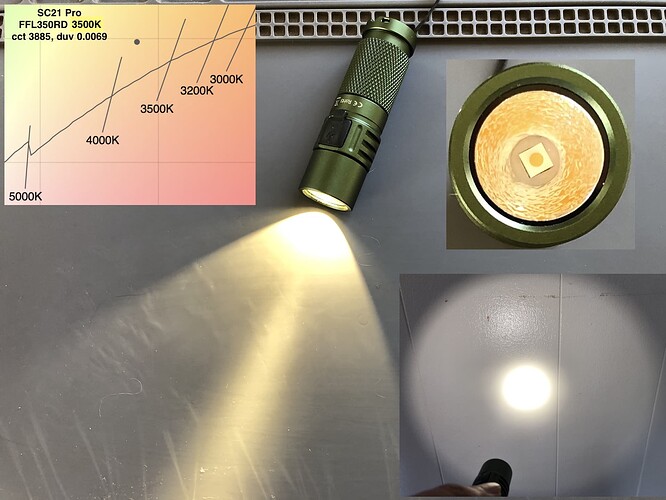

LEDs are not exactly all the same as their Nominal CCT, and Opple is not a calibrated science grade tool.

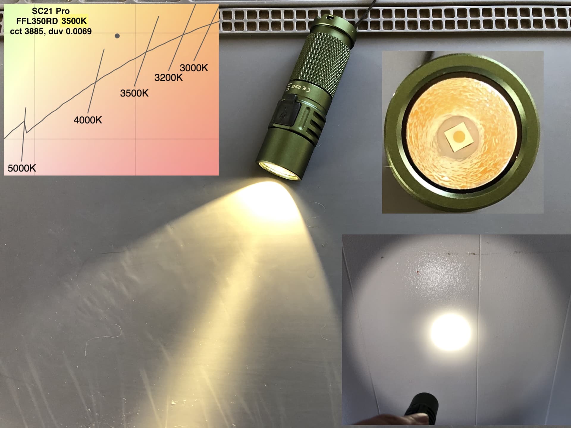

here is a “3500K” that Opple thinks is 3885K:

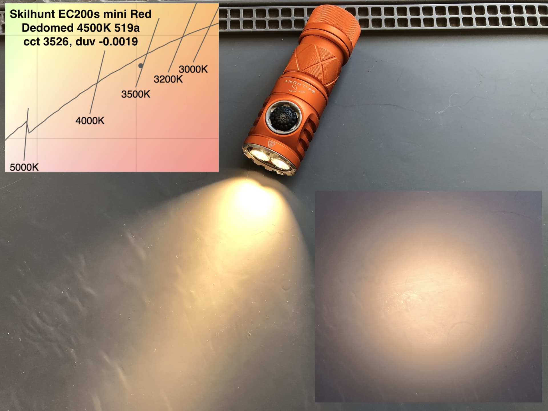

otoh, here is a DD 4500K 519a, that is actually hitting very close to 3500K (3526K):
dont expect any LED to be exactly the CCT it is binned with. LEDs are like chocolate chip cookies, there is no guarantee they all have the same number of chocolate chips :wink:
Even if you and I both test a 3500K LED with a calibrated science grade spectrophotometer, each LED will produce a different result. The only way you and I could get identical results, would be to test the actual same LED, using the same calibrated instrument.

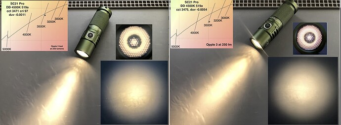

Here are two DD 4500K, and though their CCT tested on Opple 3 is very similar, their Tint DUV is quite different:
the Opple cct and duv tests will also produce different values at different outputs…
dont expect exact accuracy from any two LEDs… regardless how expensive and well calibrated the spectrophotometer is
Opple is just a way to compare your own LEDs to each other. It provides relative info, not precise repeatable values that would apply to every LED
