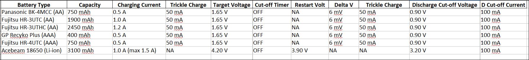

Thanks Mandrake50 for your reply. I’ve drafted the following charging/discharging/break-in settings based on the manufacturer’s datasheets and SkyRC documentation.
Could anyone please review and advise if these are safe and optimized? I’m especially worried about setting incorrect termination thresholds like delta V, discharge cutoffs, or trickle charge—which could potentially fail to terminate properly and lead to swelling or reduced lifespan.
Honestly I have just used the default Delta V settings on the MC3000 for NiMH cells for something like 15 years… because they seem to work fine. If you are having problems with a particular type of cell not terminating, you can experiment. I have seen 5-8 mv listed as acceptable.
For your discharge cutoff voltage for LiIon cells, I usually go to 2.8V. This is not damaging to cells and will typically give capacity numbers closer to those in the specs. I have gone lower if this is what is listed in the Data sheets or the test specs. OTH, I see most of the BMS in my lights cutting off closer to ~3V. So that gives a better idea of real world performance. I think that 3.2 V is a little high.
Thanks! That really helps simplify things for me.
Just to make sure I’ve understood you correctly, my plan now is to:
  1. For NiMH: Just use the default “Eneloop” profile on the charger. It’s good to know the defaults have worked well for you for so long.
  2. For Li-ion: Use the standard settings but adjust the discharge cutoff voltage to 2.8V when I’m doing capacity tests to get numbers closer to the manufacturer’s specs.
I really appreciate you sharing your experience. This is exactly the kind of real-world guidance I was looking for.
Thanks again!
Sounds good to me. On the cutoff voltage, If you want to get real tight on that, find the data sheet on your cell and use the manufacturers listed cutoff. But I generally go with the 2.8 and use that for the setting on my saved capacity testing program.
