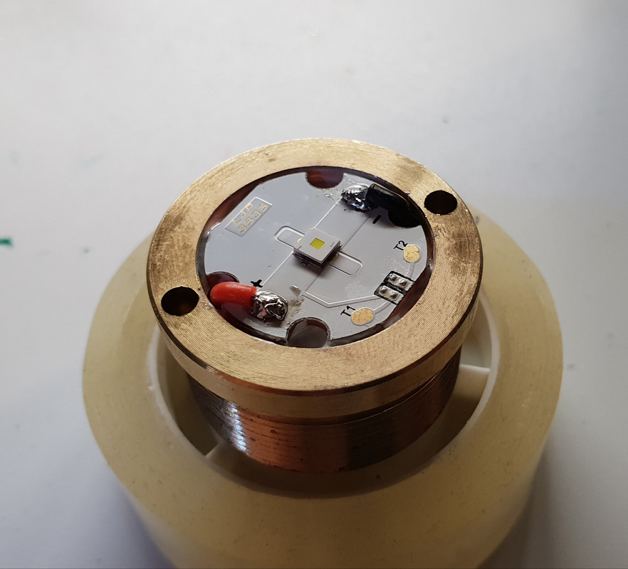

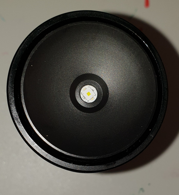

Okay, I don’t have any numbers but here is my herd of throwers anyway :
From left to right :
- Olight M3XS Black Flat
- Cometa “White Flat”
- Amutorch JM70 XP-L HI (tried a “White Flat” in there, but the TA FET driver on Turbo made it turn Blue/Purple… back to normal though after stepdown)
- Emisar D1S Black Flat
- Emsiar D1 Black Flat
- Olight R20 “White Flat”
Now the beamshots, in the same order :
My impressions ? Well the Emisar are perfect for Black Flat because the head is insulated from ground, as well as the M3XS…
For the others, the “White Flat” is perfect !
Now the most impressive IMHO are the Cometa which turns into a white laser with this LED :-p and the R20 which really throws a strong beam with its tiny reflector… Oh and the beam is really clean, without artifacts.
