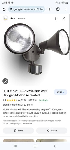

I have outdoor lights as the ones in the picture. The halogen light bulbs are getting harder and harder to find.
Is there a replacement LED light fixture I can get that is:
#1 Very powerful
#2 Has a dusk to dawn feature
Also in mine, the sensor burns out every two years. Home Depot has replacements but its a huge hassle.
Home Depot has replacement light fixtures but I want something good that will last and be maintenance free.
Thanks in advance

Possibly water related damage, they are outside 24x7.

As an electrician I’m gonna say if the photocell is only lasting 2 years you are replacing them with some really cheap junk or there is water leakage. I’d bet its water leaking around the cover gasket or the box mounting. A new fixture isn’t gonna last getting water in it.
I have installed 1000s of those dang things, even around my own place. I burn LED bulbs in them. I’ve never seen anything new that I would swap mine out with. I’m not a fan of any light fixture with built in LED lights. The fixture will always outlive the LEDs. A LED bulb is just about always cheaper than a quality led fixture. Just make sure it’s not some oddball LED bulb. I’ve seen some of them where you can’t find the correct bulb and/or by the time you do it’s almost cheaper just to replace the whole fixture again.
Stay away from big box stores if you want quality. They do sell some good stuff but you really have to know what you are looking at to tell. That requires having installed the cheap stuff and the good stuff to compare. I’d suggest looking for an electrical supply house locally and see what they have. You don’t have to buy their most expensive thing but even their lower end stuff is often way better than what lowes or home depot has.
