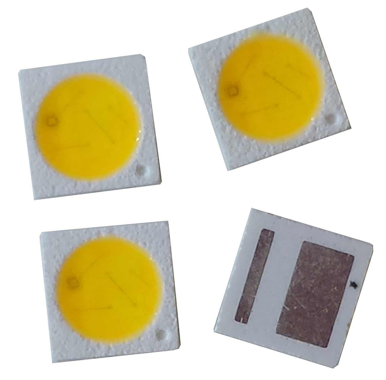

Is the footprint for this emitter the same as some pre-exsisting led?
The footprint as far as I know is pretty standard for 3030 midpower leds. But those are never before used in flashlights so for us it is very uncommon. (in the picture are for example Osram Duris leds).
The footprint is the standard Nichia 757 or 3030 led footprint that is industry standard
Cheers
