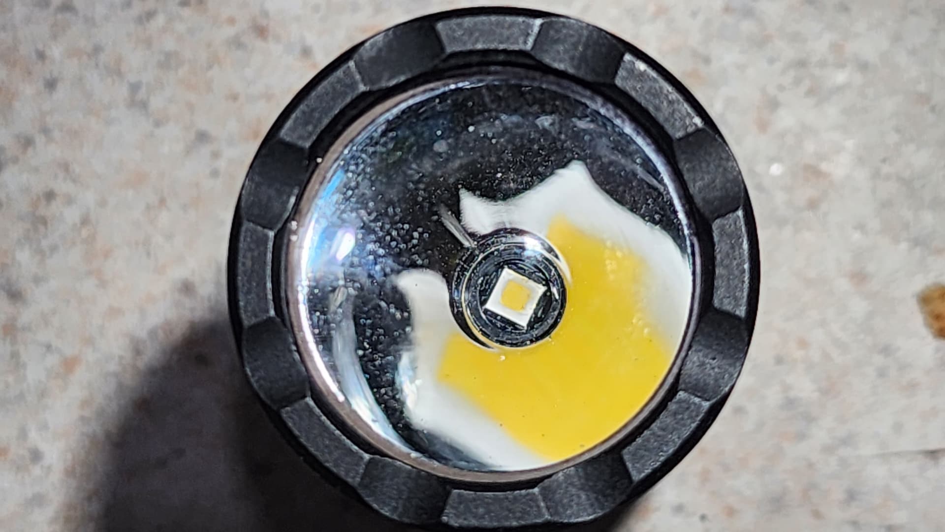

Has anybody attempted to do an emitter swap or any mods to the OWL lights? I have one a friend asked me if I could make a bit brighter. Was hoping to swap the cree emitter with an SFT40, but the light appears to be press fit and potted. Wondering if it is even possible to disassemble?

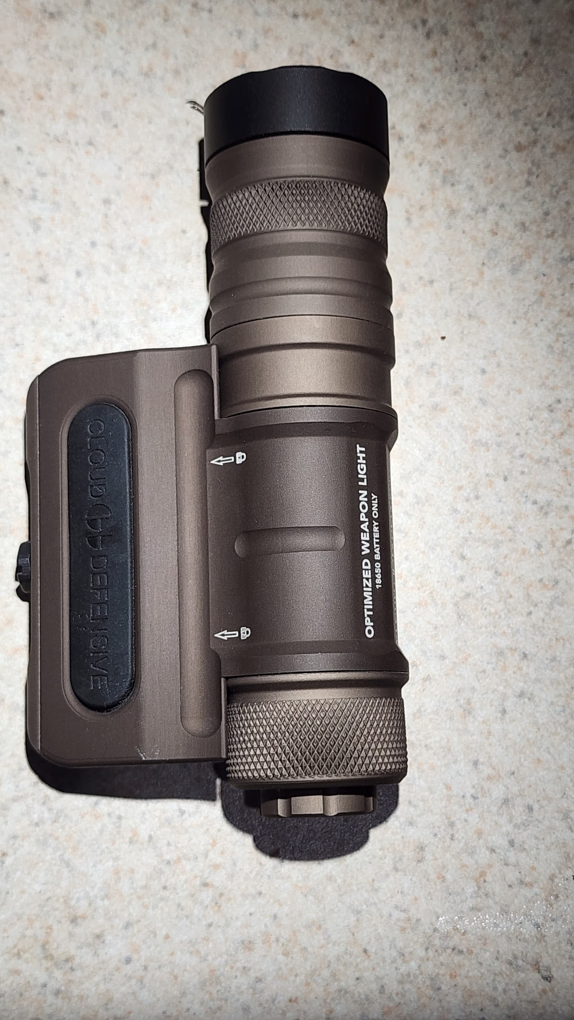

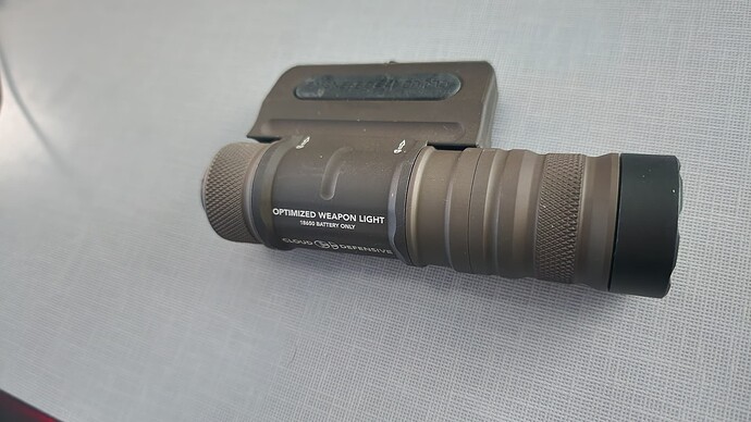

Are you talking about this light.
Yes. This guy is the light in question

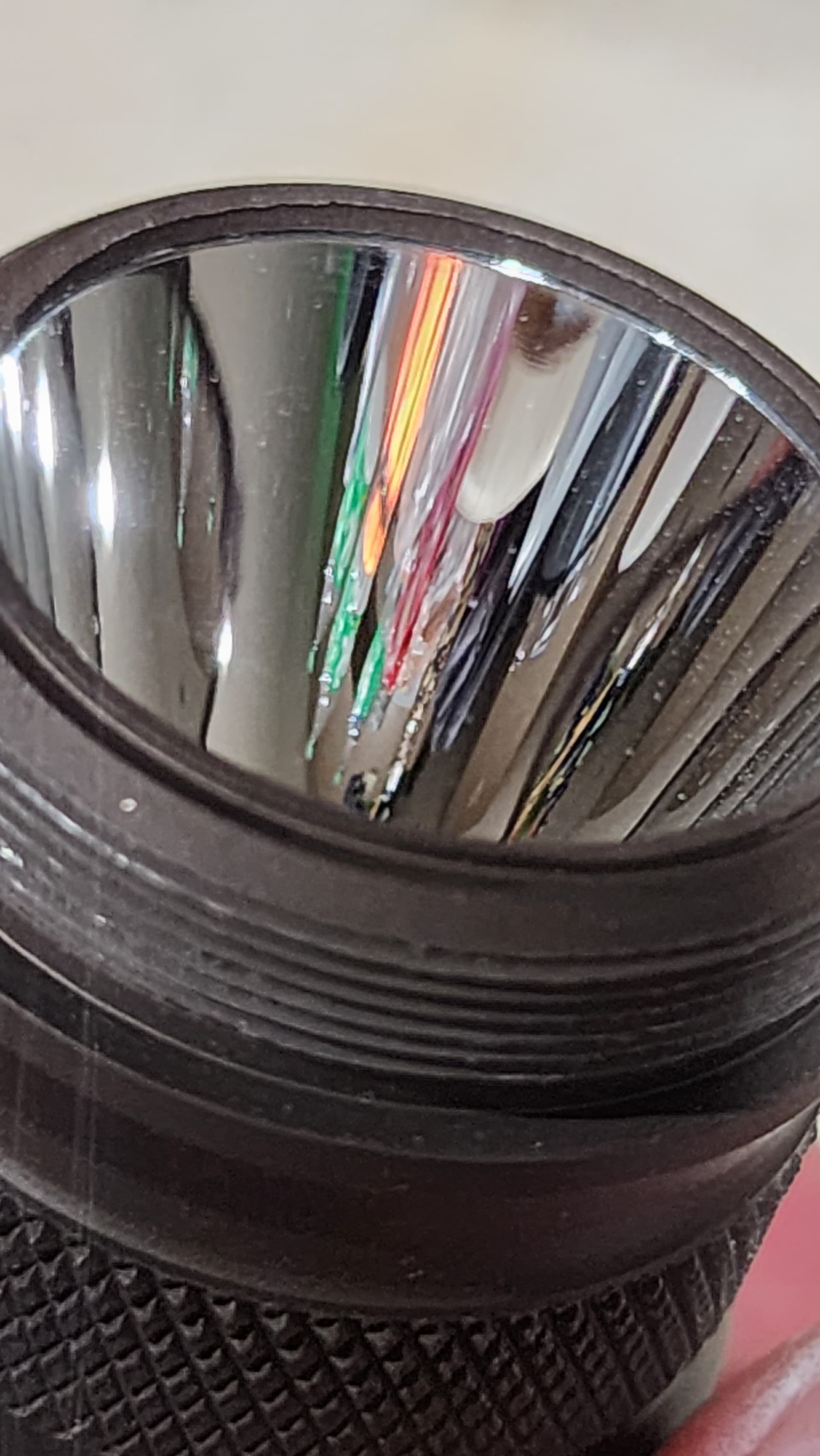

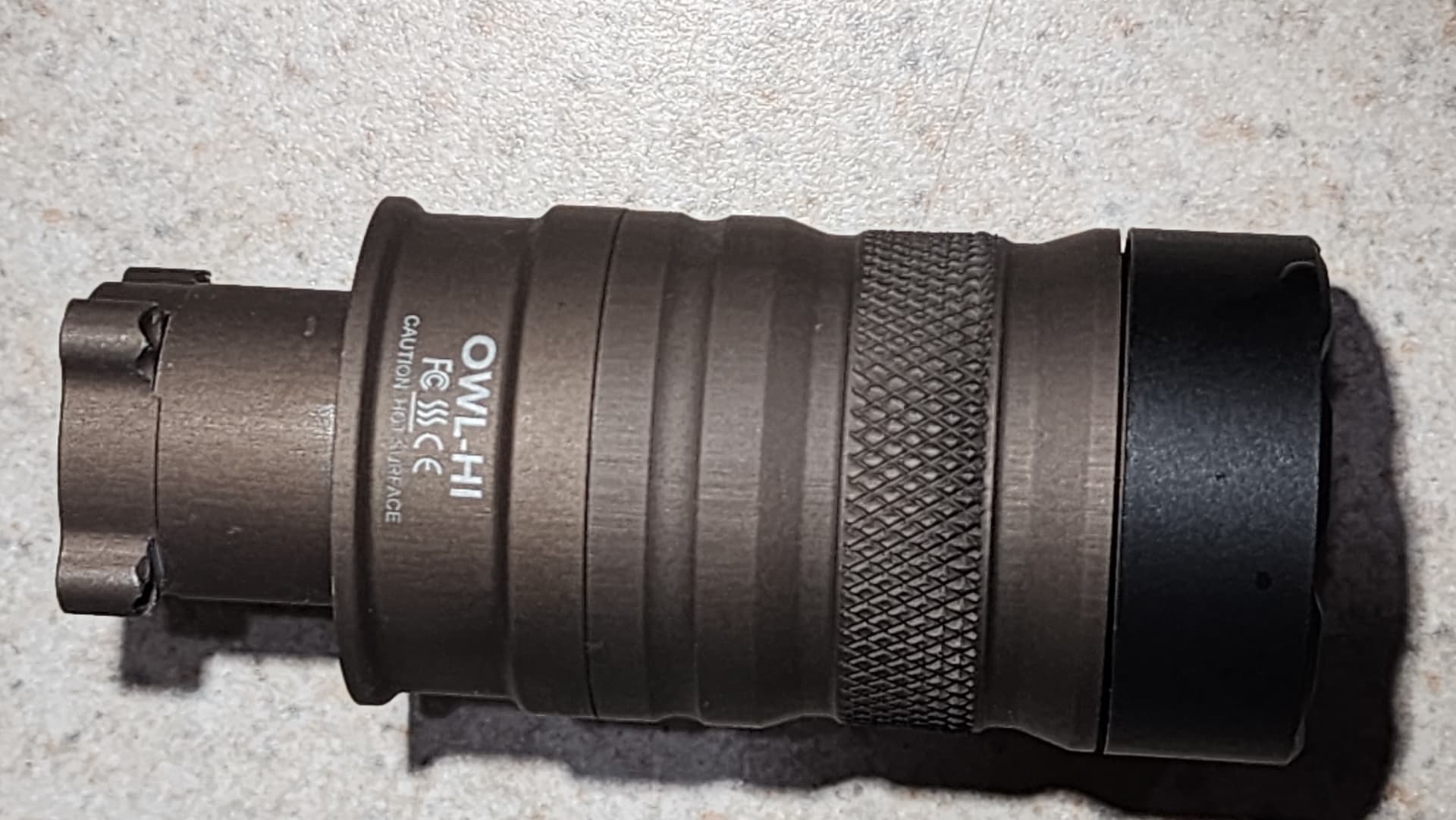

So I could not bet into the OWL light. I tried putting it in a dish glove and soaking in boiling water for a while to soften any adhesive. Light would not come apart. The reflecter sits behind a retaining lip under the bezel, and will not come out. I can see 2 seems in the construction of the head, but they have to be pressed in somehow. Im going to say without a proper press, I am out of luck on this one.

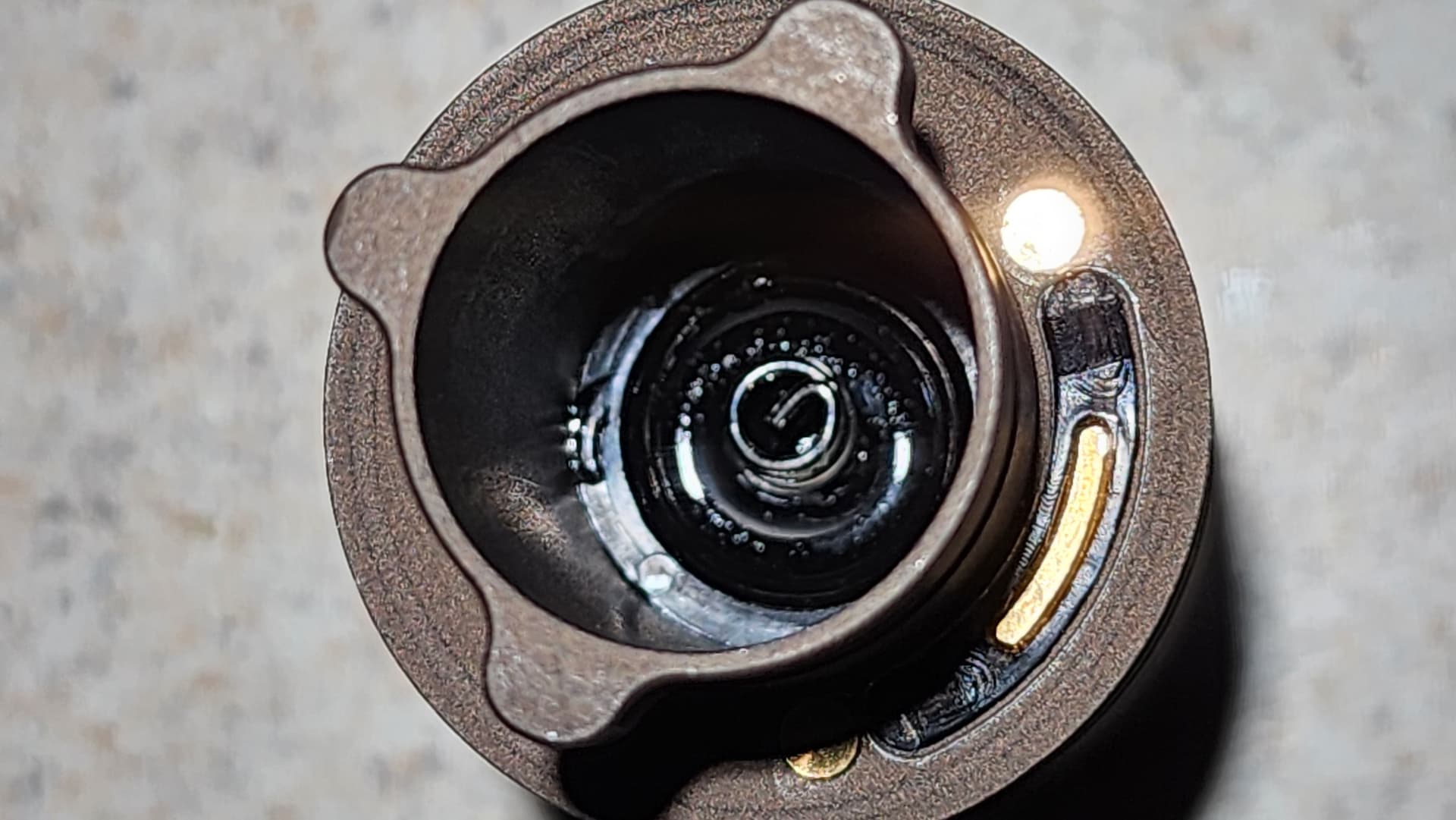

Any luck with removing the driver retaining ring? It appears that may be holding everything together .
I was thinking the same thing. But that is an impression in the epoxy that looks like a retaining ring. Its rubbery in texture lol who does. That!?
