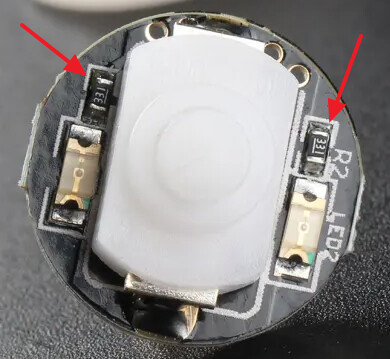

0.48mA is not for the stock Convoy orange lit tailcap. I measured 2.8mA with the battery at 4.0V. I replaced the 330 Ohm resistors with 5.1k Ohm resistors which makes it bright enough to find in the dark and with 0.250mA at 4V (lower at lower voltages) will likely drain the battery in 600 days or more. That’s how they should be sold, even if not so bright, otherwise in 2 months it will drain your 18650.

I modified the 2nd orange lit tail switch with 10k resistors. Current 0.102 mA at 4.15V. Bright enough and bright enough too with a battery at 3.3V. This will last more than 4 years, with 5k resistors I estimate 1.7 years. Both are fine w.r.t. brightness, visible in daytime (better than the orange button lights of the D4V2) and easily in the dark.
It’s not difficult, if you have a soldering station with a few different tips (KSGER T12 for example) you can easily try yourself.

With 5.1kOhm resistors the blue switch drains 238 uA at 4.096 V
Just replace these SMD resistors with the ones with higher nominals
