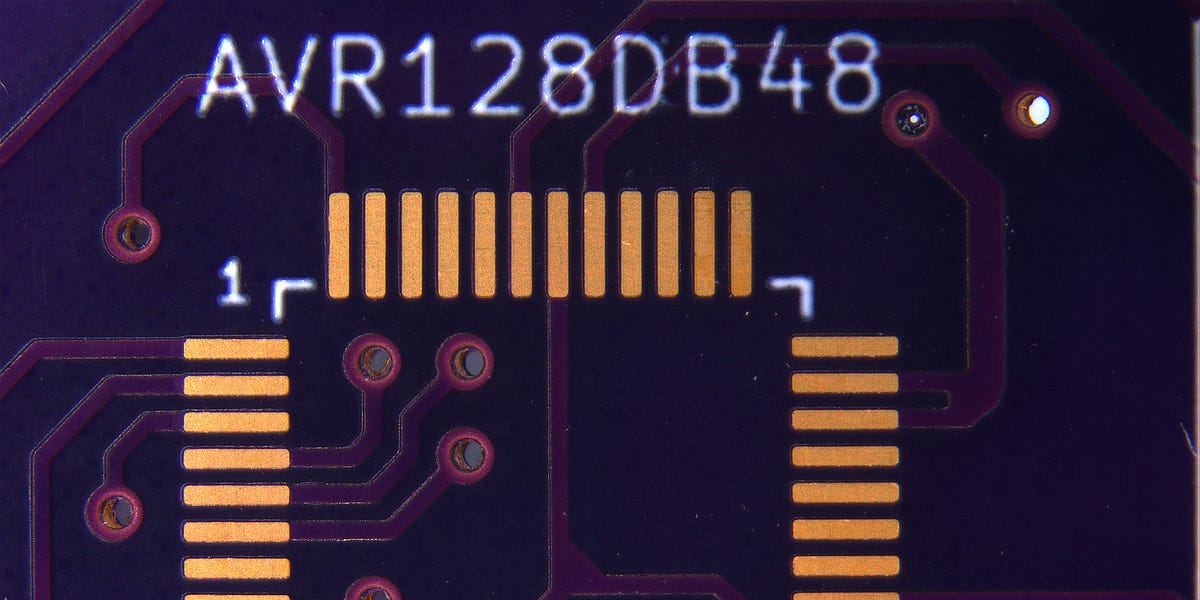

PCB vendor comparison
As per the subject:
Thought it might be of interest to y’all who need custom PCBs every now and them (@wolfgirl42, @thefreeman and possibly @ToyKeeper and @YBF650 too).
Looks useful for getting drivers made. Kind of a shame it doesn’t mention MCPCBs, which are possibly the most important kind of board for us enthusiasts.
