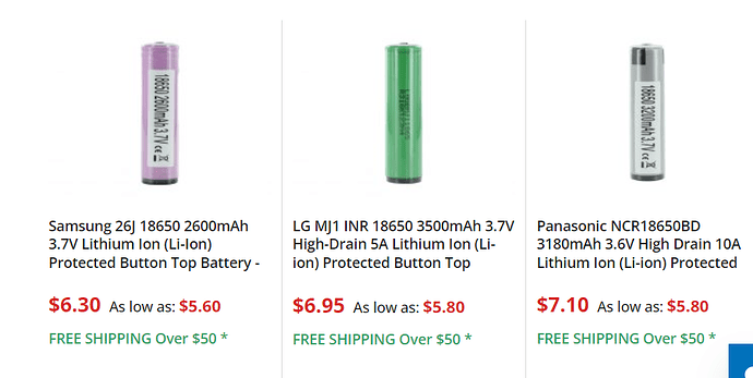

While I have the attention of the group I have another question. Is there any benefit going with a labeled battery versus the generic ones shown below?

The labels are a US requirement for li-ion batteries being sent from overseas I think. They’re the same otherwise. I recommend 18650batterystore for batteries in the US. I’ve bought from them a lot. Or lithium ion wholesale.
