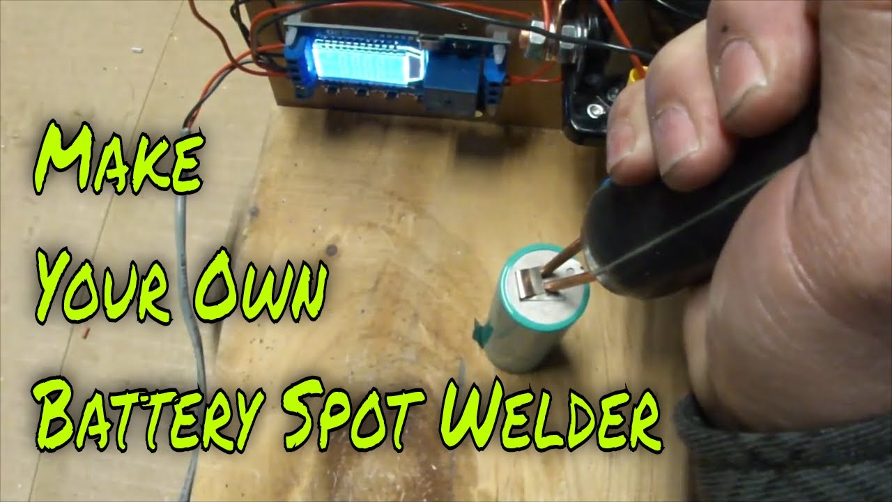

Ready made for $50 will most likely be a waste of money-- especially if you’re using thicker than 1.5 nickel — I have several from $350 – $80 ---- The one I bought from BatteryHookup works really well $80, but you have to catch when they have some
I also made one with a car solenoid and timer off of youtube – worked ok,but all y packs require 2.0 nickel
