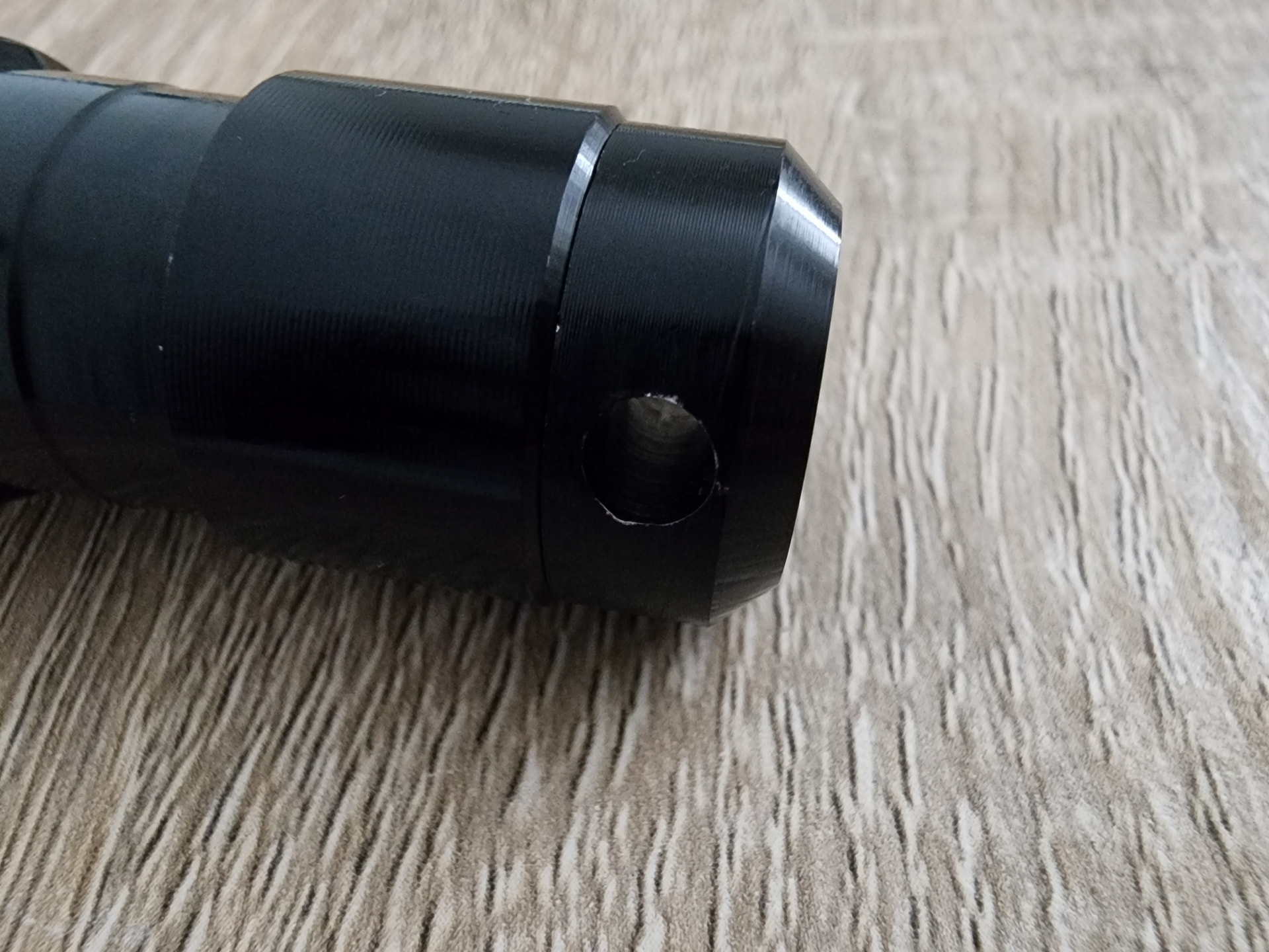

I’m looking for a carabiner-esque Dlink shackle or eyelet bolt I can use to attach this light to belt loops, paracord, carabiners, etc. The hole itself is about 3/16" (4.5mm) so I’m thinking a 5/32" or 4mm bolt would work, but have no idea where to look for a reputable supplier. The diameter of the tail is a bit under ⅞" (22mm).

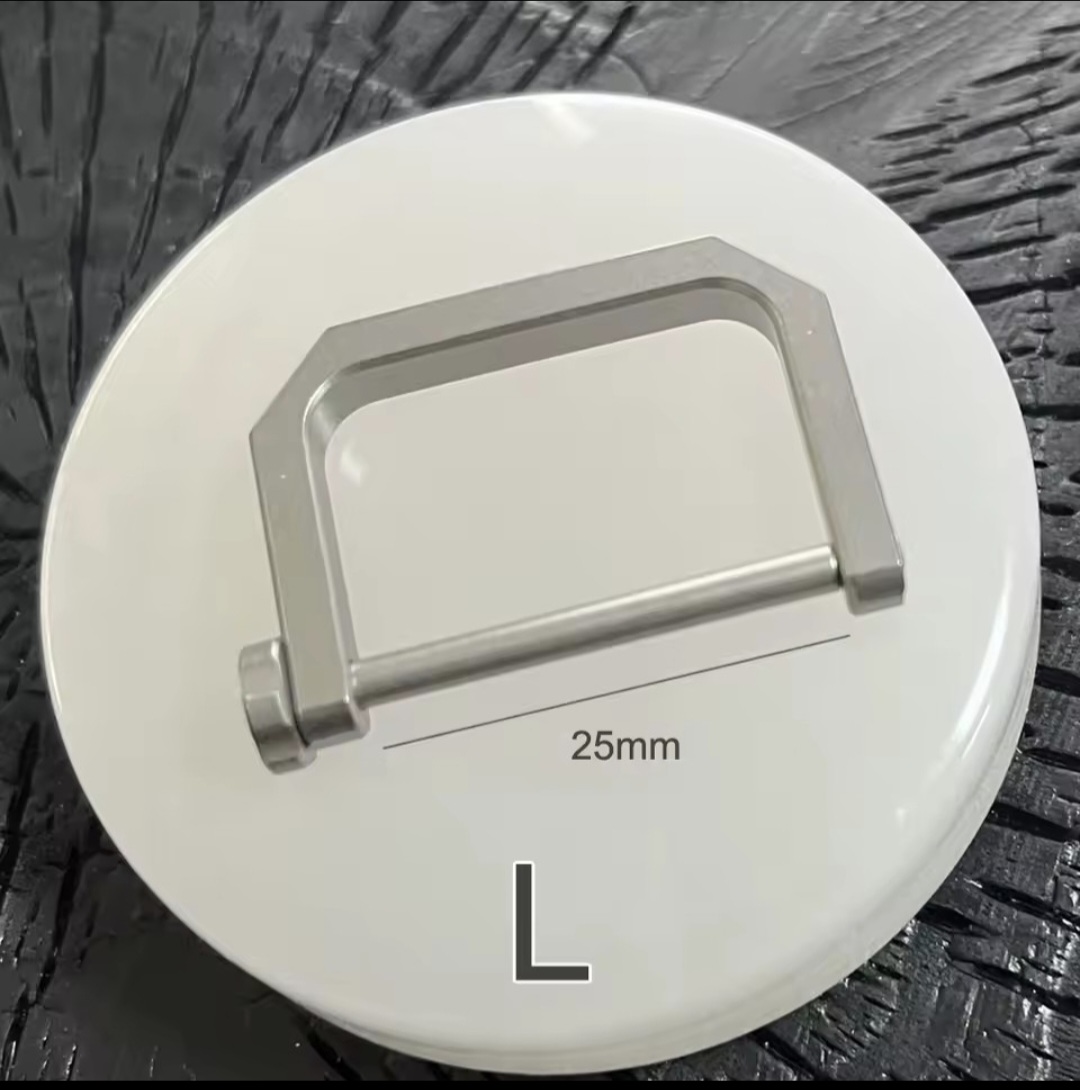

“Titanium D shackle” on AliExpress returns quite a few products but most have inner width of 16mm, without wanting to sound like a shill for them, Advance Bravely has this in 20mm and 25mm options:
I suppose you could also use one of those “wire keychain” things, plastic coated would help reduce the damage to the light.
I might spring for those, they look good, with hopefully reduced risk of galvanic corrosion. I was looking for a version with a slightly thicker bar, I imagine the constant rattling will eventually cause what happens to watches when the pins are too narrow, or the Arc flashlights with the integral lug…Maybe not in my lifetime, but I suspect this light will outlast me by several generations, lol. I’ll probably just pick up that Ti one and stick a fishing lure tube or equivalent in there, cheap and easy enough to replace if it gets too worn down.

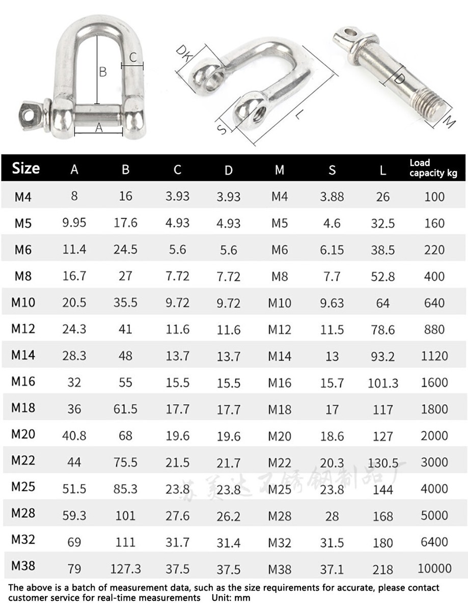

Stainless steel sailing shackle ought to work?
something like that, I was hoping for a more snug setup, but I can just put little spacer padding in there if necessary
Pinched off a web listing, at the width of the throat required (20mm) the diameter of the “bolt” is too wide for the light, as these have load ratings to adhere to.
This has been the issue for me; the “bolt” is either too thick or very narrow…but at least the “narrow” can be remedied with sleeves. I’m definitely going to go for that Ti one. I found some more rounded ones I like more, they look like over ear headphones, but the spacing is too small…
