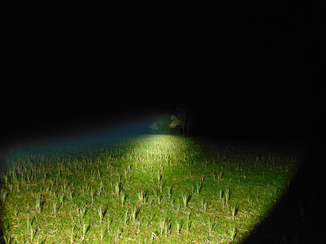

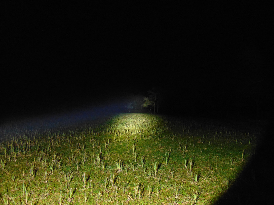

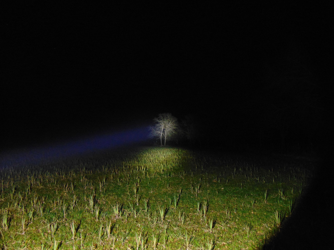

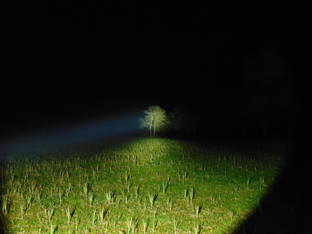

OK I went out and got the beamshots of the GT Mini , the Emisar D1S and the Maxtoch M1 Archer tonight. I had stated in post #29 that I remembered the Maxtoch M1 Archer being “a little brighter” than the GT Mini or the D1S.
Well when I got out there and started seeing the difference side by side , although the GT mini and D1S both do well for their size , the M1 Archer outperforms both of them considerably in the end , as far as the light on target.

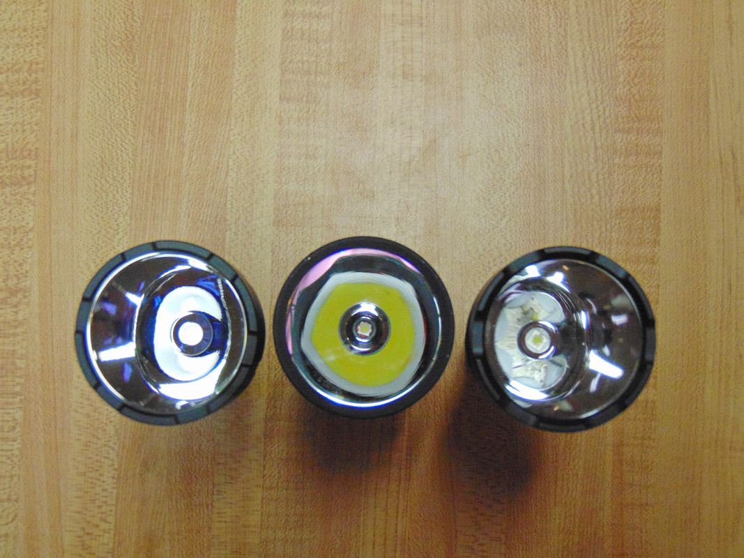

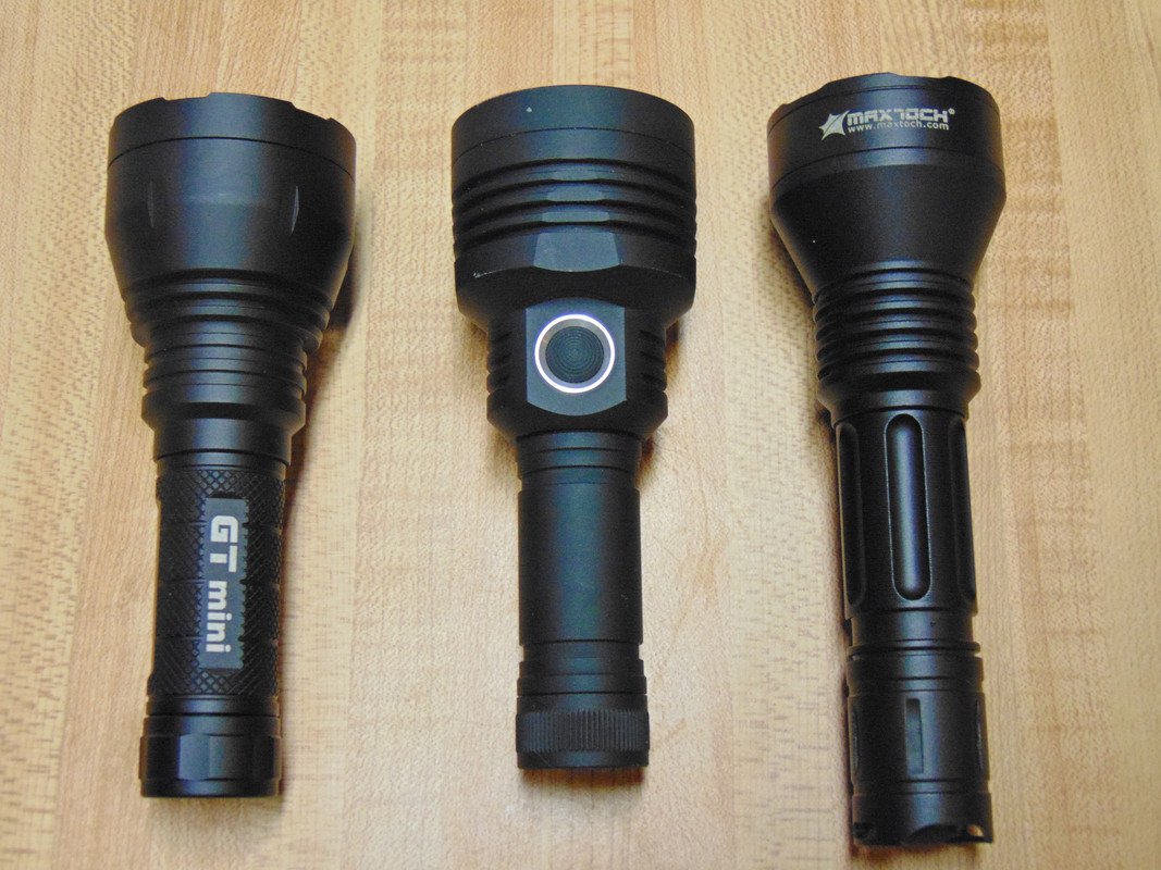

I took beamshots at 400 yards (the very farthest treeline with white marker for target) and at 175 yards (the 2 big trees side by side) and also did a side by side picture of the 3 lights with side view and reflectors showing.
EDIT: I did forget to mention the GT Mini has a XP-L HI V3 3C emitter in it now , instead of the 4000K emitter that originally came in the light. (I originally ordered the “neutral” emitter Lumintop had in them) Other than that no other mods have been done to the Mini.
Here are all of those pictures……….
In the order of … the GT Mini left / D1S middle and the M1 Archer in both side and reflector views……….

The center section , or main hotspot area of the 400 yard beamshots enlarged………
GT Mini
D1S
M1 Archer
And the 175 yard shots………
GT Mini
D1S
M1 Archer
