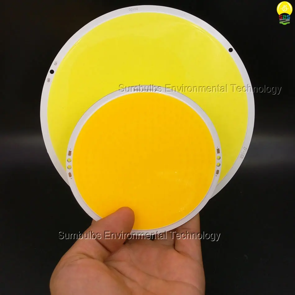

Goodwill or other thrift stores are good sources for 12V SLA batteries from uninteruptable power supplies. Combine those with a few large COBs (make sure to get 12V varieties) and you will have lots of Lumens/$, and they will run all night. (although you will need to throw in a heatsink or current limiting resistor so you don’t fry the COBs).
These are less than $10 each, the ratings say 12V 4A (48W) and >100lm/W, so that would be a claimed ~5000lumens each. I have some of the smaller COBs from this store that I bought for a different project and they were fairly accurate with their lumen claims.
