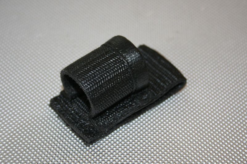

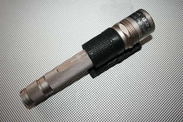

Here’s a loop type holster I made in - er, in 2011, I think. I do like this kind, as the torch can be drawn both quickly and quietly. As much as I do like velcro, at one point or another, I got sick of having to handle a velcro flap. Nothing against pouches with a flap, I just ordered two molle pouches for pistol magazines just for giggles, but really, having to listen to the “frrap!” every time is a bit unnerving to me.
Aw’ight, ’ere it is!
hand-stitched; made from an unused laptop pouch carrying strap; doubled for strength, and a sewn border improvised from one of those giveaway neck lanyards. Mighty sturdy! I made it for my L2r which I used to EDC at work, took me two days to make it.

Nice simple,but effective holster sixfink. That light has character. If it still works great, it would be a shame to retire it.
Dude your hand stitching looks perfect, I’ve hand stitched a few things before and I know how hard it is (that’s why I bought holsters till I’ve just talked my wife into it).

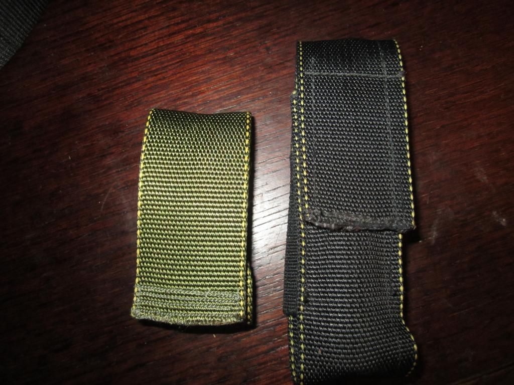

Here are two I made today using a 1950 Singer Model 66 Sewing Machine. I used V69 thread with #18 needle. Material is 1 3/4 Mil Spec 4088 Nylon webbing. The small one is for a Fenix P2d, the other I made for my Fenix PD35. I rolled a piece of Kydex, cut in half lengthwise and stuffed inside for ease of removal to prevent hanging up on the interior seam, but you could use a piece of pvc pipe just as easily. All I did was take apart the crappy holster that came with the PD35 to use for reference. I have no prior sewing/upholstery/holster making experience. Using a sewing machine wasn’t nearly as difficult as it looked. Pretty much made it up as I went along, a little internet research and I was MYOG baby.
But for the record, I don’t “sew”. I Prefer to call it tactical fabric manipulation or Man Stitching :cowboy_hat_face:
Hi and welcome blacksheep1. You must be a natural with the sewing machine. Unless you can do trick photography the stitching looks perfect. Man stitching. Hmmm. Have to look into that one. :wink:
Oops! Forgot to mention the light tan stitching along the edges were already there, that’s how the webbing comes from the place I ordered it from. It looked kinda cool, so I left it. I used thread same color as the webbing, so It’s harder to see.
