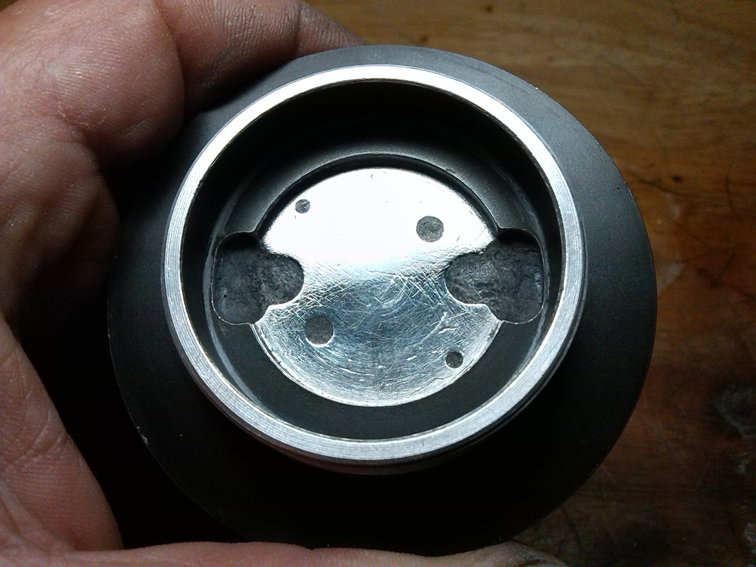

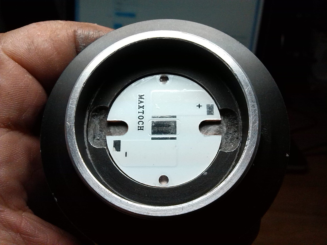

I’ve never had the chance to try one from them. However, based on the photo, I’d say they pour epoxy even on the driver itself? Is that applied to the entire head of the light?

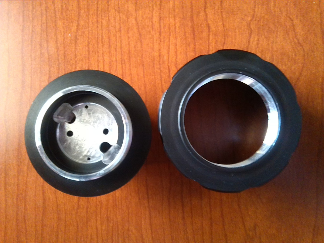

Mostly……can’t buy them like that…based on the M3 Combat Lights and 961/962 weapon lights, had some help from a couple friends…

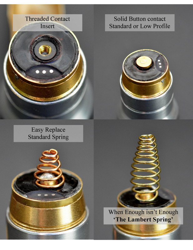

Battery tubes, M3 bezel adapters, modified Surefire tail caps, I had the reflectors custom by Dan Chan HK and copper pills made by Sinner, the original design for the pill/sink Randy Brogden.
