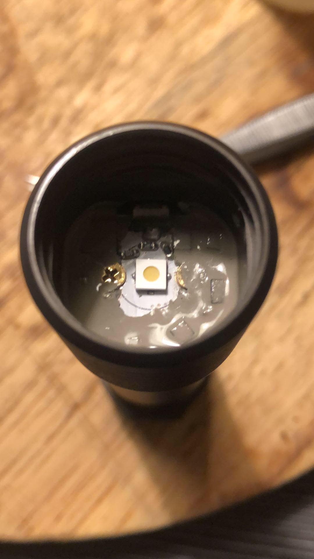

Any pics of it cured after applying?

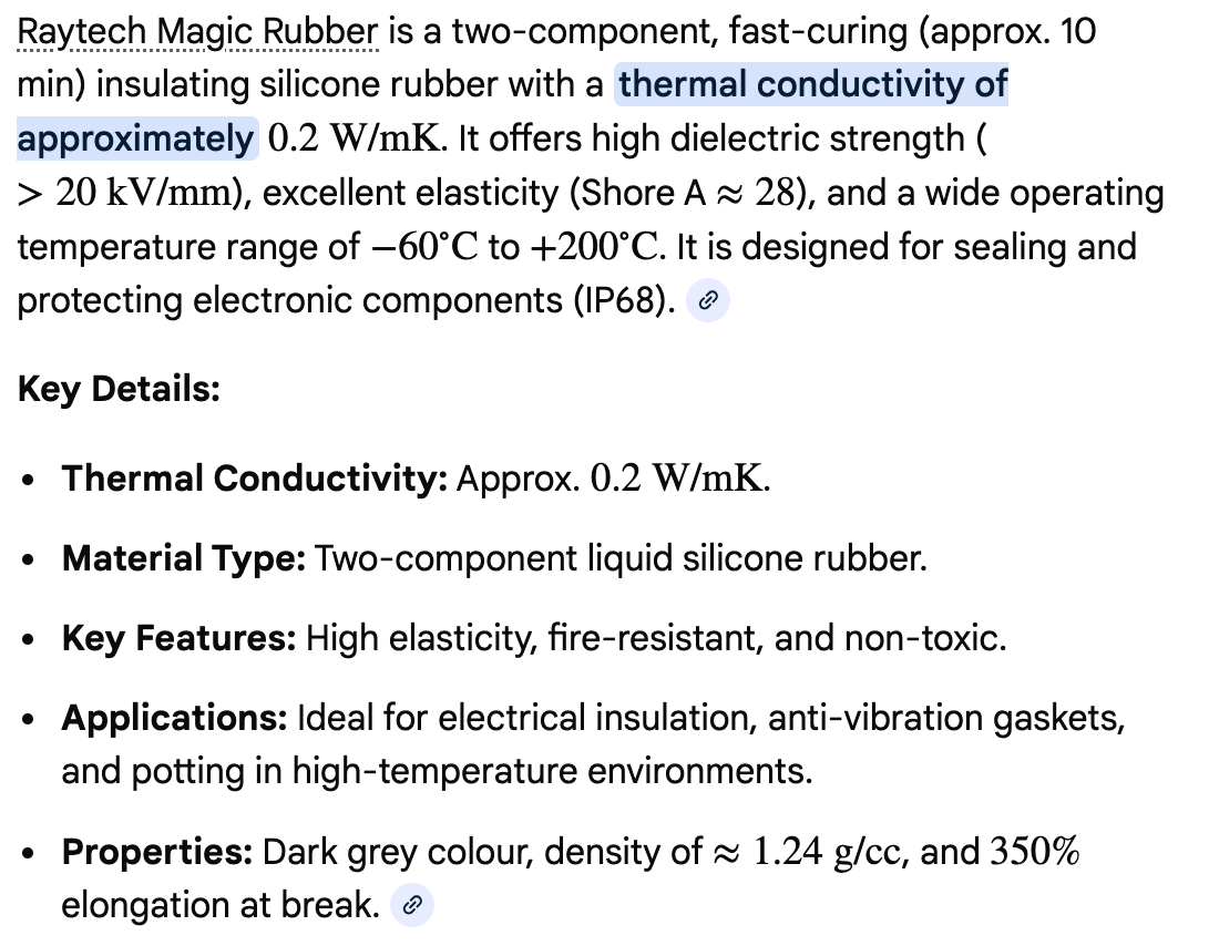

magic rubber, thermal rated to 200C, looks like what Zebralight uses.

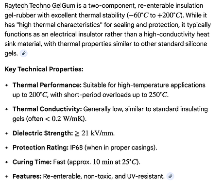

techno-gelgum, less expensive, also rated to 200C

That magicrubber i use is a thermal conductor while being an electrical isolator, so yeah, use it whenever you can

Magic Rubber has better thermal transfer qualities (better for flashlight potting):

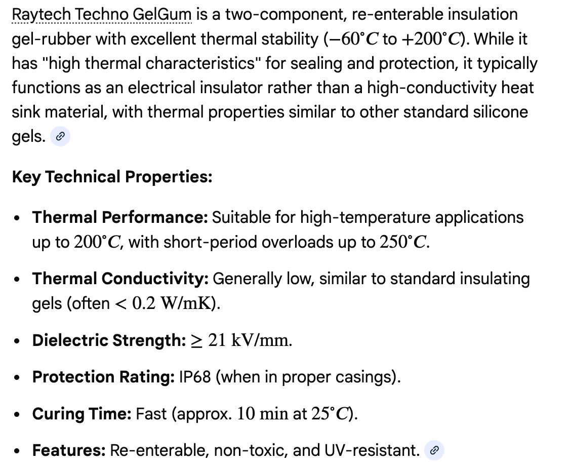

techno-gelgum is not as thermally conductive, its more of an insulator, so Magic Rubber is the better option for flashlights:
