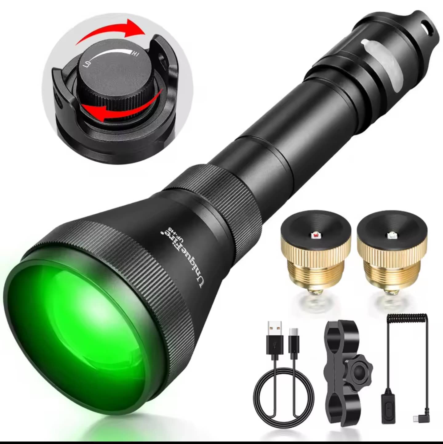

Ive Googled it and cant find what im looking for.. that could be a bad thing as that idea sucks, or not many have tried it.. has anyone made a tail switch that is a rotating dial, it can turn the light on/off and have a smooth power up/down.. have a slightly longer tail cap and have the knob flush or slightly lower than the tail cap, cutouts on the sides lets you rotate it while keeping the tail stand as a feature..

Like this ancient thing?
Something like that.. but yeah routing the wire would be a pain, and the contacts would be worth it to be able to remove the cap for the battery.. up by the head would make more sense..
Hall sensors! (probably patented and proprietary by a company like sue​:fire:
Obviously it misses your main point of designing the dial into the tailcap, but it showed it could be done very effectively,
