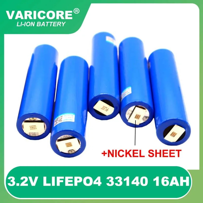

Found nice, big LiFePO4’s for my Maglite project, maybe You could use them to build Your own power station:
When 4 are connected in series You get 12,8v - very universal voltage. Just add some 12v car charger with let’s say 4 USB ports and You’ve got a simple power station. Need 110/220v? Add a pure or modified sine inverter, this one is quite fine when it comes ti quality:

I looked at those also. Problem is to get the high capacity I’d need series/parallel. I think I may end up doing a crapload of good quality 18650 and go from there dince the good lifepo4 batteries are really expensive. Trying to do it on the cheap is turning out to not really be cheap.
What budget do You have? And how many Wh would You like to achieve?
A house fire is sure even more expensive than the price difference from the usual Li-Ions to LiFePO4. About 2 and a half years ago, I studied the matter closely and decided to pay the difference and get the much safer LiFePO4 chemistry rather than running that risk – YMMV of course.
