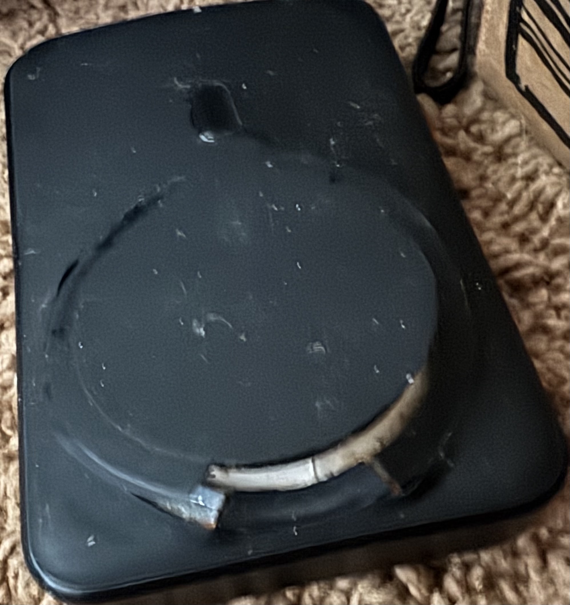

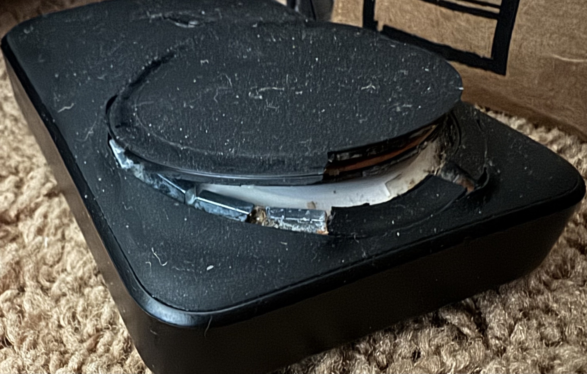

I have a BaseUs power bank and just noticed the magnetic ring busted through the plastic top. Not sure if that means the cells inside have swelled to cause this. I recently noticed when I tried charging this no lights lit up so I was figuring it was dead. 2 weeks later the charger has split through the top. It seems like it is still separating more and more so I want to dispose of this thing ASAP. Can I put this in the Home Depot recycling bin where they take rechargeable cells?

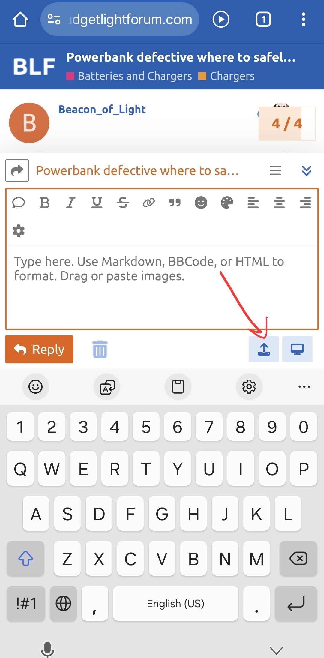

Wish I could figure out how to post pictures here but it’s not intuitive as there is no graphic icon to post pictures here.

It’s the horizontal bar with an upwards arrow.
On mobile I don’t see what you’re describing
Oh ok now I see it.

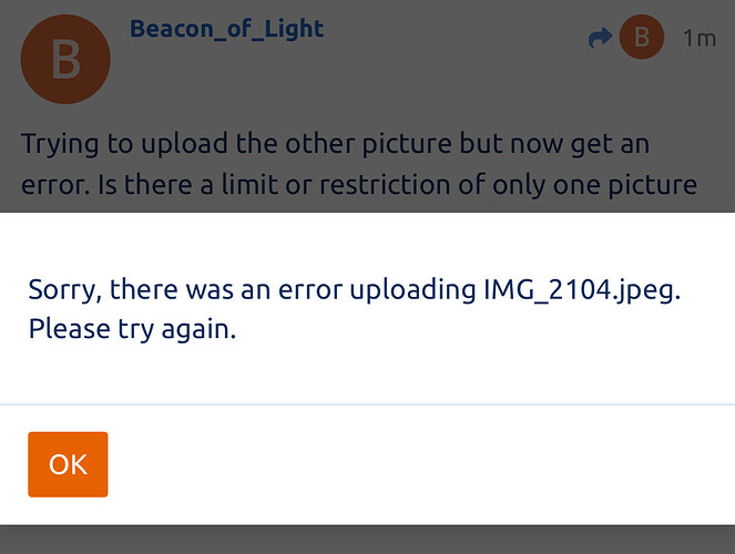

Trying to upload the other picture but now get an error. Is there a limit or restriction of only one picture per thread?
Maybe for new users, the new user rules are pretty restrictive for your first couple posts to keep spambots in check…
Usually you can upload 5 pics in one go, and I have uploaded 20+ to a single post without issues already.
That definitely looks like a swollen battery. How long ago did you buy? Baseus should cover this under warranty. Often they even cover swollen batteries outside of warranty as they are a huge fire risk and they want them disposed of as soon as possible to avoid fires tainting their brand name… My mother’s Google Pixel did the same, half a year after warranty was over, and google sent a new phone no questions asked.
Either way, do not use (especially charge) this thing anymore. Keep it far away from flammable things, and see what Baseus says first, then dispose of (following local regulations for Li batteries, not in the household waste please :sweat_smile:) ASAP.
Actually I did a warranty replacement for this about a year ago since the power button was frozen but it would still take a charge and was usable except for the stuck power button that wouldn’t work. They sent a replacement and just told me to dispose of the one I posted here. Since it still worked I never thought twice until it recently started to bulge. I guess I will contact them and see what they say but that may take a week or more I just want to get this thing out of the house.
You can reduce the chance of anything bad happening (basically to zero) if you discharge the powerbank slowly.
If you have anything that uses a constant 500mA or so I would do that - outside of the house ideally. Obviously do NOT recharge the powerbank again.
