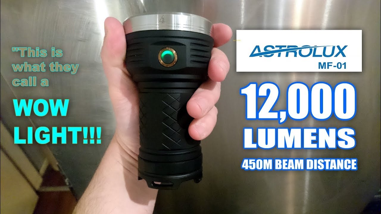

Tempted on getting this light, but I’m a bit apprehensive as to the 2S2P setup (Capacity and Voltage). Besides the danger of inserting batteries in the wrong polarity, what other dangers could potentially exist from this configuration using non protected cells? I’m aware that a 4p setup (Capacity) is generally safer using non protected cells, but so far all of my lights use 2s and 3s configs and they all run protected cells.
the production lights have modified battery carrier to allow protected calls and handle reverse protection with plastic discs
4P battery carrier is even worse if you insert one battery reversed while 3 normal are already in it
Mixing full and empty cells in 4P also leads to bad things to happen, while in 2S/2P you wont ever reach reverse charging like in 4S possible, just if you over discharge a cell recycle it
Ok. Thank you for the information. I’ll most likely get this light sometime soon. I have some friends who are afraid of flashlights that use Li-Ion cells because of the bad rep of exploding. I tend to think the technology is generally safe, so long as you know what you are doing, and respect the tech. Safety first!
Seen the Nichia measured from as little as 8000 lumens, my XP-G3 MF-01 measured around 10,500 lumens, but it appears brighter as there’s not much spill. Just a big wide hotspot.
