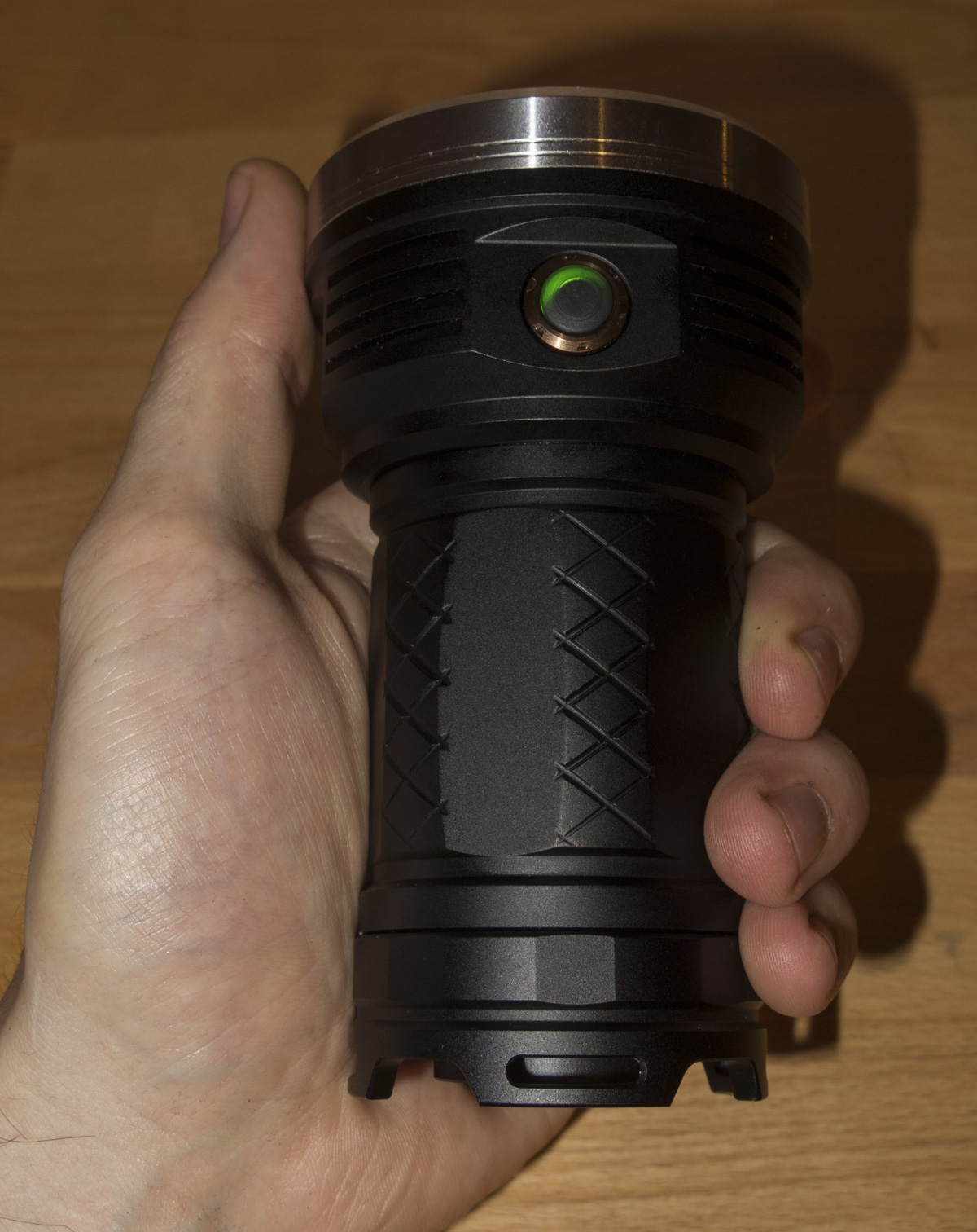

Weight: 550g (without battery)
Size: 125mm x 72mm x 52mm (length x head x body diameter)

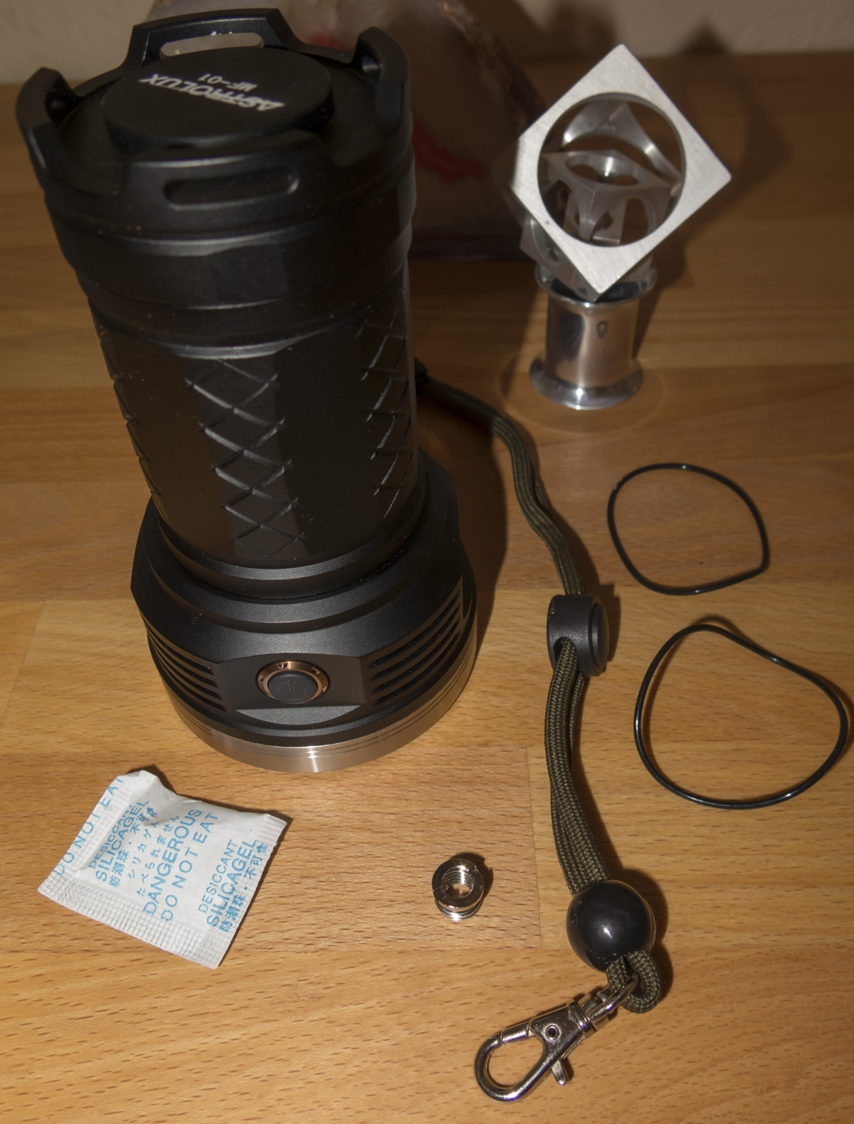

Package and content:

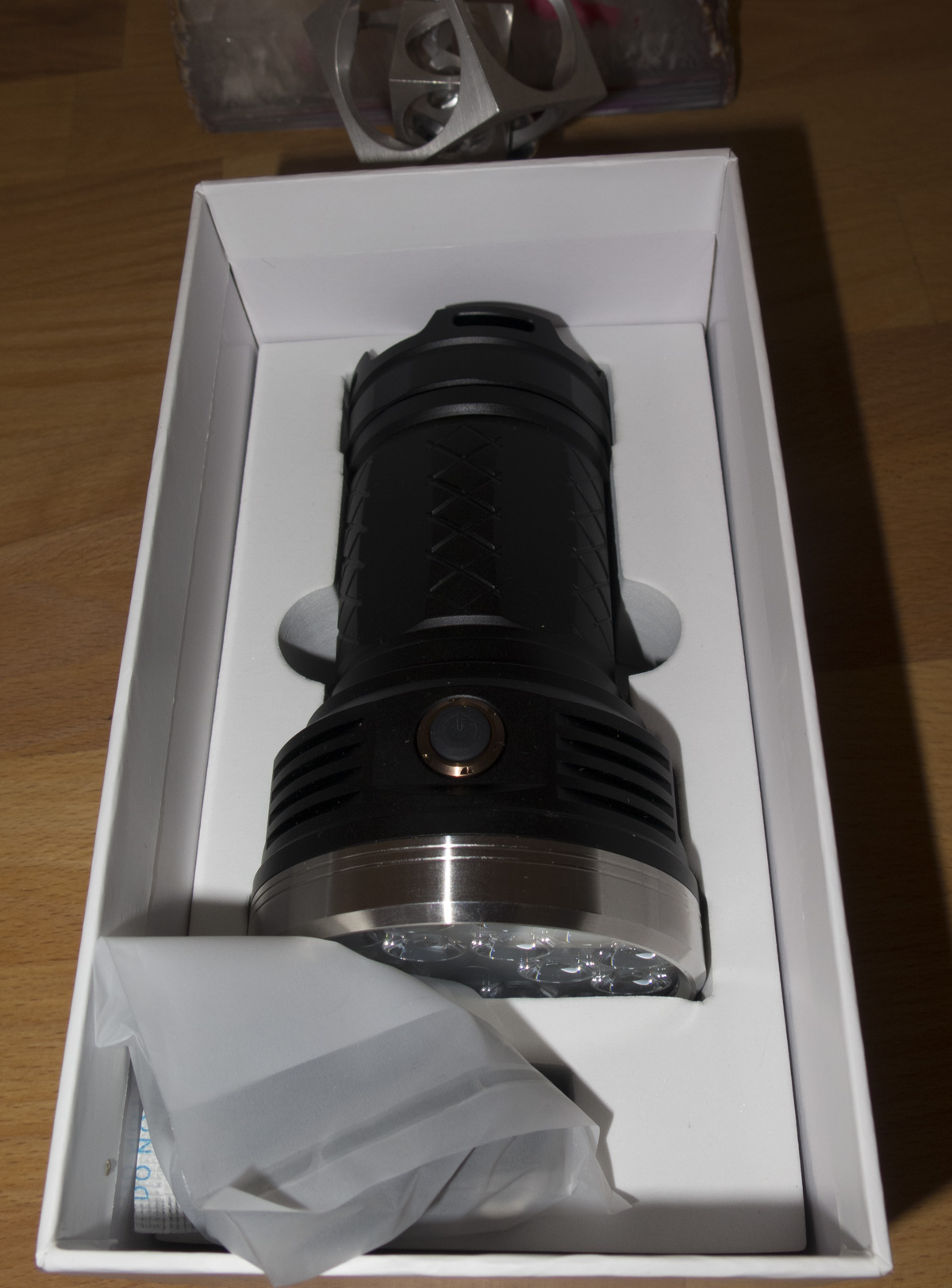

The lights box came packed well with a plenty wrap around and in a plastic bag
The light comes in a solid card box
the box is also coated with plastic the tape gets off without any residue or damage
The box has a compartment for the light and a bag with small parts
It comes with 2 spare o-rings, lanyard, thread adapter and manual, but in my case the manual is missing

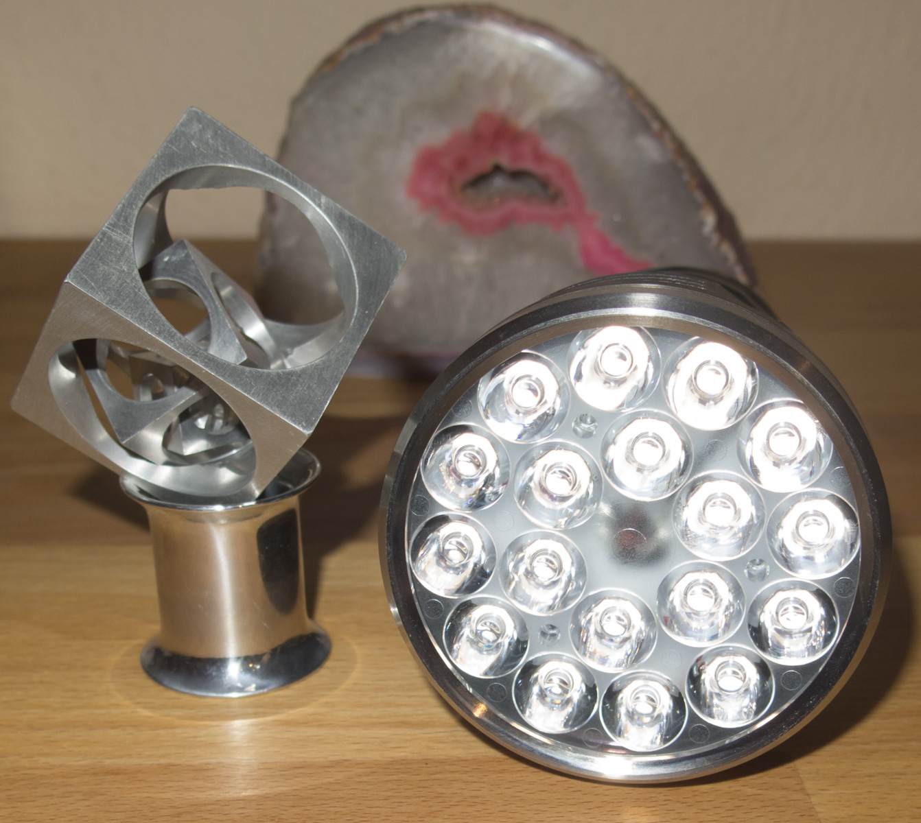

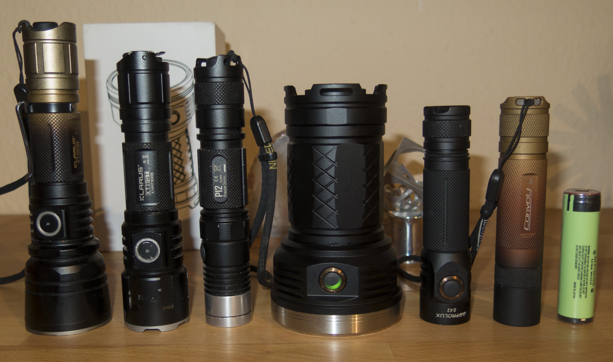

Size compared to other 18650 lights, I do not own SRK size lights, the MF-01 is a bit bigger than them as the head has a lager diameter than the battery tube

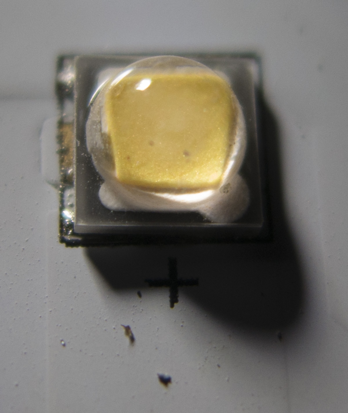

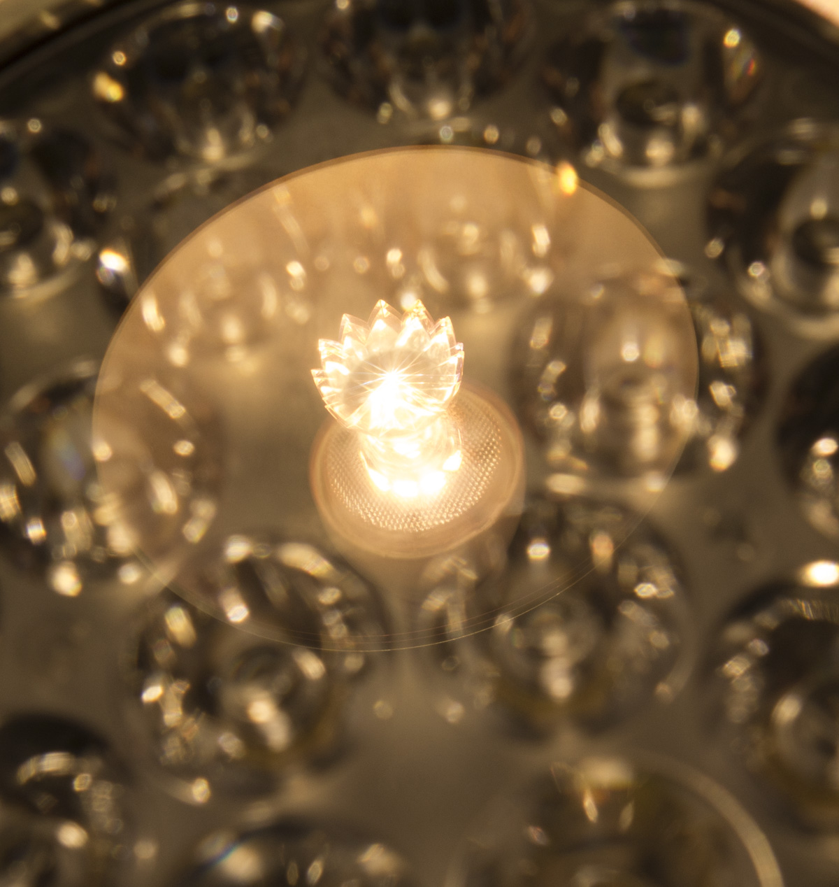

Beam color is neutral around 5000K for the Nichia 219C model, the Nichia has a nice uniform beam and color rendering is great

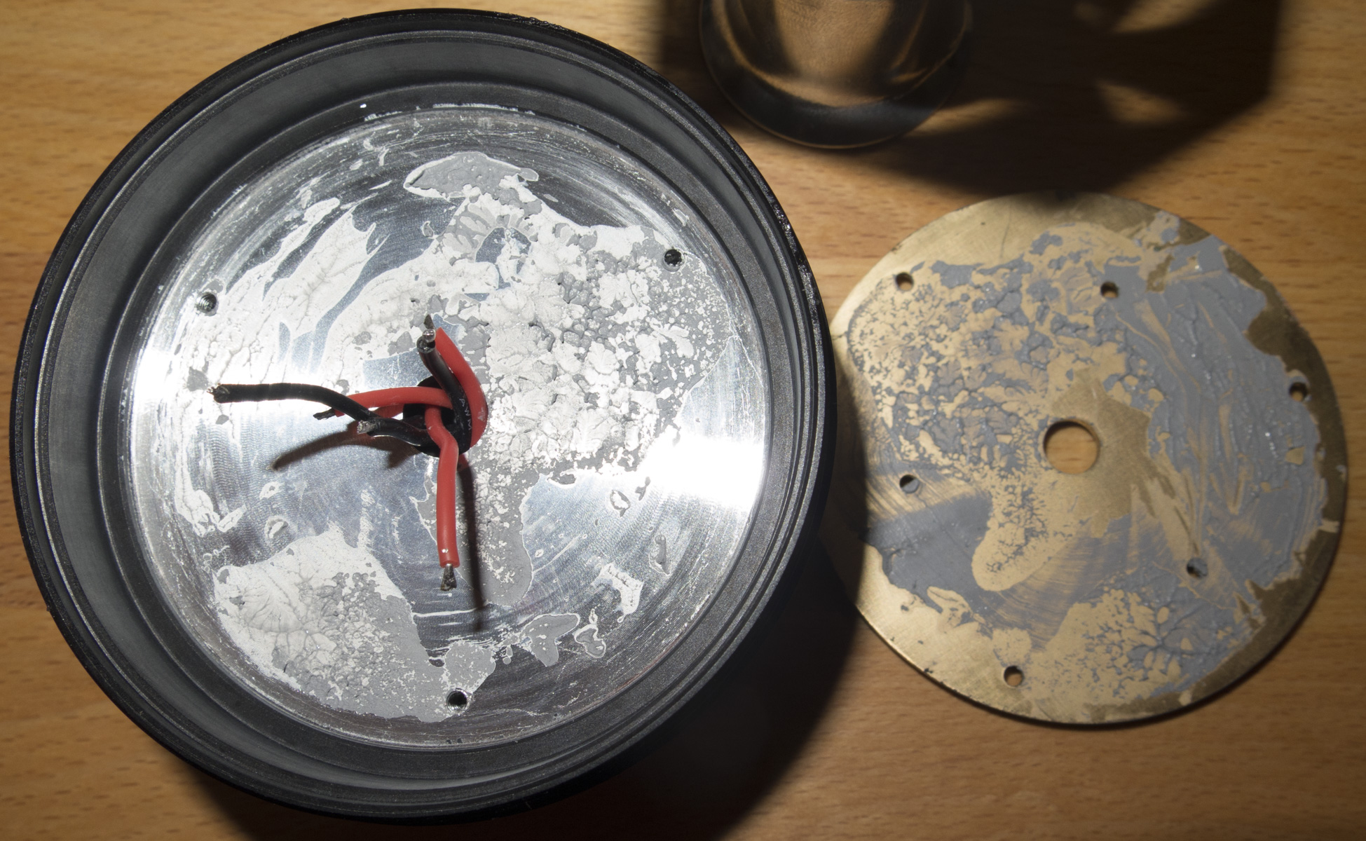

The LEDs are reflowed ok could be better and the MCPCB is perfectly flat, but not polished

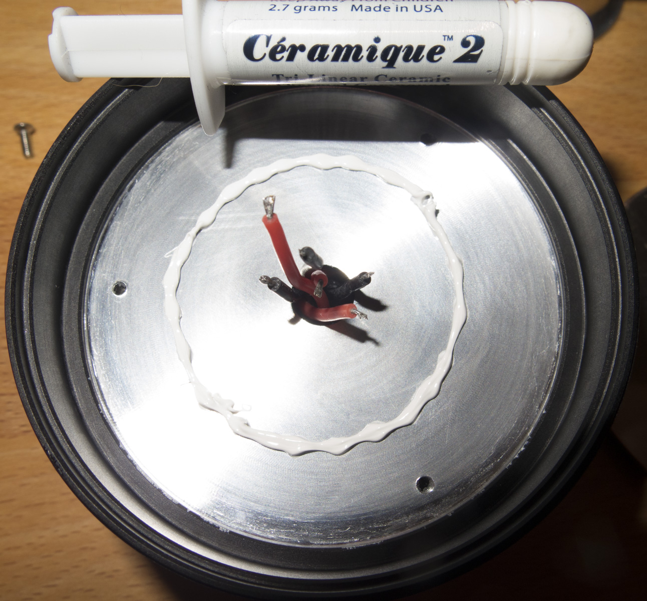

Unfortunately on my sample there was a little solder under the LED board and the heat paste was not evenly spread
and some small dust particles on the domes of some LEDs
from left to right the lights get warmer, picture taken @5000K camera setting
left Astrolux S42 Nichia 219C 5000K, Astrolux MF-01 Nichia 5000K, XPL HD 1A 6500K
The LEDs in this light are available XP-G3 and Nichia 219C

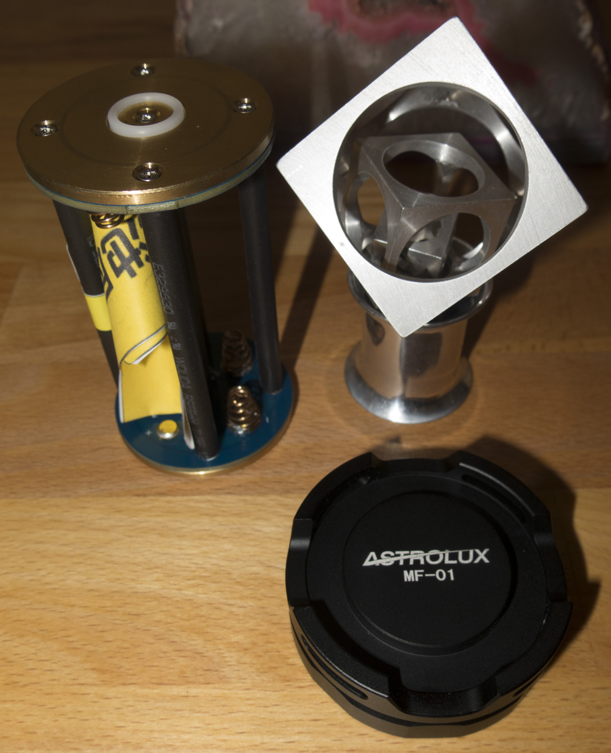

The light can be taken apart completely, nothing is glued

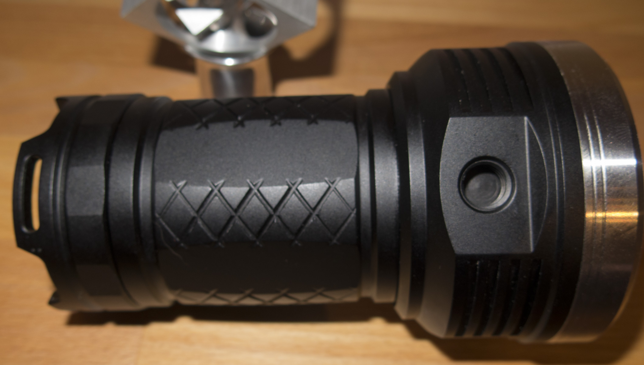

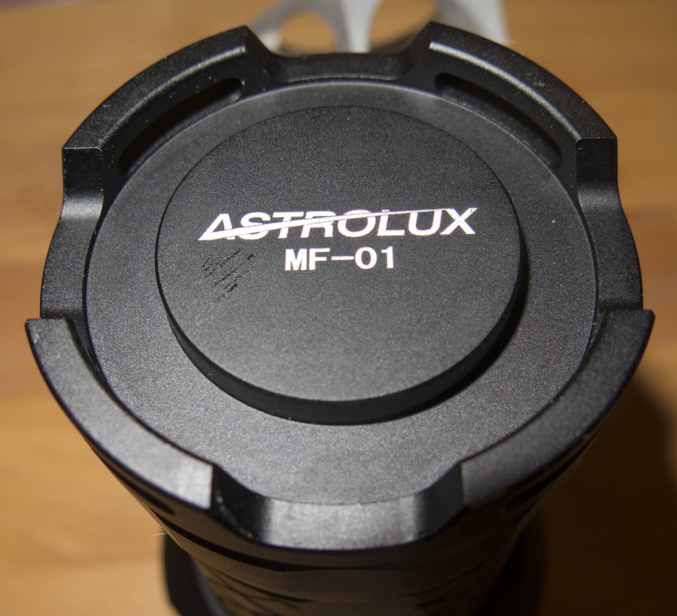

The light has a massive tail cap with holes for a lanyard, and tail stands rock solid
The head has a diameter of 72mm and 62mm visible of the TIR optic
The battery carrier comes with a warning not to put in the batteries in reverse polarity

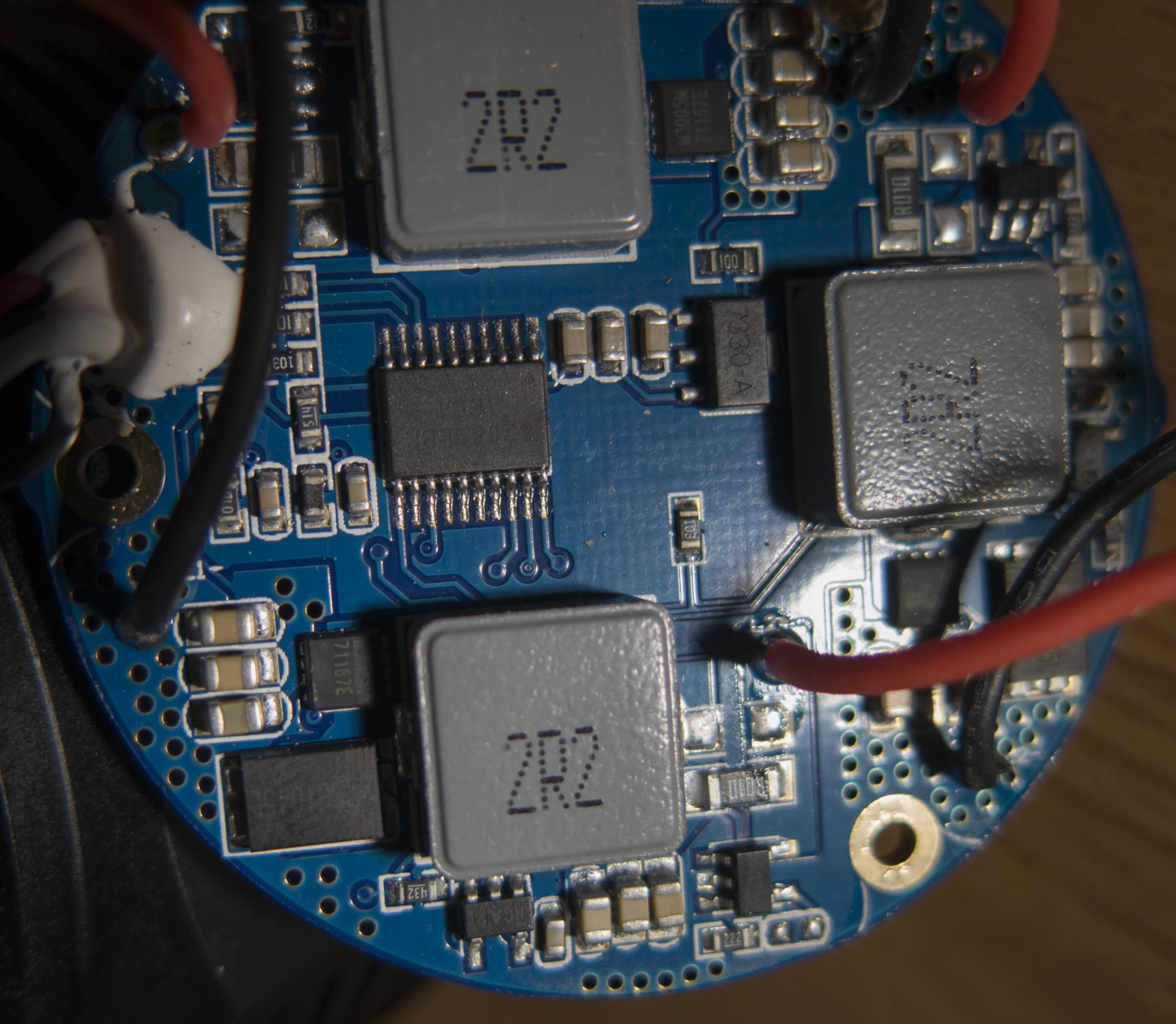

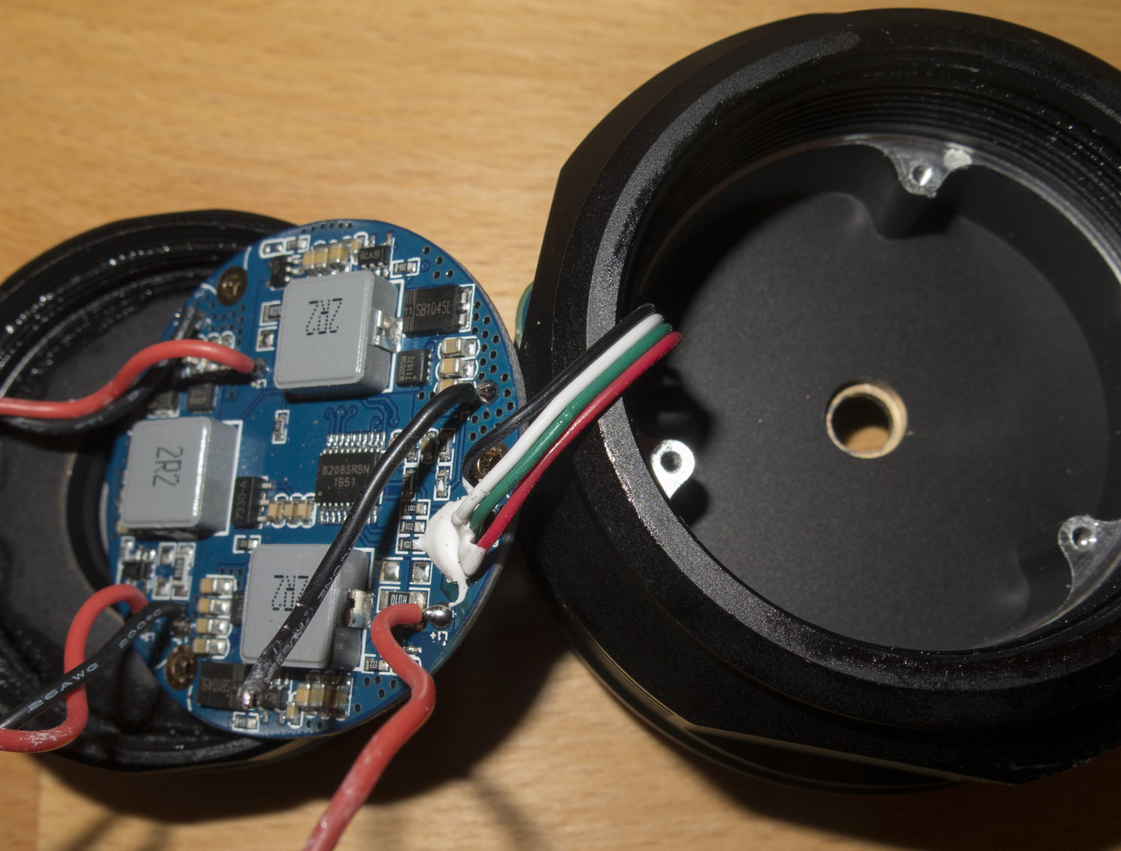

The driver can’t be pulled out easily, the LED leads have to be unsoldered
The light uses 3 separate buck regulators
The light can be physical locked out by twisting the tail cap or head about a 1/2 turn

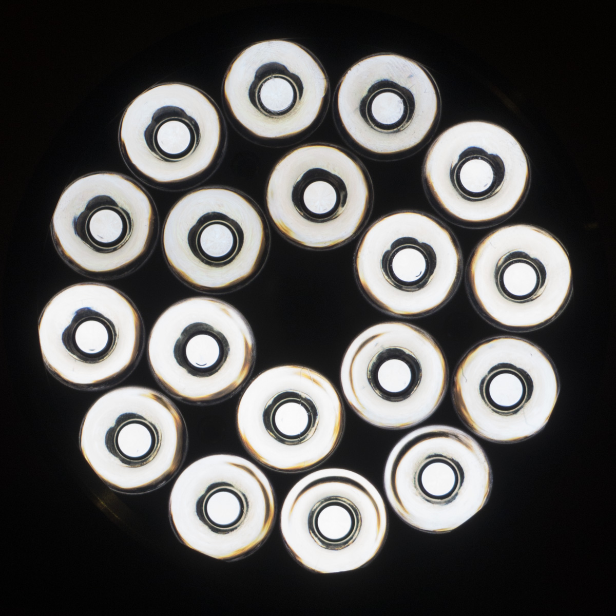

the TIR is a medium throw, gives a nice uniform beam with some spill
the Nichia LEDs fit in nicely and the majority of them seem all to be centered perfectly
the LEDs are wired in 3 pairs of 2S3P

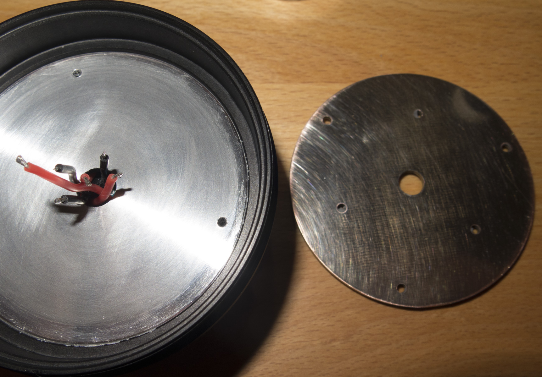

The shelf is 2mm thick and the 1.5mm thick copper MCPCB does a good job spreading the heat, on Turbo the head gets hot quick, so the thermal path is well if the heat paste is applied better than in my sample
The MCPCB is s true copper DTP, the back of it is gold plated
The MCPCBs back is perfectly flat

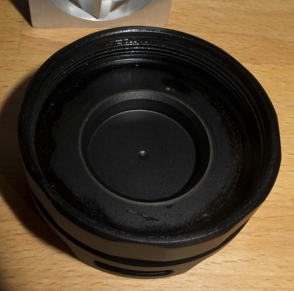

Tube and Tail
The tail cap is solid and fully anodized there is no battery connection
the tube inner diameter is 45mm even my double heat shrink tube unprotected batteries have some play

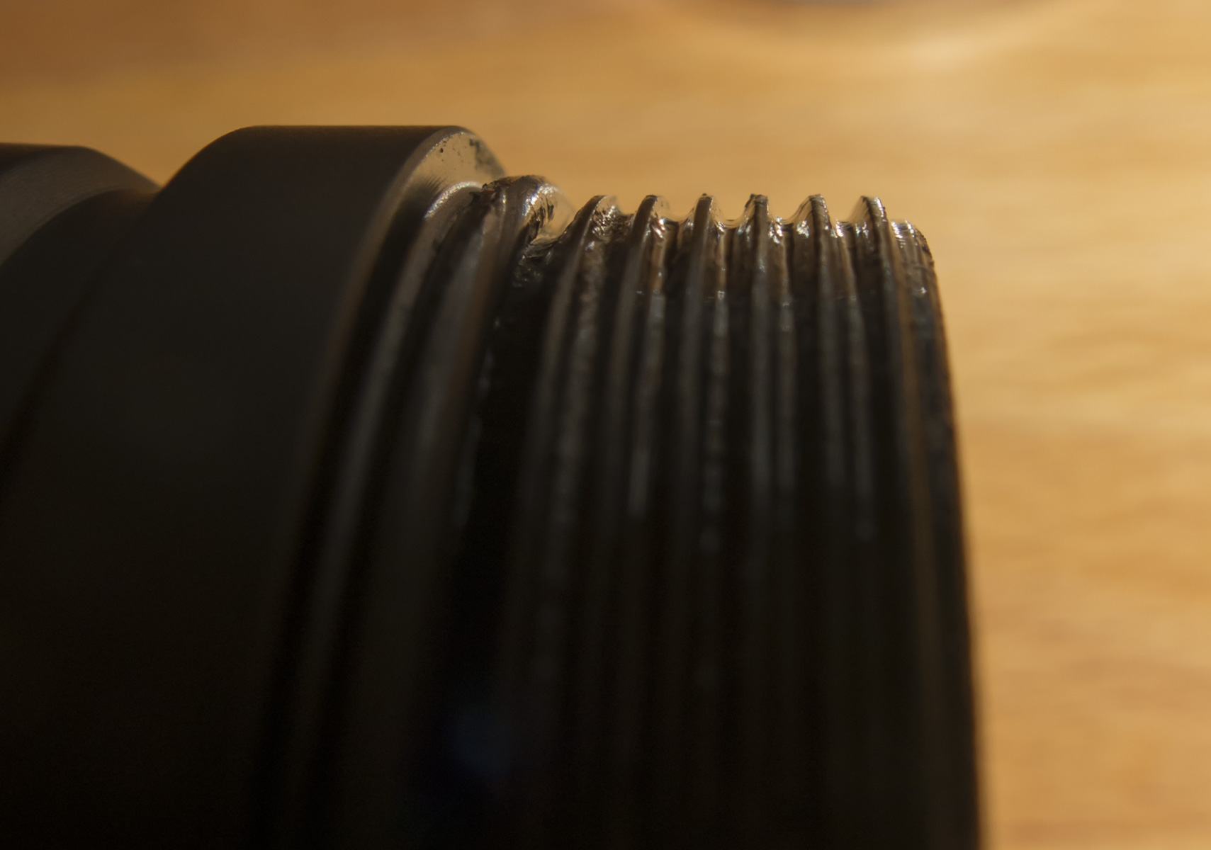

The tube threads are triangular cut on both sides, the tube has 2 o-rings and both sides is lubed for water tightness, the amount of lubricant is good
square cut would be nicer, but all Astrolux lights have triangular with a flat top
Driver and Battery
The light has no visible PWM in any mode, even falling water drops show nothing

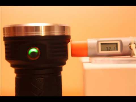

The light has a lot mass to absorb heat, in turbo mode on a high drain cells it gets hot quickly, in High the temperature takes quite some time to get hot
The light seems not to have a temperature protection which is not fast,
the head heats up above 75°C then I shut down the light a minute, when I switched it on again it stabilized at 70°C
as I got no manual I cant check if its specified there

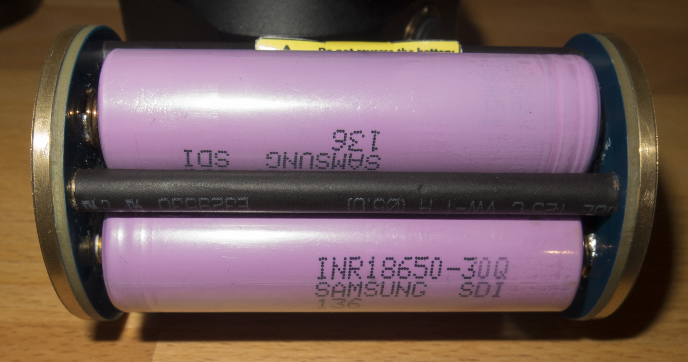

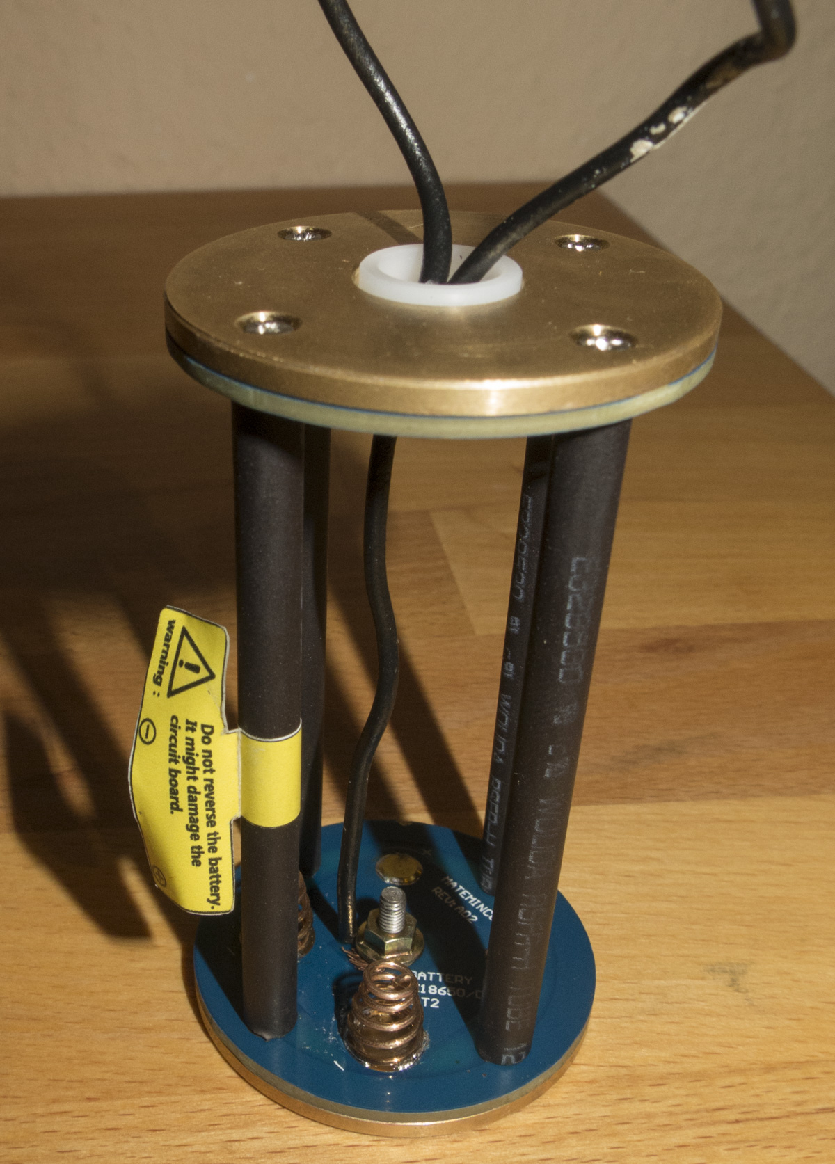

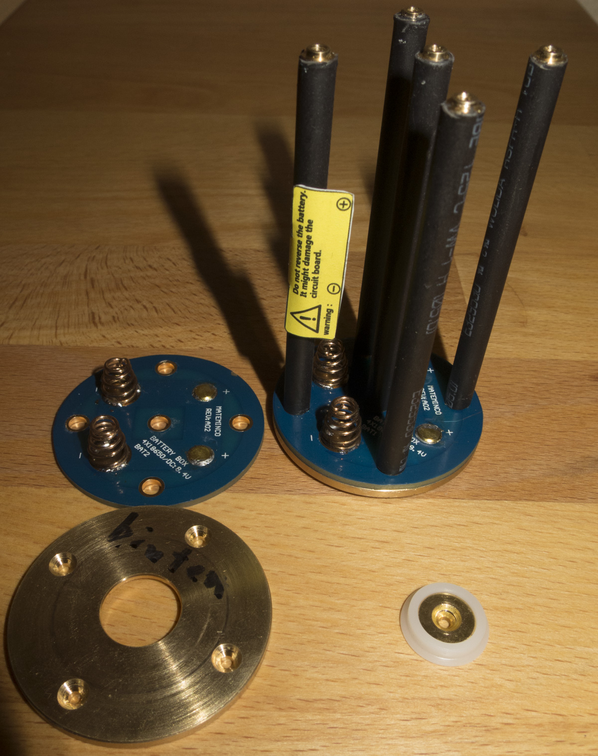

The 2S/2P battery carrier is build rock solid and can be inserted both ways
The battery carrier can be used in both directions, but it’s better to put the side where the battery positive and negative is separated towards the driver to avoid the current flowing through the brass rods connecting both sides
The light is build for unprotected batteries, protected or button top unprotected won’t fit, the ones I have with a 2mm brass button fit barely
On the left the one with the brass button and on the right a flat top battery
the springs get fully compressed with an unprotected brass button cell, so their resistance is very low

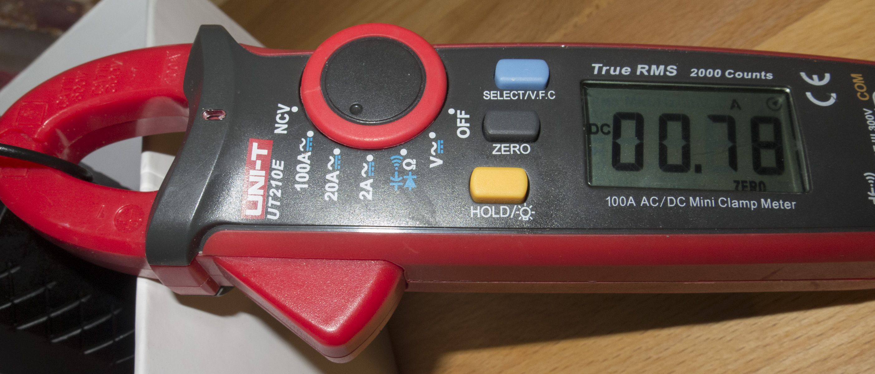

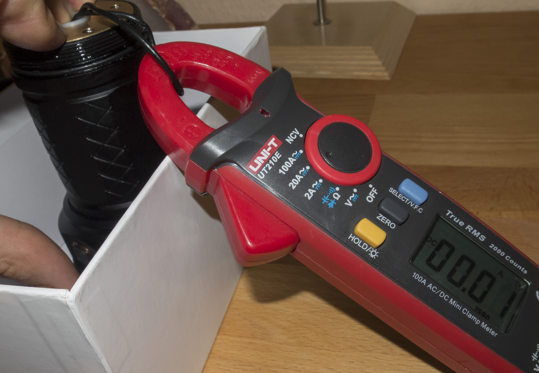

Current measurement with 4 Samsung 18650-30Q fully charged and rested at 4.15V
The carrier is modified to measure the current with a 0.5mm² wire, so the measurement might not as precise as in the assembled light
Tail current for modes
Moon 0.125W 8.3V and 15mA
This is not really accurate with the clampmeter, I guess the real current is lower
Low 6.4W 8.25V and 0.78A
High 57.4W 8V and 7.17A
Turbo 120W 7.66V and 15.67A

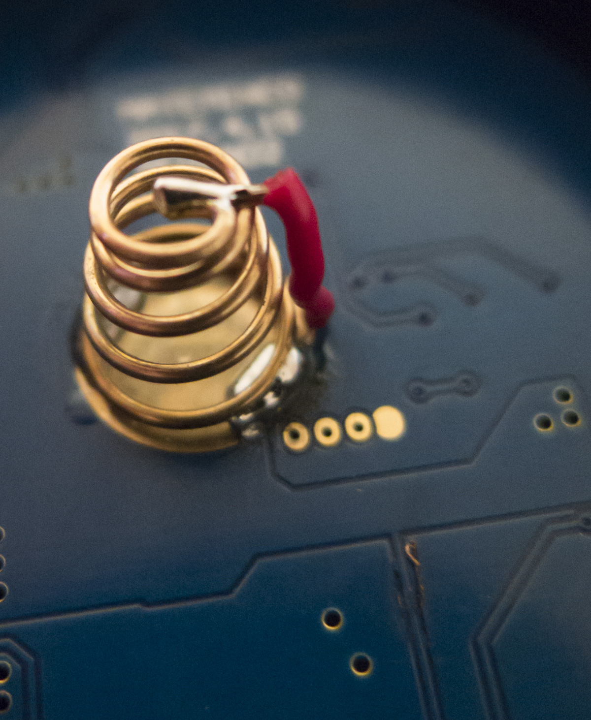

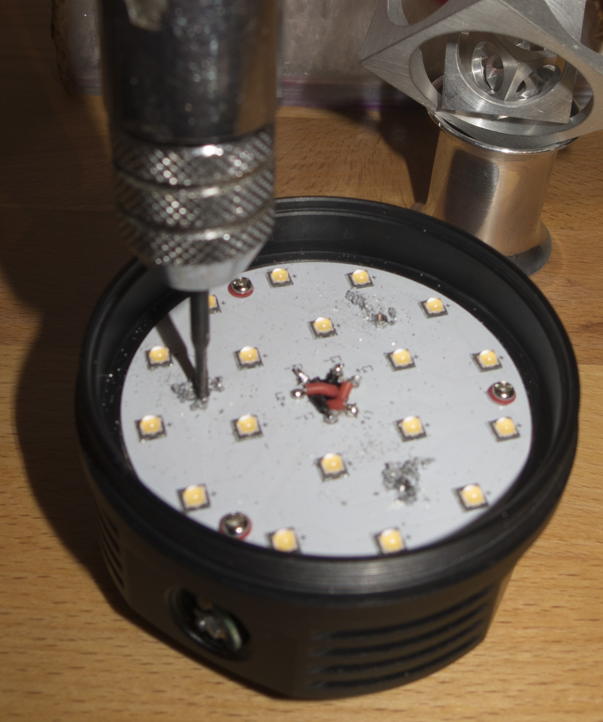

First thing was to bypass the copper alloy Spring on the driver
I sanded MCPCB to remove the solder residue and get a polished surface
Added a wire to the LED- to shelf, I could have increased the positive gauge, but I didn’t
You can also see that I cut threads in the TIR holes to screw down the MCPCB to spread the paste better, the 3 screws on the outer ring are nice but in the middle of the MCPCB they would be more effective

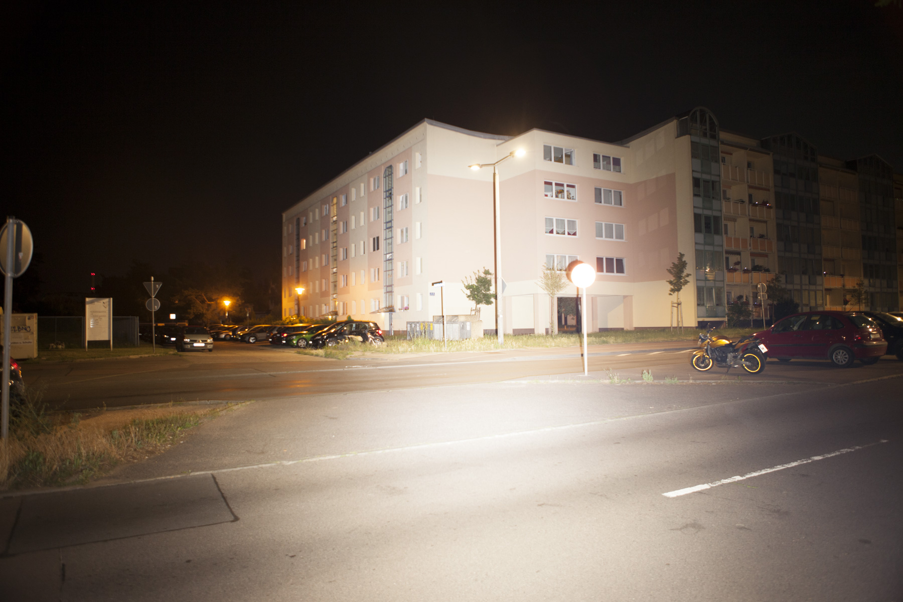

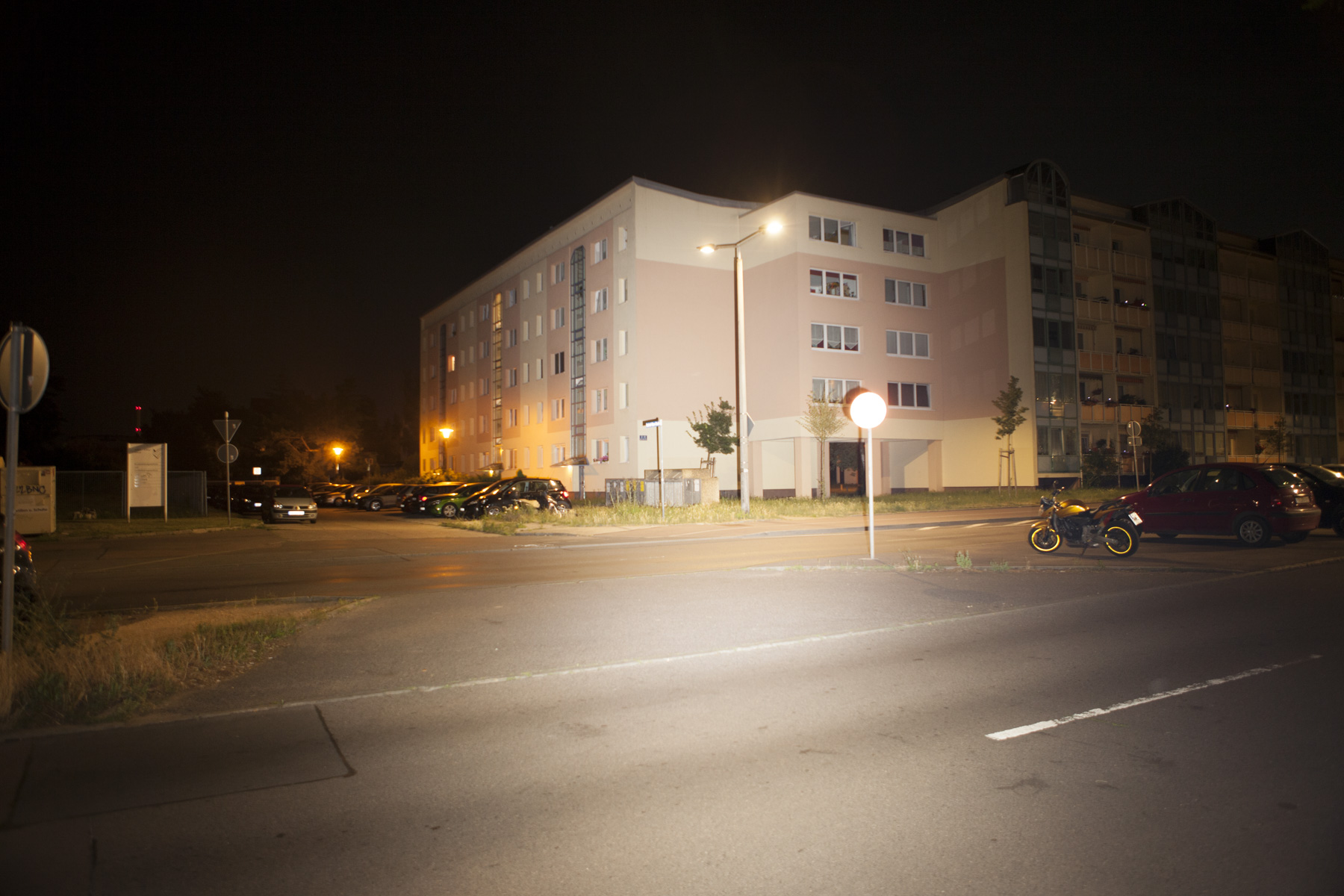

Beam shots
about 2m from Light to ceiling
Astrolux MF-01 Nichia 219C
Astrolux K01 XPL-HD 3D
Nitecore P12 XML U3-3D NW
