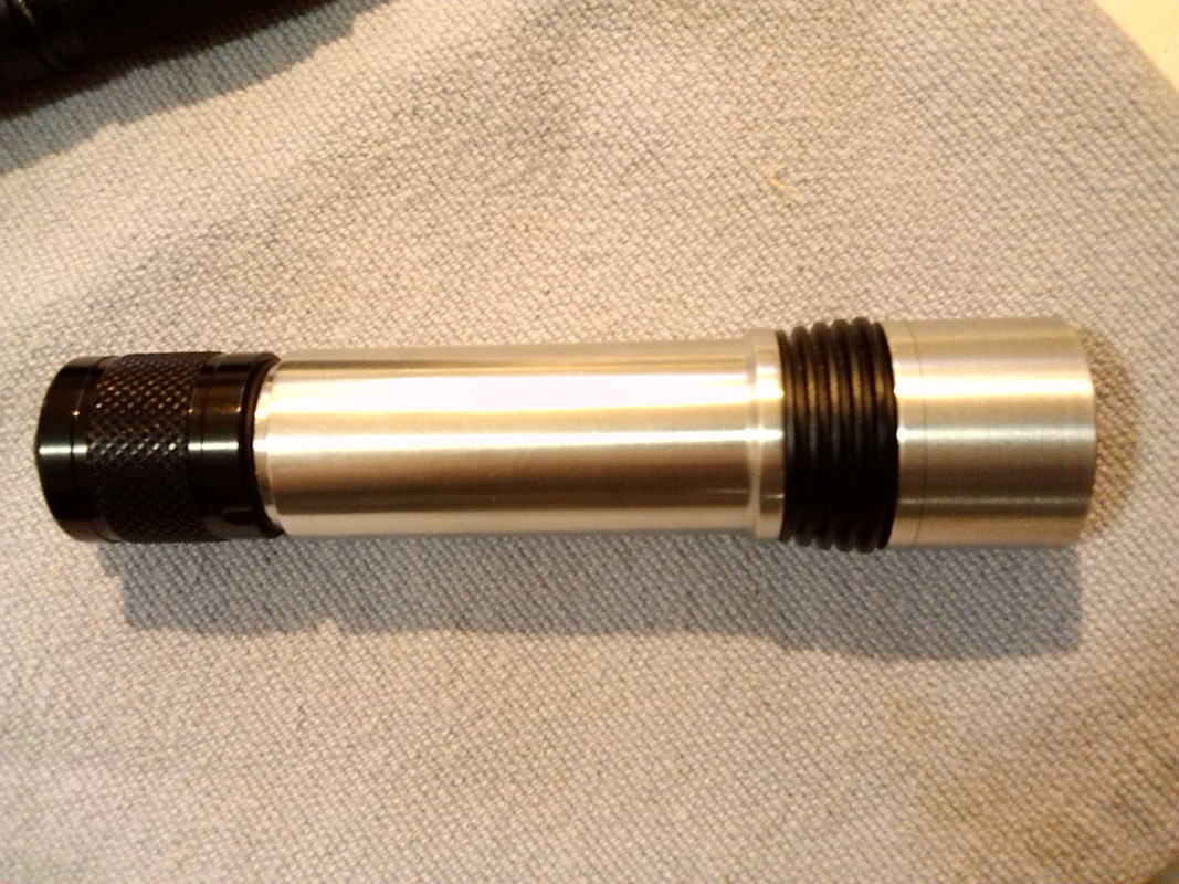

Thanks guys i made a little progress. I’ll probably start an acutal build thread but heres the first little protopart.
I have a few boards and drivers but i need to do alot more research on what people may be most interested in. This is fun stuff im pretty new to it all
Thanks i just love making stuff. Might make a few to sell but just trying to make my self one first. Once i have the design figured out im gonna move to titanium.
I might even dive into rolling my own driver too just for the fun of it. There already seems to be so many good ones out there tho.

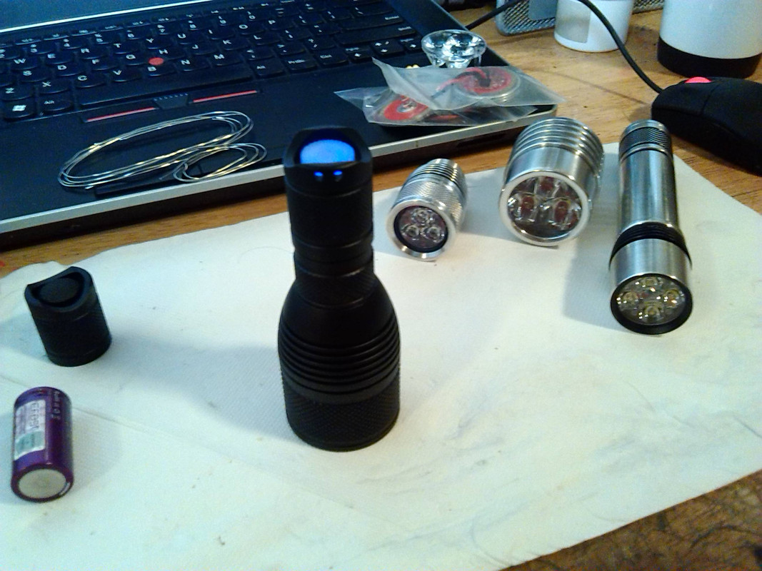

I’m just starting. I don’t have the equipment at home, so at work I have break time and lunch time to use the lathe, mill and other equipment. The lights on the right are modded X5/X6 with 7/8-20 threads that I can interchange with this simple battery tube, the bigger triple I made from scrap pieces.
There is some crazy talented master machinist in this community and I can’t wait to see what they and you come up with next!

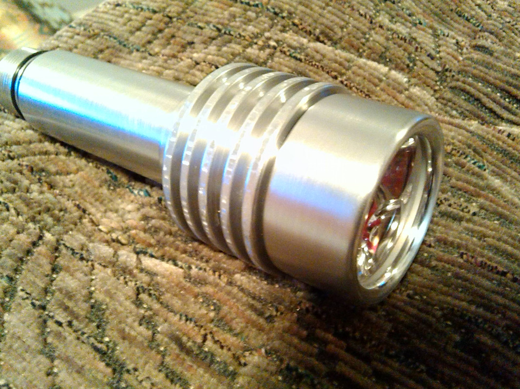

Ok It’s been quite a while but here is a big update on where I’m at. It’s coming along quite nicely i think. I settled on 7/8 –28 threads. They seem like agood balance between speed and feel. Im calling it the Citadel . Im also really toying with the idea of my own custom driver. I’ll have to get some other threads going there.
No question overkill And Ti isnt even really that good of a choice for a flashlight since it doesnt conduct heat very well. but its what the custom world wants so gotta deliver
