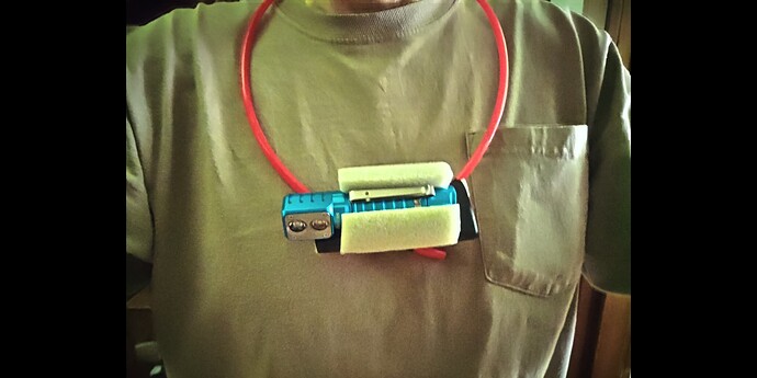

A headlight will work for most of those tasks. It is not always convenient to have the light on your head. Wearing various types of hats can be problematic. Something in the 18650 range with a wide smooth beam pattern and 3000k - 4000k to somewhat match normal indoor lighting and multiple low levels to choose from will last most individuals many days of use. If it has a magnetic base and can tail stand or lay down to aim the light wherever you want it ,it works much better. A few different armytek models would work good. The C2 pro nichia might be best. The Wurkkos hd15 with 4000k would work pretty good. That one is only available from wurkkos website or ali.
This is some 1/4 in OD polyethylene tubing and a piece of fairly stiff 1/2 in pipe insulation.

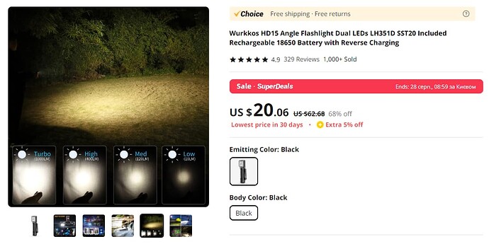

Just foud it today and already want to buy one. Looks pretty useful with two leds and adjustable size.
Is it good price?

Yes, 24$ is quite good price for HD15. Though I have seen it cheaper on AE. Personally I don’t find it ideal for Your purpose - because it’s quite heavy, even for a 18650 headlamp. Apart from that - it’s great. Thing is it will be hard to find something better - HD15 is the only one affordable 18650 headlamp, that has flood optics just out of the box. So maybe that’s is truly best You can get after all.

Just checked and I found it on AE for 20,69 USD. This deal is in “Super deals” section.
Yea, it’s my maint concern. But for occasional uses and as a normal hand held flashlight it looks great. For something lightweight I can buy some cheap plastic shit.
Strange… Looks like we have different prices. It’s my link:
I’ve seen it for ~17$ or so but it already sold out. Maybe I can wait for better deal, winter is still far away)
Yeah, if price is no object there are lighter, maybe “better” headlamps. But considering the situation the HD15, especially at the price, would be a good tool to have.

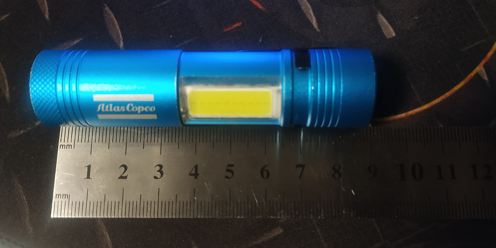

Wow. It’s even smaller than my current EDC noname flashlight
