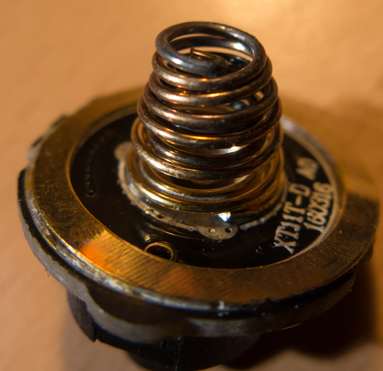

also with my dead XT11GT I could simply show a picture from the half molten springs, they even didnt ask for a video then
months later I got total of 3 dead XT11/12GT lights from german TLF guys which I repaired with Narsil and XPL HI NW one was fine without molten springs
one had a lot worse molten springs than the other even the plastic in the tail cap was half molten and the crispy smell of those light will be there even in 10 years
