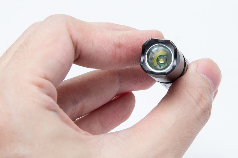

1) The “Attack Bezel” isn’t as big of an issue as it appears in the photos. It’s scalloped but the tips are blunt and don’t snag on the pocket.

The bezel isn’t too aggressive and I think fine as is.

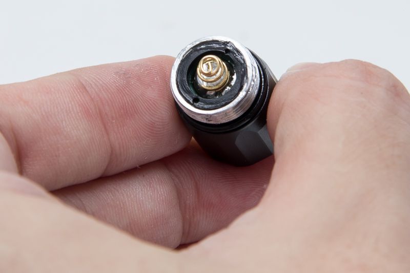

Big issue is the plastic retaining ring in the tail cap. Tried to get it out to look at and maybe replace my switch and I
couldn’t get it out and ended up chewing it all up trying. So not at all pleased with that!! Aluminum upgrade??

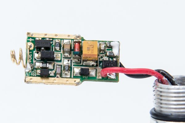

For the sake of science... I sacrificed my copy for teardown. Struggled for 45mins to teardown the head assembly due to loctite ... Simply no grip for the head. I have no choice but to go through brute force approach.
Cannot figure out how to remove the reflector and LED. I can see Fujik or white glue covered in the interior. I do not really recommended for mod unless you want going through the trouble.

Yeah. And? Did your engineer design that rectangular board with the black blobs on it?
Got a circuit diagram?
Why do people become engineers?
Someone here would probably be glad to suggest improvements to solve this problem.

As long as all of the components are rated at greater than 4V it should be fine, right? It might not have low voltage or reverse polarity protection but, so long as we put the battery in right and use protected cells, it should be ok. It might already have protection…that sure seems like a lot of components for a simple 1AAA light with 3 modes…
And is that a 14 pin IC next to the inductor??? I don’t believe I’ve actually seen a flashlight driver with something like that.
Hey freeme have you tried taking your trail cap apart? I just can’t get mine apart at all. Totally stripped it.

Looks good to me. Also, with 4.8 stars and 23 reviews it couldn’t be too terrible. The only obvious thing I see that I don’t like is the crenelations on the bezel.

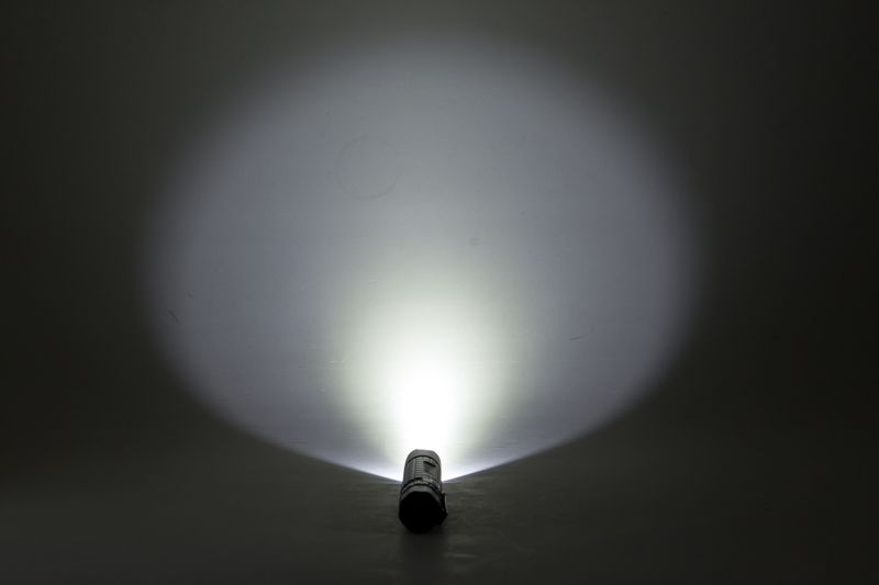

I am baking my light in the sun right now. Appiled some black metal paint to cover those ugly marks. LoL. I will try stripping the tailcap later. Beam shots were taken about 50 cm away from wall. I just wanted to show the color for the beam.
Edited: Do not bother, this light is not mend to be taken apart unless you want to break something (retaining ring is plastic). Almost pierce my finger with my sharp tweezers during the process.
I’m glad that I wasn’t the only one having an issue with the stupid plastic retaining ring! I have spare switches and I was going to replace this one since it is pretty crappy…but I can’t! Annoying!
Here are a couple pictures.
With the Hugsby XP-1
Tried to get a shot of both beams about 18 inches from the wall. Cell phone camera so they don’t show much. Hugsby is warmer and has an OP reflector so is a bit smoother but is a narrower spill.
Just the PF01. I tried to get all the various rings in…but again…cell phone camera. There is a square-ish centre LED portion, then a small gap, then another very white area. Then a slightly yellow ring, and then a big spill area.
Maybe my example just isn’t as nice as some…I’m not really liking the beam on this one. Freeme’s beam looks like it is nicer than the one I have.
I find that the Hugsby is a nicer beam.

I wish that it was a smoother beam…slight orange peel would improve it I think. At least the one I have could use it.
The parts of my beam that are white, I do like. I’m not sure why I have a yellowy area though. That part Im not as fond of!
