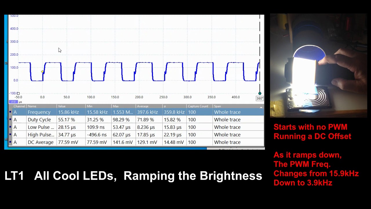

Here’s a video of the BLF LT1 lantern showing the various PWM and waveforms.
0.00: Middle Tint Setting, Ramping the Brightness. The PWM Duty Cycle reaches 54% Duty Cycle. On Low, the Frequency changes to 3.9kHz, with a very short Duty Cycle.
0.46: All cool LEDs only, Ramping the Brightness. Notice the light at full brightness has no PWM. It’s running a DC Offset. As the brightness decreases, the Duty Cycle lowers. The Frequency stays at 15.9kHz. At the lowest brightness, the PWM again drops to 3.9kHz.
1:40: A Middle Level Brightness setting, Ramping the Tint. Very unique PWM waveforms are created by the Duty Cycles of the 2 types of LEDs Interacting with each other.
2:15: Ramping both the Tint and Brightness.
I changed the time frame on the scope to zoom in on the waveforms. Starting at Warm, Low Brightness. Ramping to Full Brightness, Cool Tint.
Notice that at Full Brightness, the light is not running pure DC Offset.
There is still some Duty Cycle being seen from the LEDs.
I miss-spoke in the video. The full cool bright is a DC offset, but there is some artifact left from the way the Duty Cycles of the LEDs are interacting.
There are some really interesting waveforms being generated by the Duty Cycle of the warm and cool LEDs stacking on top of each other.
Taking a look at the ends of the tint ramp – The single square wave Duty Cycle, is (I assume) an indicator as to why some have reported that the light has the longest runtime when at those tint settings.

That was really cool Jeff, thanks for sharing.
Where was the scope probe connected, or how was that signal generated/captured?
