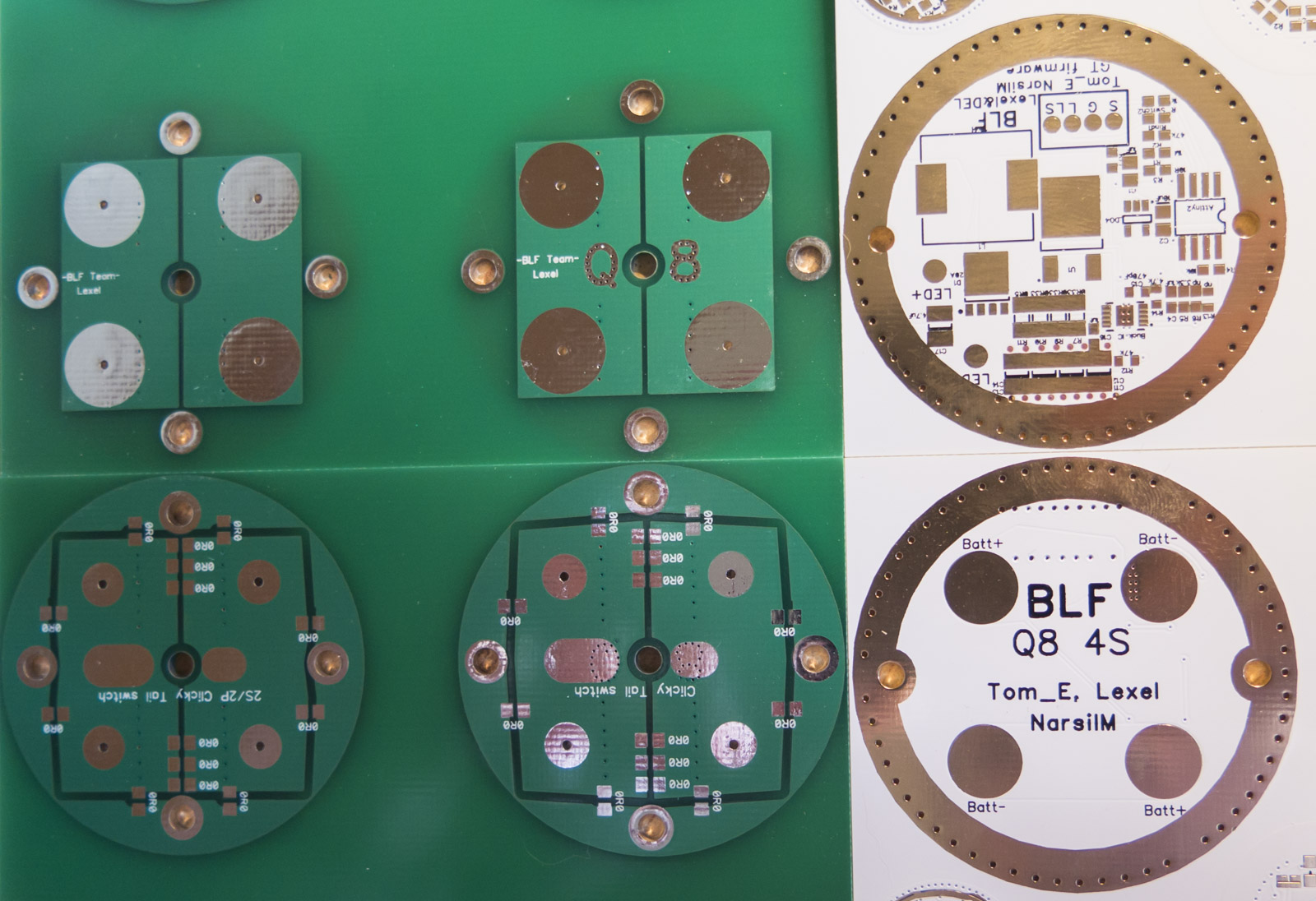

I got today some boards that are planned for Q8
2S/4S Buck driver up to 8A output 6-12V
18.5€
can be easily modded to 2S/2P with one cut and 2 bridges
Tail Boards 2/4S
those are dirt cheap, no ENIG
1$ for two just raw as they are on the board, cut out, sanded with a set of jumpers 3$ for 2
1.2$ shippingh up to 20g weight
2$ up to 50g

Do you mean the driver boards Lexel has shown in the post just above yours or the dual footprint Q8 boards? If it’s the latter, LED4Power has stepped up to make those and has them on his site for sale. If it’s the Lexel boards, I guess keep waiting for Lexel to answer.
The “other” thread about dual footprint Q8 boards.
LED4Power’s sale thread, where he mentions that the dual boards are on his site.
Thanks David. PRC8 it. ![]()
Led4power has cracked on.
Others have not. Despite a lot of talk.
I hope that the entrepreneur gets his reward, I will be buying one or two when available.
Yes, I hope lots of people do the same. led4power has been a member here for a long time and builds some very nice drivers, as well as other things now like this PCB for the Q8. He has gotten some negative comments in the past from some of the members because he chooses to sell his drivers instead of sharing the designs for free. I’m tired of people who demand everything be given to them. So I hope he succeeds in spite of them.

Like you can read in the first post:“This is a first check if enough people are interested in a Q8 Dual footprint, quad LED copper DTP LEDboard.”
And shortly after this had started i had personal issues that kept me busy and out of BLF for quite some time. When i came back LED4Power was already selling the boards in his shop for a very good price (https://led4power.com/product/l4p-blf-q8-40405050-38mm-dtp-direct-thermal-path-copper-mcpcb/).
Original the min order was 50pcs @8$/pcs =400$. So with the intend to make not a single cent profit, someone had to pay 400$ in advance (to get a 8$/pcs price). And i think you can imagine how many Boards you have to order to get a price of ~4$ (and how much money someone had to pay in advance).
Maybe you are able to spend 1000 bucks with the risc of not getting your money back. I am not! And also doing it with the intend of not making any profit (only the wish to give people the option to mod the Q8).
In the end i am happy with the result! Someone (LED4Power) took the risc. And now we are able to buy the board for a very good price. And i really hope he makes enough money on this! Because only then he might be willing to risc his money again if some similar project occurs.
