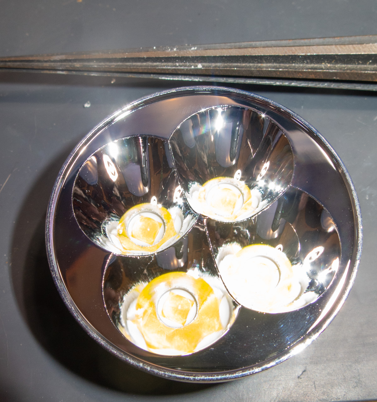

I used a champher bit to open the holes in the reflector a little at a time, until the champher angle captured the edge of the 4 LED pads to center the reflector…
I used the drill press to lock the depth so each of the 4 holes would be at the same depth… I have a small vacuum that I hook up when enlarging reflector holes. suck up the chips dust and debris while machining…

I had to bore out the reflector holes using a countersink drill bit. Easy enough as the reflector is made of metal. I also had to enlarge the central hole in the new MCPCB so that the bolt fitted through into the reflector. The rest is just soldering ![]()
