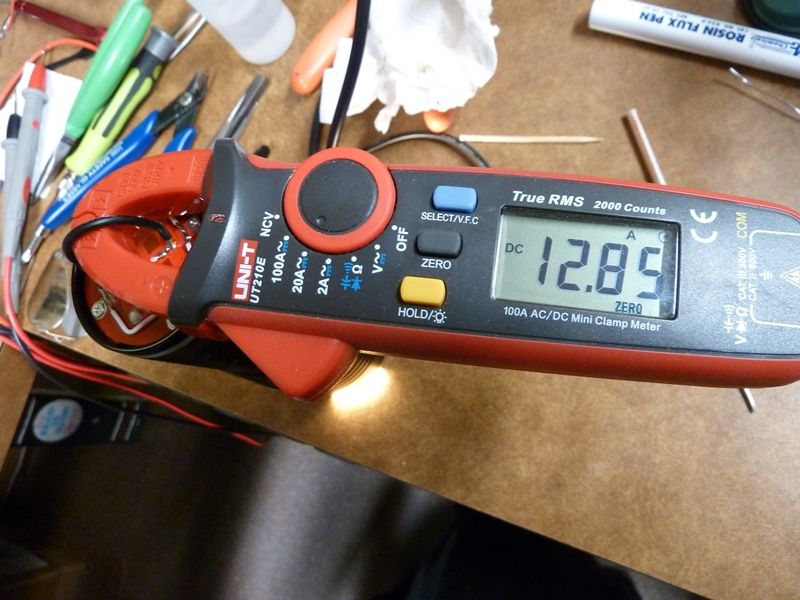

Here it is . One VTC6 cell, rested at 4.21v. Did little better than I thought. My guess was 12A:
It started just over 13A and by the time I could click, even though I had the camera all set up, it dropped. It was dropping pretty fast.
Wow Tom, i’m actually kinda giddy. :smiley: That looks like its a pretty good reading and you pretty much had it spot on on your guess. If you are not super busy would it be too much to ask of you to test a Sanyo GA and see how it does? :slight_smile: I cant believe i’m actually more than happy about a flashlight and a battery. :open_mouth: Wait wait, no don’t do it, forgot GA was only rated for 10 don’t want to damage your cells.

Well the GA has a higher internal resistance so chances are it will be below 10A, guessing 8-9A. I'm overdue though for a beer, so, there are priorities...

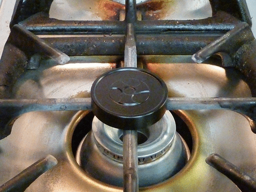

Here's a time lapse sequence of color tinting the tailcap of the ThorFire Q8 prototype. The Miller suggested this a while back, finally got around to doing it. Pictures are taken every 30 secs, so it's 3 1/2 minutes shown, the gas flame was maybe low-med. It turned pretty quick, probably too quickly. I left it on for a total of 7 minutes but the color was unchanged from 3 1/2 minutes:

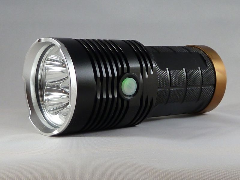

This is what it looks like assembled:
There's one spot on the edge shown better in the last picture where the finish didn't come out consistent. Not sure why, if it was in the original anodizing and just heated too much. It is a prototype, so the finish might not have been done as a true manufacturing process.
The color I'd describe as a dark gold, almost brown but I wouldn't call it a brown. The finish is almost tacky, more grippy than the original by far. A gold 12X SRK I have is much lighter, brighter. This 12X SRK is a "new" style getting more common in the cheap clones. I like the look, but seems very close in design to our ThorFire Q8 version. This 12X came with a lanyard, but has no place to attach it. Not sure if it's a problem, but our Q8 has the same limitation, but with the threaded tripod mount, a threaded piece could be made for fitting a lanyard.
The color looks great, would be nice to mix and match different sections.

Nice picks. Too chicken to do the whole thing?

I'll let The Miller chime in on that. I don't feel I own this proto, I'm just the holder of it. This is the first time I ever attempted tinting anodized components.
I like the looks with just the tailcap coloured! :slight_smile:
