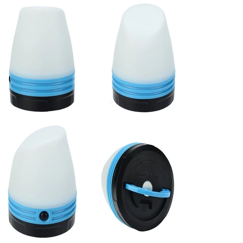

Basically it’s single function lantern that works on 3xAA cells. Advertised brightness of 40 lumens with a 60 hour runtime. Weight and Dimension according to the website is 152 gram and H 8.1cm x D 8.1cm.
The translucent diffuser seems to be a very good quality material since it’s neither too opaque nor too transparent. Just perfect . Also the build quality of the diffuser is very sturdy.
I did not like the shape but it’s ok I guess because sometimes we need a change from all those generic ones out there. It’s a single piece cup so water splashes from the top side would pose no immediate threat. Button is on the side and has a good clicky feel.
Unscrew the base and the battery bay is revealed. 3xAA batteries go in there and is not too tight or too loose. Perfect fit. Connectors are of clip type and not spring type.
The carabiner hook can be folded and the unit can stand on the table. There is a snap action to this movement so it wont jump out unnecessarily when not expecting.
However the hinges for the carabiner hook is of plastic and I don’t think it can withstand any punishment. The bottom also has some cool patterns but it’s just for visual and does not help in improving grip or friction.
