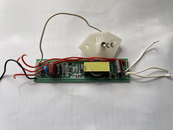

That thought encouraged me to take it one step farther and open it up.
The LED strips surprisingly have some thermal compound on the back contacting the heatsink, which is fairly substantial. Adequate? Don’t know.
This is what it looks like inside. No obvious fried components.
Don’t have a clue where to find a suitable driver, or if it’s worth it.
Check/Replace the electrolytics. If they’re cooking, they probably boiled out all their yummy juices, and whatever current they should be smoothing, is probably all bumpy and ripply, making everything else go mental.
Replacing those would be my first guess as well.
Best to put in some 105° ones or even more, they will need it…
Capacitors, Right?
I have 2:
-large brown one - 50v/220 microfarad . Now that I look closely with a magnifier to read it I see that the top is bulged slightly. Ah, ha?
Small brown one 50v/10 microfarad - I looks fine to inspection.
The large brown “loaf” says 224J/630V
The small blue “fat lentil” reads (maybe) DNR/7D471/(last line is messed up).
I know capacitors a bit and have replaced them successfully on motherboards and monitor screens, but only by using designated kits. I have no idea how to deal with replacements outside exact replacements. Does more or less matter?
The other 2 gizmos I know nothing about.
Maybe the blue one is a compact or ceramic capacitor? Looks fine. Do they go bad? How do you tell?
The food products should be fine. The bulgy one gots ta go, but the other one, too, just to be complete.
Thanks. Ordered a new bulb, but it’s gotta come from China so taking awhile. I bought the proper caps, put them in yesterday, and the light works again. Very satisfying.
