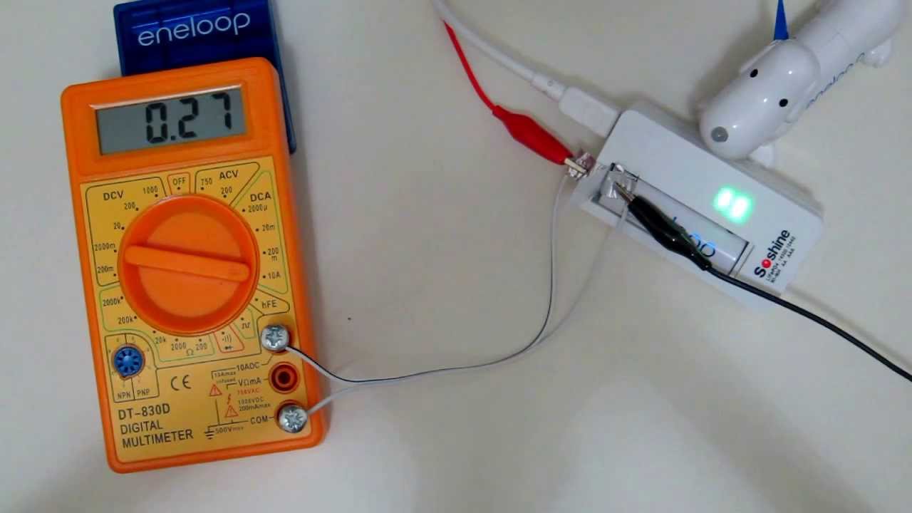

Operation
User interface is pretty straightforward and explained on the box, however, some explanation is needed for the animated sequence as this can be confused for charging progress.
A red LED lights when power is connected with no cell inserted. On inserting a cell, the LED array lights green in animated fashion for thirty seconds as the charger provides a lower ~300mA charge. After this period the current will rise. If there is a problem it will stop charging at this point. A single LED flashes green/red if there is a fault.
During charge the LEDs light according to progress/capacity. When a cell is fully charged all five LEDs stay lit.
