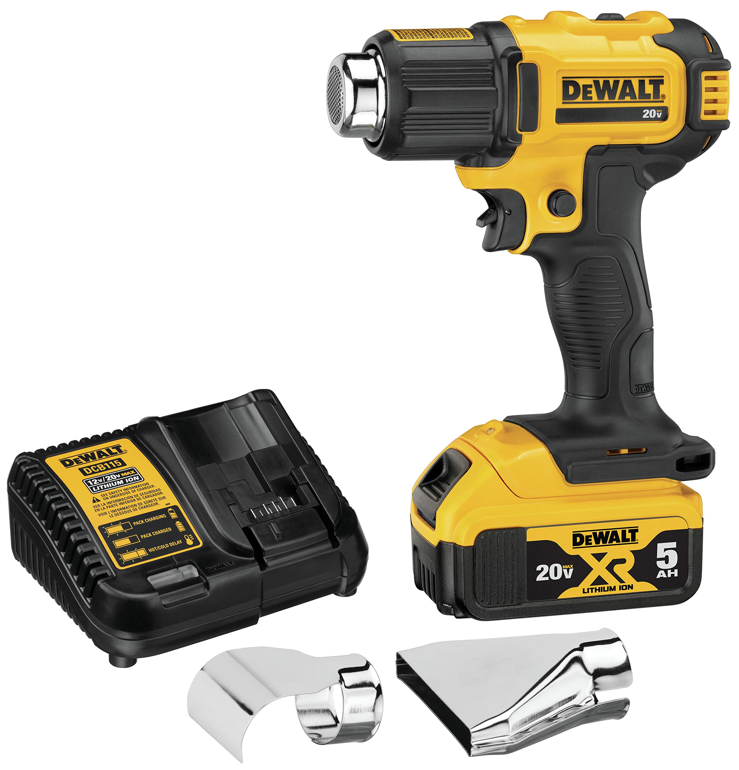

If you got a heatgun, the shroud-thingy that looks like the business end of a backscratcher, lets you heat all sides uniformly at the same time.
Amazon got heatguns for 20bux and up. Got a Neusomething for that much courtesy of vipon, but there’s a Pruelde or whatnot that I just saw.
Eg,

Heat guns are the best for battery wraps, but come in handy for a variety of things.

If you don’t have a heat gun bushmaster, I highly recommend getting one. I use mine mostly for heat shrink tubing, but it also has other uses. Much more intense heat than a hair dryer. I got mine at Harbor Freight for pretty cheap.
I do not have a heat gun. Guess I should look into shopping for one, huh?
