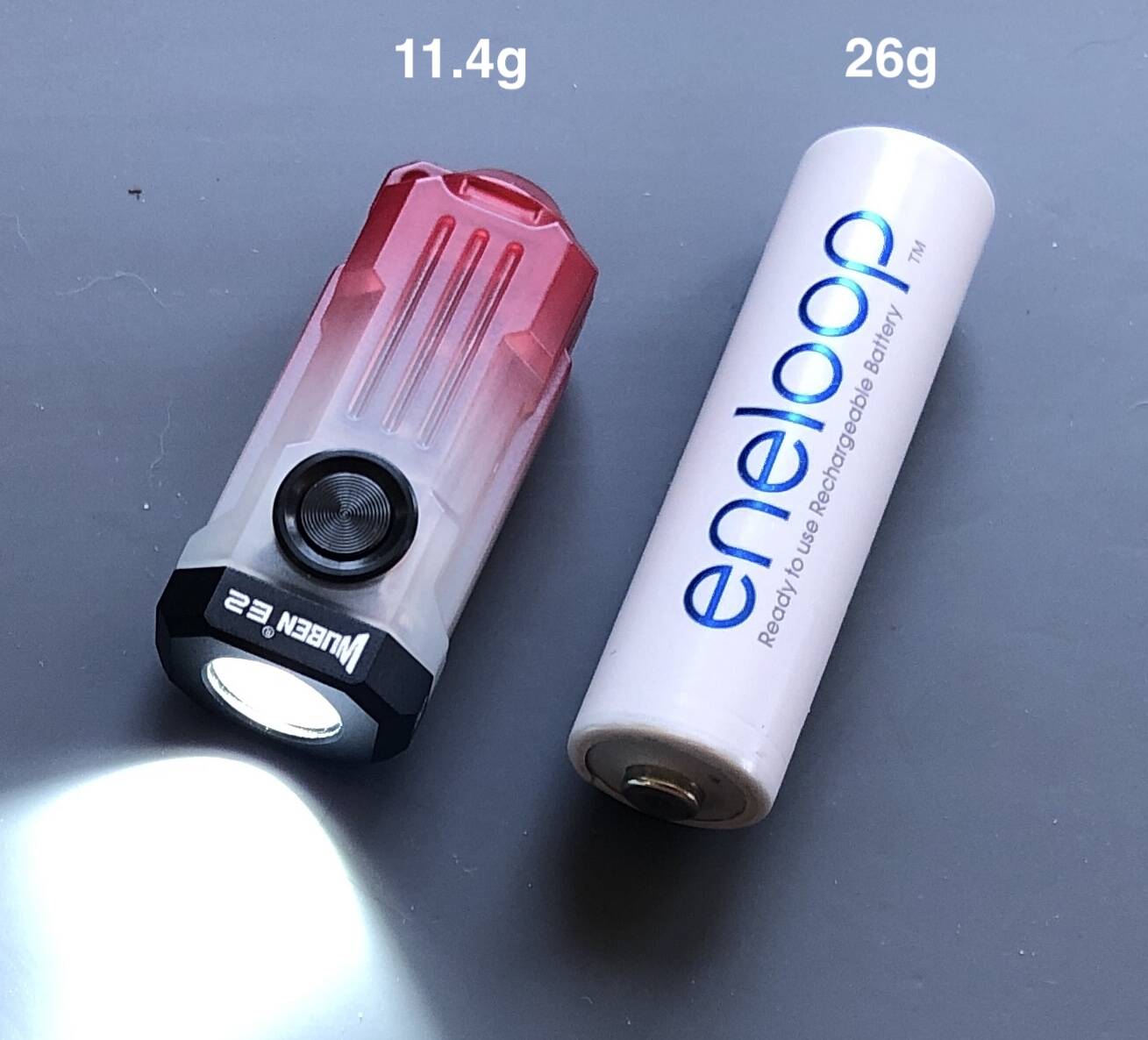

First impression when I opened the box.. Wow, thats tiny! :wink:
It weighs less than half an AA Eneloop.

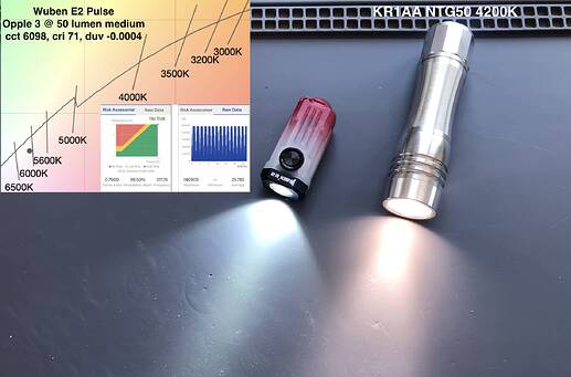

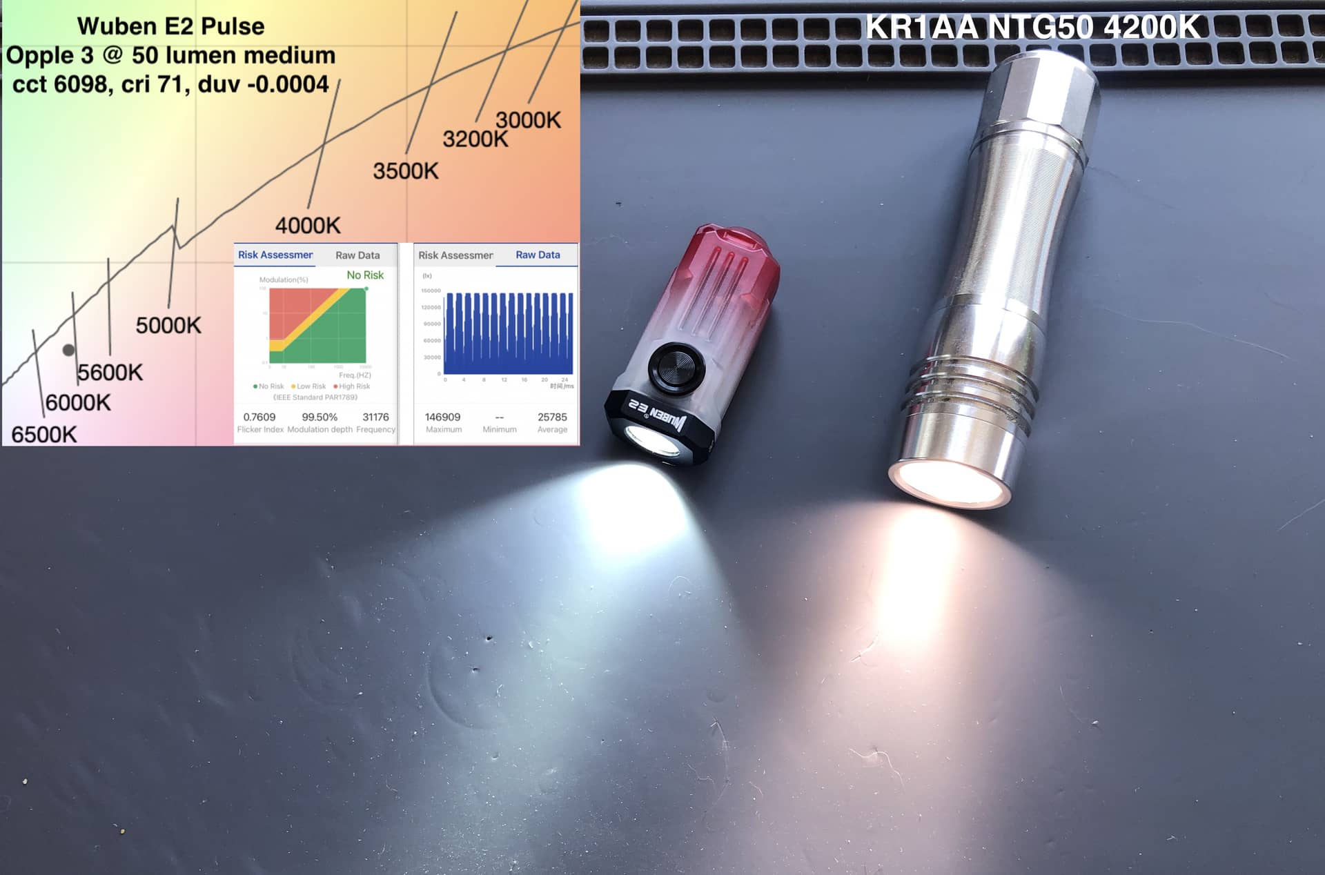

The front Low CRI LED outputs seem to match specs of 5 lm, 50 lm, and 150 lm.

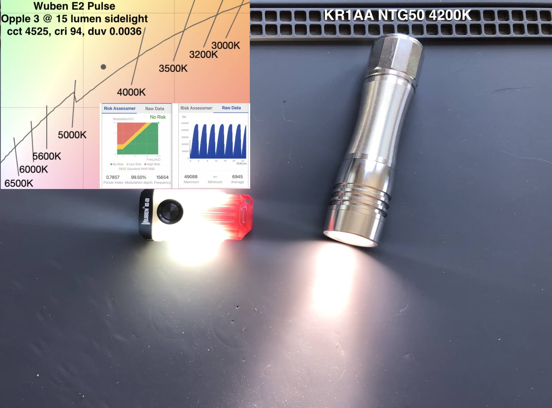

The High CRI white sidelights (on my meter) measure 2.5 lm and 15 lm, per side.
Here are some Opple measurements:
