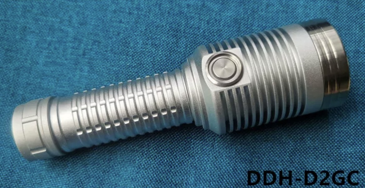

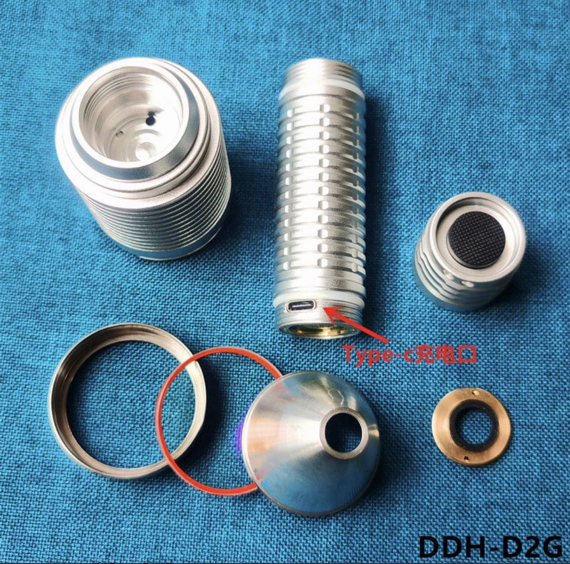

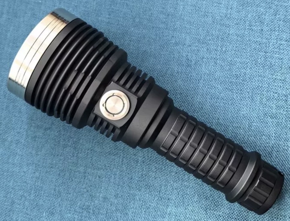

The DDH-D2GC is a nice eswitch host that takes a 22mm driver.
It uses a 21700 battery and a C8/M21A reflector.
You’ll probably have to modify(thin out) the driver retaining ring, it’s sorta overkill.
Black is OOS right now.

Interesting. How in the world did you find that monster? I may actually try it. I have 3 drivers and overkill sounds tempting.
@Karinaaa told me about DDH and I had to order a couple.
I haven’t assembled mine yet but it looks nice:

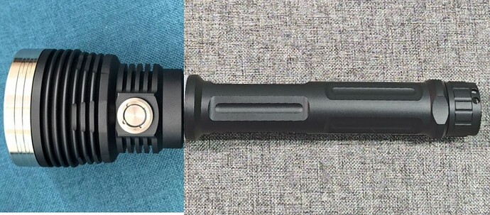

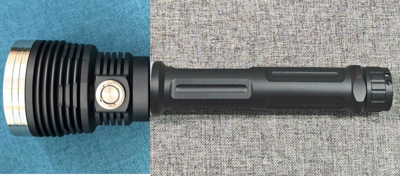

I have a M4B and a dual 21700 battery tube for it on the way for a 6v SFP55 build:
What is the black host?
DDH-M4B it uses a 32mm driver and MCPCB:

I ordered a dual 21700 battery tube for mine.
So it’ll look more like this:

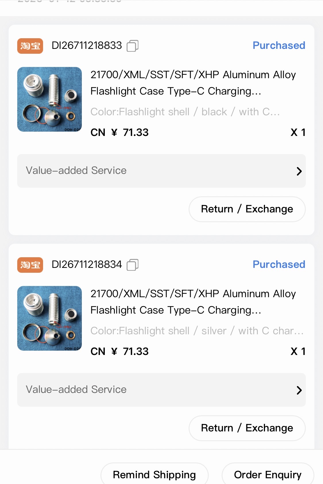

Well I ordered a silver and black one. The first you linked. Website a little sketchy but only $25.

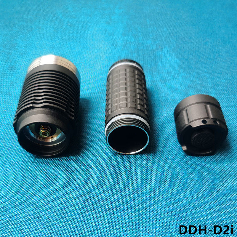

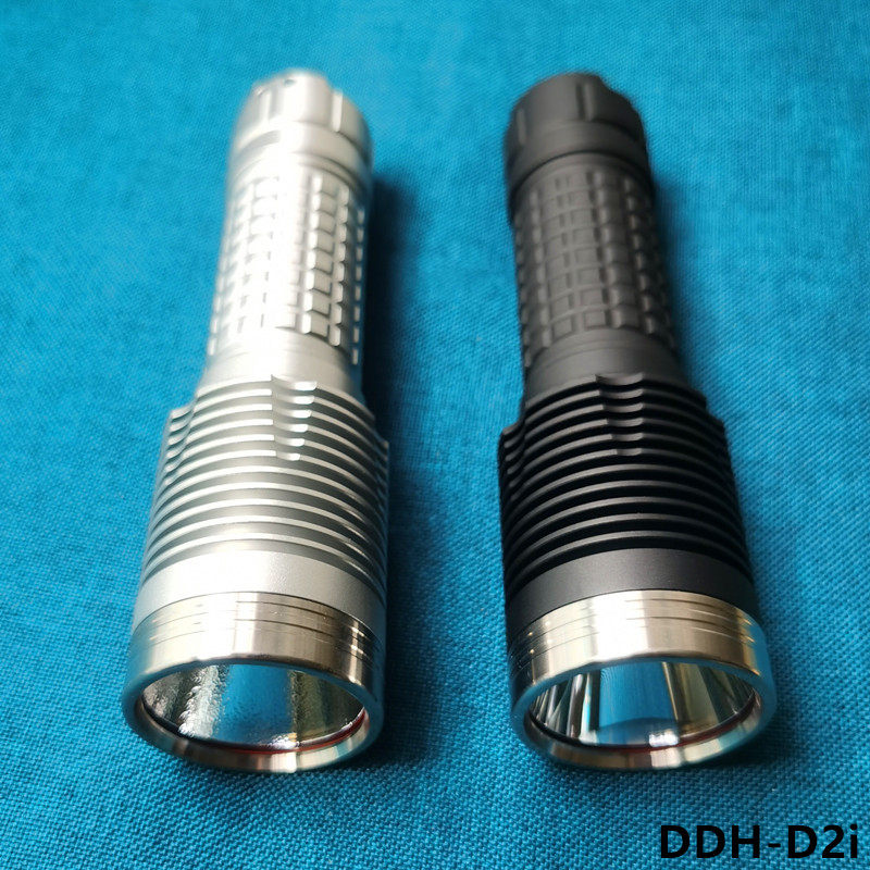

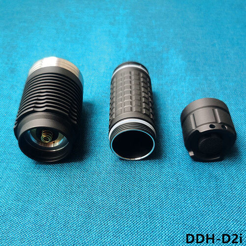

I like the looks of this one. 22mm driver? DDH-D2i
That’s a mechanical switch host.
For Lume you need an eswitch host
Ah I didn’t even realize. Good eye.

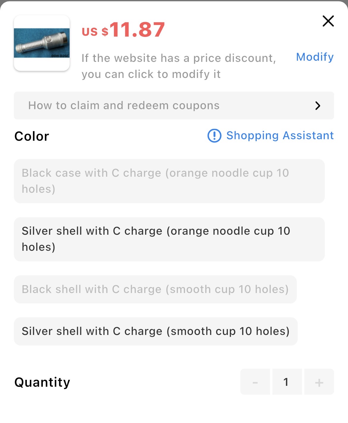

The Black is OOS:

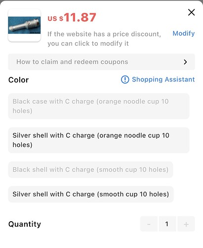

When I added it to my cart it had an option.
That includes shipping to the SuperBuy Warehouse in China.
International shipping for 2 hosts will likely be another $20-$25.
You are actually buying the hosts from TaoBao which only ships within China .
SuperBuy is a forwarder.
  1. If it makes it to the warehouse Let Me Know!
  2. If it’s not in stock like I think it is, SuperBuy will give you a credit.

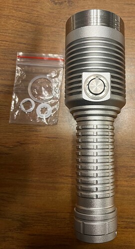

Ah I may have made a mistake. DDH-D2G is what I got. Not the “C”
Cancel the order and order the C
