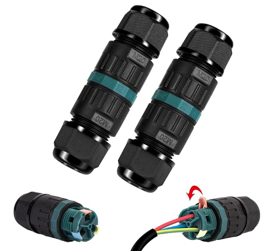

Suitable or not?https://www.amazon.com/NAOEVO-Waterproof-Automotive-Electrical-Connectors/dp/B0BB7G6HR7/ref=mp_s_a_1_2_sspa?dib=eyJ2IjoiMSJ9.jbfqC9Es09mXnVJkqGauygJZsfuDcVRFJqbRjJEWwmT4SReztW19SKJxnPvxLdPKtrCopuRf3p9zQkBXNF3wQslDqFOpeYRk6Afn-C2Tlbe_hyoIjhn8cpLEjknrO2tPjvHAF2oUWDFg84XLCI4b9bPBnyjFjNm7s1HaBSexFGdoWfZV2RGBJZD2aLi07vVnGHZqD-51NbXEJOp2i3RSYw.3xAHahyCmV5RyEVhiHlt7890RRp58H-MQqp9lQKRTK4&dib_tag=se&keywords=3%2Bpin%2Bwaterproof%2Bconnector&qid=1717883711&sr=8-2-spons&sp_csd=d2lkZ2V0TmFtZT1zcF9waG9uZV9zZWFyY2hfYXRm&psc=1&th=1
I found this in amazon
using clamp, however it doesnt show for how deep could it be used. Some similar product (using screws) mentioned about 5m deep. IP68 only.

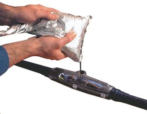

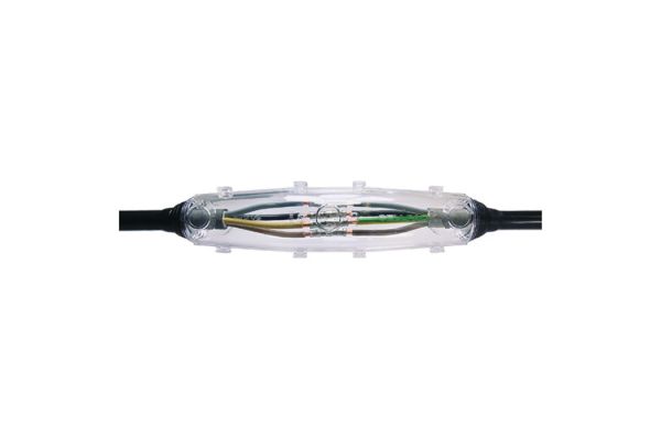

I am not sure what the exact requirement is, but if you want really water proof, then go for Cellpack. These connect the wires in a simple plastic housing which after connecting is being filled with some water proof resin:
IMG_5539
IMG_5541
Not suitable for a bike headlamp use case I would say. This is really professionally stuff, for any serious under water application, and so on.

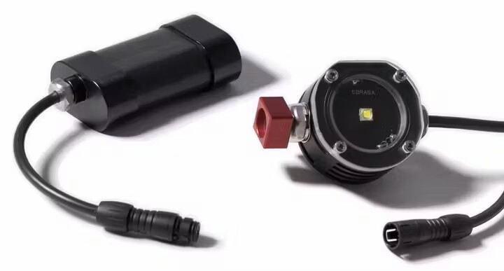

It appears the vast majority (all?) of caving lights have the connector inside the waterproof battery housing.
Cable glands seal the light to the battery box, with a continuous length of cable.
Perhaps it’s easier to copy this design than reinvent the wheel?
Edit to add: they’re not cave rated but Lupine lights are pretty serious bits of kit and appear to just use push connectors.
Perhaps similar and a dollop of dielectric grease would do?

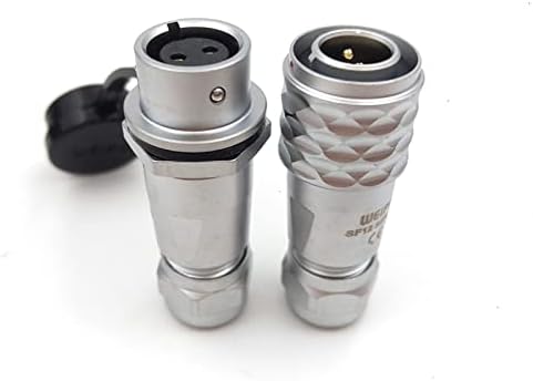

I like using those. Filter for IP68.
Can buy on Aliexpress, among others: 1.95€ 20% OFF|Weipu sp11 Stecker Buchse Buchse 2 polig 3 polig 4 polig 5 polig elektronischer Kabel adapter wasserdicht ip68 DC Wechselstrom kabel Kabelst ecker| | - AliExpress
I have not ordered from this store yet, random Aliexpress link.
+1 for Weipu, I like the snap-fit Mx style and the knockoff Lemo style.
Newark / DigiKey / Mouser
RS-online sells Weipu stuff rebranded to RS-pro, also a good way to get single digit amounts
Amazon sells the WEIPU connectors too.
All the Best, Jeff
WEIPU at Amazon
