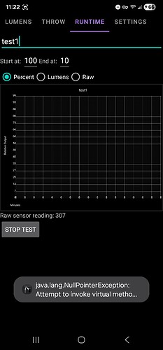

A commenter elsewhere is getting crashes on starting a runtime test. If anybody who knows what adb logcat is for experiences that, I’d appreciate a stacktrace as I’ve been unable to reproduce.
it might require permissions to access storage? mine crashes on the runtime test as well. 1 sec, lemme disable some stuff
**“ceiling bounce closed because this app has a bug”.
I tried disabling Samsung’s autoblocker, no good, lol.
***Just thought of something, @zak.wilson
Is it possible that the app doesn’t automagically populate the extension type, leading to an error when writing?
I thought maybe at least there would be a corrupted file or something in the directory I wanted them saved to, but the folder was empty

It gets permission when you pick the storage directory. It should detect when something has gone wrong with that and show a popup message, and I’ve tested that by putting a debug build into invalid states like using a directory the user didn’t actually select.
File extensions are optional on Android and not the standard way that it gets file type information, but it definitely gives the files it writes extensions (.csv and .png).
I think it’s more likely to fail to write at all than to write a corrupt or incomplete file.

I’ve the same issue with storage, but in my case it crashes when I try to select directory in settings. Permission to local storage is granted.
When error appeared I click “send” so maybe Zak will receive some logs - I don’t know really how it works :wink:

I did a thing, I manually created a new folder in that directory through the CB app rather than allowing “loose” files to populate in the selected directory.
Looks like there’s some correlation there?
**it’s working as intended now.
I have tested selecting a pre-existing directory created by another app and did not get a crash that way on either device I’ve been testing on.
let me do a reinstall after deleting any associated folders…BRB
Initially, it worked for one or two tests with the above message, but then subsequent tests crash the program. I went ahead and cleared the cache for that program, and was able to consistently run 10+ tests.
I closed out of the program, then relaunched it, same issue with crashing. I went and re-established the directory to allow permissions again, and it works fine again. **I did this multiple times to be sure
Maybe the “resource saving” or “security” features on android, such as “revoke permissions when not in use” are interfering with persistent access permissions of the app?
**BRB again, I’m going to test allowing it to have permissions exceptions
***so I’m back, Allowing memory residence and exclusion from permission revoke does not work, but reselecting the particular storage directory to allow access fixes it, but pops up that java.lang.null warning
