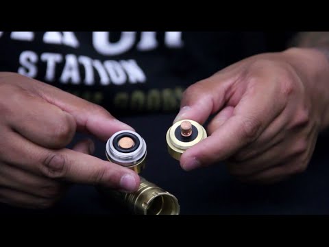

No, there are some greases that help, i know it from Mechanical Mods with 100% Mechanical Switches … ! And also check out the threads on the Mechanical Mods, they are very thin and precise, the current can pass through the “gap” very easily, and they have the arc phenomenon at very minimum level, because of the arc phenomenon there is the black-ish dirt in the threads after quite some time of use… !
Somewhere at 2:20 timestamp…
